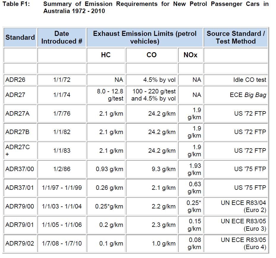

This might help
http://www.fastlane.com.au/forums/topic ... C_ID=11706
Or this
Well with ADR 27 and 27A are the ones that effect the 70's cars the most.
The most basic summary is that 27 is crankcase ventilation and PCV , so no open oil filler and a PCV valve to draw vapours back into the engine
Also a charcoal canister is required to take on carby fuel vapours ( often a small hose near float )
27A on 1/6/76 goes a lot further, all gas tanks are sealed ( note some makers sealed them with 27 in anticipation ), and there are several temp sender with vacum hoses, mainly carby are full of emmision hoses and dizzy wont get vac advance till top gear and at over a certain temperature
From late HQ onwards they had the canister (27), but from mid '76 (27A) was when they choked the motors to death.
Or this
