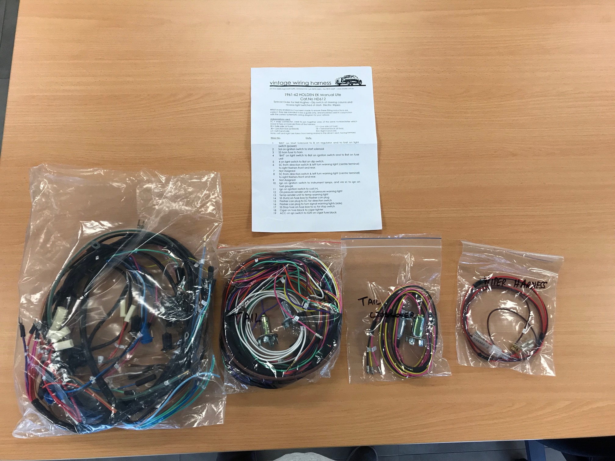

Re: Wiring harness
Hi Clay;
I bought one of their harnesses and had them include wiring for blinkers and reverse lights there really isn't any difference between the sedan and Ute harnesses that I can see except for what I just mentioned mind you I ended up removing and adding what I did and didn't need (bloody modifiers)
I thought it was a pretty good harness came as you see in the photos
