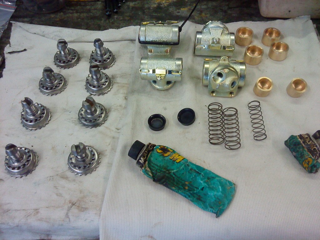

I'm just wondering what you used as an assembly lubricant for your brake parts when using silicon brake fluid.
I'm going down the path of using silicone brake fluid and have/am replacing all my brake components for new/rebuilt items including all pipe and hose work. I have done a fair amount of research and have found that GRR rubber grease is not compatible for use with DOT 5 fluids. I looked at using DowCorning Molykote 55M silicon Oring grease, but this stuff by design swells Orings for better sealing which would not be good for Wheel cylinder cups. It also isnt compatible with SBR type rubbers.
I have had all my cylinders SS sleeved and have had bronze pistons made up.
My two motivations for going this way is I'm trying to prevent the pistons for corroding and seizing as the originals did (alloy and steel), and I dont want the drama of any possible leaks ruining paintwork, as would be the case if I used normal brake fluid.
My next question is to the brake cup manufacturers to find out what composition they are made up of, SBR, EP, Neoprene, etc. Most over the counter sales persons at ABS and alike just give me a stupid look when I ask. :shock:

I'm trying to find a suitable assembly lubricant to coat my wheel cylinder pistons and cups that is compatible with silicon brake fluid.

They cost me about $60 ea which included new cups. This was cheaper than buying new cylinders which average around $80 ea.
The bronze pistons were an extra cost to get made up.

I did not use any pre-assembly lube for my installation. I simply wiped some Dot 5 onto eveything which I had dismantled.
Anything which was new was disassembled and wiped clean then dipped/wiped with Dot 5 and assembled - I have not had one issue with using this fluid.... apart from the expense AND the necessity to care spare fluid at all times.... you CAN NOT mix normal brake fluid with this stuff, it will destroy all rubbers very quickly and render your braking/clutch system inoperative.
