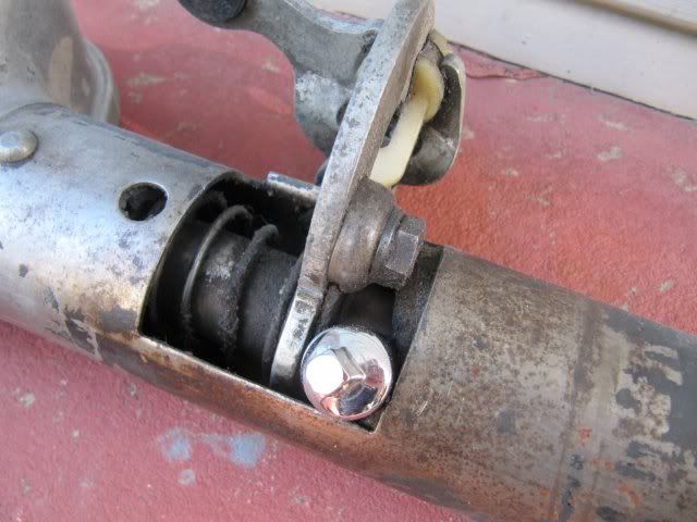

How do I get both nylon trunnions in place into the selector lever?
Also I've removed one of the old insulators from the selector lever. It had a steel 'washer' inside the rubber. How do I get this steel 'washer' inside the new rubber without drilling the rubber out? The inside diameter is completely different. See second pic.

The original trunnions had a little "bridge" that kept the two halves together, and made it a lot less fiddly to install.
The new repro ones don't have this, and are painful to put in.
From memory, I found the easiest was to leave the lever attached to the steering column selector tube, and let the other lever hang off the linkage. Fit the trunnion, then swing the second lever up.
The Rares bushing kit doesn't fit too well, and from memory there is not enough meat in the bushing to get the metal insert in even after drilling. I fitted without the insert - there is not a massive amount of load on it, and they are not too hard to changeout if they get sloppy in the future.

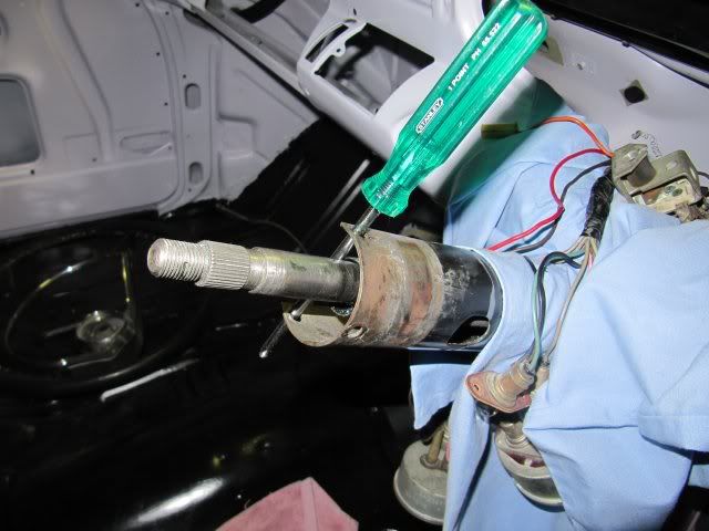

Then I wedged a socket in place to push back the spring and unscrewed the bolt to release the first lever. Note it has a small ‘pin’ that helps locate the lever in place. Also the bolt has a special washer that only fits one way.
Then I unscrewed the second lever. I had my ‘new parts’ which I gave a quick clean up.
Because I was working alone I pushed the column spring down and used a screwdriver to get some release from the column spring.
Then I did the reverse of the above and screwed the first lever back on. I used the socket to get some room and fitted up the second lever and screwed the bolt back on. It is possible to do this with the steering column in the car but it would be much easier doing this job on the bench.
