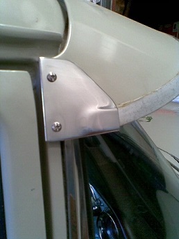

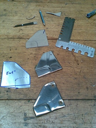

Been a bit slack in the shed department but a couple weeks off work allowed some shed time. The outer sun visor brackets that came with the car which appear to have been made from a genuine coke can have been annoying me so I thought I would have a go at making some. Fortunately I had an original pair of brackets on Dad's FB to use as a sample. The original ones are 0.5mm stainless steel. Since the brackets are just decorative I decided to make the replacements from 0.8mm aluminium.
A bit of wet & dry paper, Brasso/steel wool and then Autosol gave a reasonable finish in the end. The only problem now it has made the aluminium edge of the visor look rather tatty. Might have to give that a hit? Hope to get the car down to Glenelg for the All Holden Day.
The Coke can brackets
Original stainless steel bracket at the bottom and my aluminium version above.
The end result
The end result
