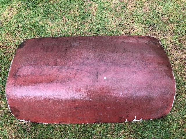

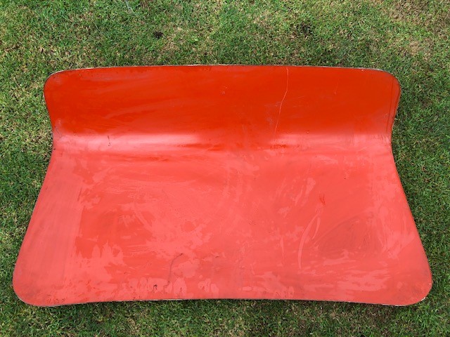

I dropped around to Rod Andrew's Race Cars last week, and bought the fibreglass moulds that he had. I now have:
a) left and right front guards. These are a two piece mould to allow the guard leading face to come out once cured.
b) bonnet (mould for outer skin only)
c) boot lid (mould for outer skin only).
d) left and right front doors. These are a two piece mould to allow both the inner and the outer door to be produced.
Rod also had the front and rear bumper moulds (cast as one piece with overriders) but is still trying to locate them. Rod used them to make panels for this beastie: http://www.andrewsracecars.com.au/gallery46.html. The moulds have only had two sets of panels cast in them.
No immediate plans to cast panels, but may end up doing some in the future for the meth monster project. If anyone has a desire to get some panels cast out of the moulds, let me know.

Starting to get a bit more serious on the meth monster project. Aiming to run glass panels where I can.
Overkill? Yep. But I'm in this project to have some fun and learn, not have the worlds fastest or most cost effective car (a Chev implant would have made that somewhat easier :P ).
NSW light vehicle modification guidelines are pretty similar to NCOP. In a nutshell, I am allowed to replace original bolt-on mudguards, bonnet, or boot lid with identical fibreglass panels, but would need engineering approval to replace body panels where the original panels were welded on or where
structural integrity is affected.
Hmmm..... Houston, we have a problem. I've got moulds for bonnet, boot and guards which are OK. But I'm keen to use the fibreglass door moulds too. They aren't welded on, but might be considered part of the structural integrity. The engineer was a bit hesitant on approving them, so ideally need a non-engineered way of using them.
A quick call to the RMS Technical Department says that the only reason the doors would be considered structural is if they had to comply with anti-intrusion ADRs. They looked it up while we were talking, and ADR29 for Side Door Strength came into force from January 1st 1977. Given the vehicle predates this, it is acceptable to use fibreglass doors. Sometimes I win :mrgreen:
Have made some enquiries, and asked for a quote from the local fibreglass mob (Custom Fibreglassing at Guildford) to lay a set of panels up. Will post up here as I progress along.

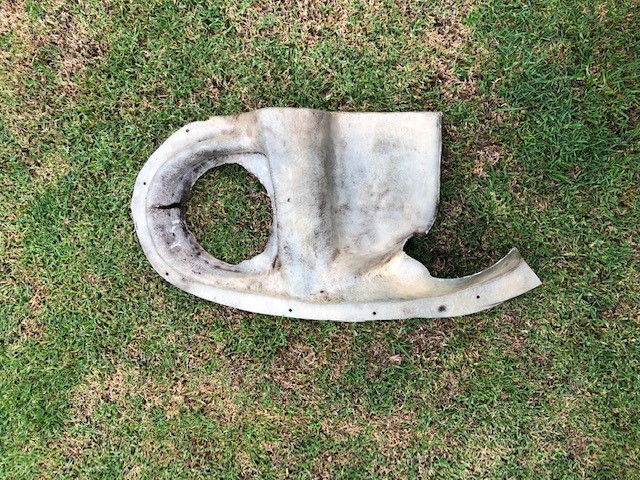

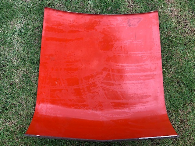

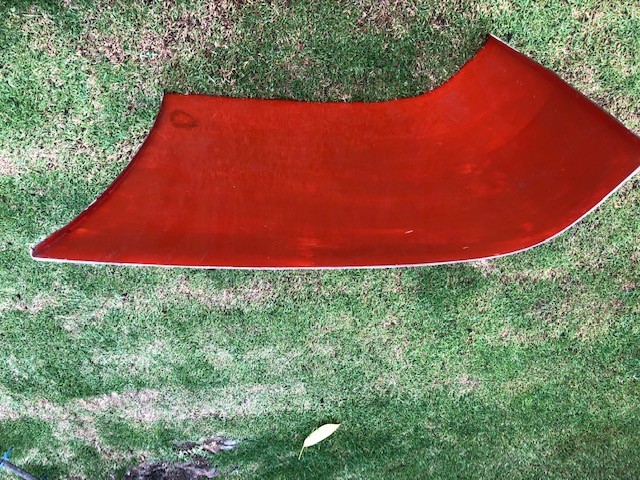

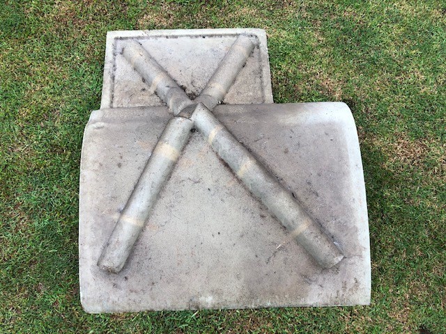

boot reverse side.jpg (158.21 KiB) Viewed 17890 times
boot layup side.jpg (105.21 KiB) Viewed 17890 times
bonnet side profile.jpg (156.78 KiB) Viewed 17890 times
bonnet reverse side.jpg (157.36 KiB) Viewed 17890 times
bonnet layup side.jpg (119.17 KiB) Viewed 17890 times

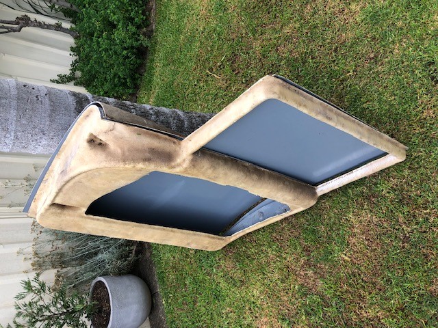

door outer skin reverse side.jpg (153.73 KiB) Viewed 17889 times
door outer skin layup side.jpg (118.92 KiB) Viewed 17889 times
door inner skin reverse side.jpg (164.93 KiB) Viewed 17889 times
door inner skin layup side.jpg (174.58 KiB) Viewed 17889 times
door inner and outer moulds assembled.jpg (146.76 KiB) Viewed 17889 times
boot side profile.jpg (165.92 KiB) Viewed 17889 times

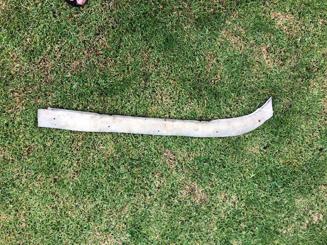

mudguard three pieces moulds assembled.jpg (170.98 KiB) Viewed 17888 times
mudguard main panel reverse side.jpg (158.93 KiB) Viewed 17888 times
mudguard main panel layup side.jpg (152.72 KiB) Viewed 17888 times
mudguard lip reverse side.jpg (200.44 KiB) Viewed 17888 times
mudguard lip layup side.jpg (209.93 KiB) Viewed 17888 times
mudguard front panel reverse side.jpg (189.95 KiB) Viewed 17888 times
mudguard front panel layup side.jpg (193.85 KiB) Viewed 17888 times
