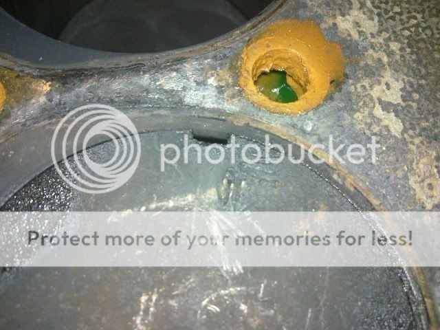

righto... no good.. pressure tested again.. and after running for about 45mins.. dropped a few psi... !
so head off... head gasket gone... and 2 pistons have holes in them !... head not damaged... !
i love these cars.. and the grey motor... but damn they are :evil:

mudgroup wrote: and 2 pistons have holes in them !...
:shock: :shock:
mudgroup
Posts: 314
Joined: Thu Mar 19, 2009 5:01 pm
Location: geelong
Re: condensation on my stick !!
Post by mudgroup »
yeah mick.. thats what i thought when i saw them... not one.. but 2.. no.2 and no.4 pistons... i suppose all will be revealed when we pull it apart ! like i said.. no damage to head... :(
