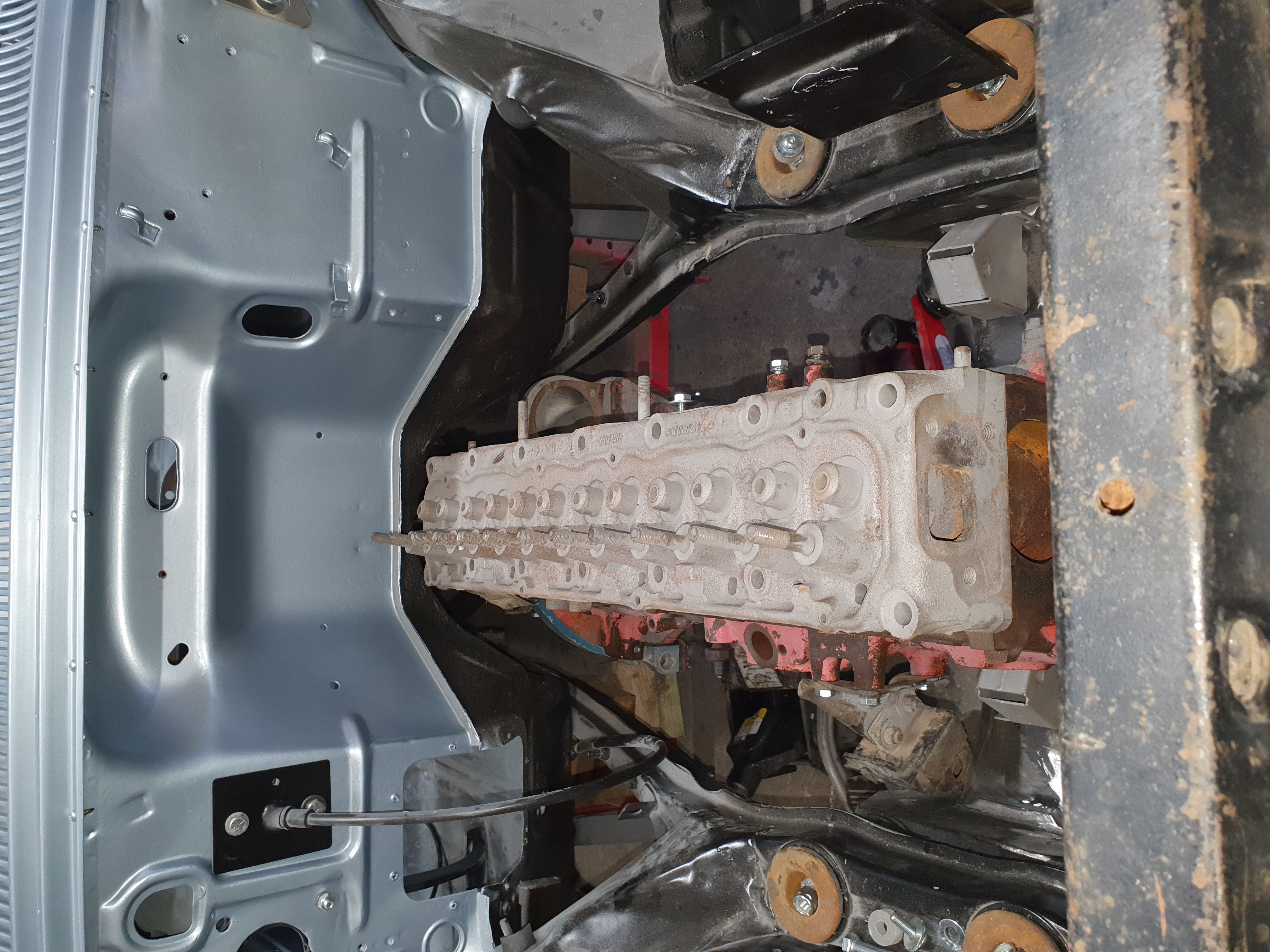

Deliberations are underway to find the perfect spot.
Thanks to 'Orange Betty' Dave for the use of a bare block to work it all out.
The M20 gearbox is a difficult fix, with the gear lever either coming up in the bench seat or if moved forward, in the middle of the crossmember. Clay and Rosco are being very helpful with measurements and pictures- many thanks gents.

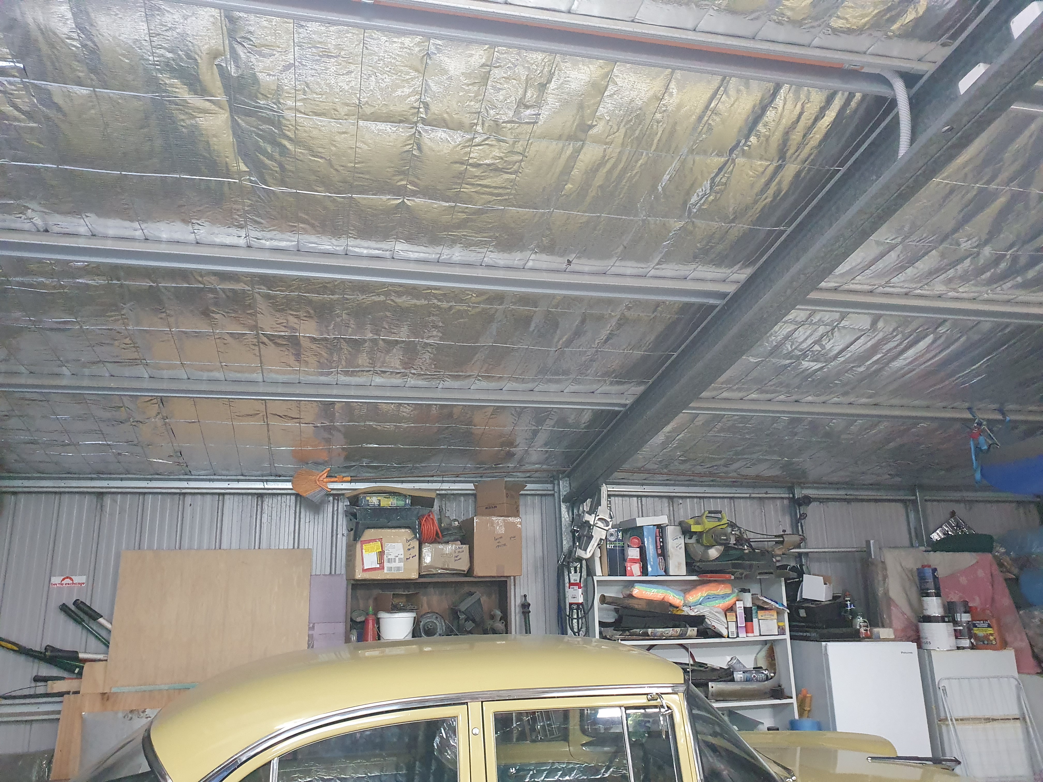

Finally bit the bullet and got my shed roof sorted. Condensation drips on frosty days was getting beyond a joke. Might help with temps a bit too.

Question for red motor enthusiasts.
I know the engine mounts rubbers are installed one side forward of the engine braket and one side behind. When you are installing new mounts on the crossmember, is there any reason not to mount them without taking into account the front/ rear issue and have the rubbers on both sides at the front or alternatively both at the rear?
Re: Project 2.
My opinion, it’s not that hard to discern how you set it up so mounts fall symmetrically on the crossmember. Weld them buggers on there good, and symmetrical. When you set up the gearbox mount you can play with the bits if necessary but shouldn’t have to.
Looking at a red in club members new van this afternoon at Nuriootpa and head was about 1mm clear of unmodified firewall seam, further back than mine. Doesn’t touch or hit at all owner says. Big fat alloy radiator in front and about the same clearance as what I have, and I’m happy with it. Important that the rear gearbox mount eliminates shear stress so the mill doesn’t lurch forward and bury the fan in the nice radiator.

What product did you use on the shed roof and do you have an approximate price per metre??
Re: Project 2.
It was 80m2 Blacky. Brand was 'Performins' R 1.3, and it worked out $10/m2. 15m2 in a roll. 12 months ago it would have been half that price.
There was also a roll of roof wire which I think was about $140.
It is nice to go in there now with no drips. Should be a bit better in hot times too.

Re: Project 2.
Insulation looks good Brett,
Did you remove roof sheets, roll out wire, insulation then reinstall roof sheets? Looks like insulation sits neatly on top of purlins.
I imagine it would be a pain to retrofit insulation after roof is on.
Re: Project 2.
Yep, sheets off ( one side at a time) wire strung, insulation rolled out then sheets back on and repeat. Took about 10 hours with 2 workers.
