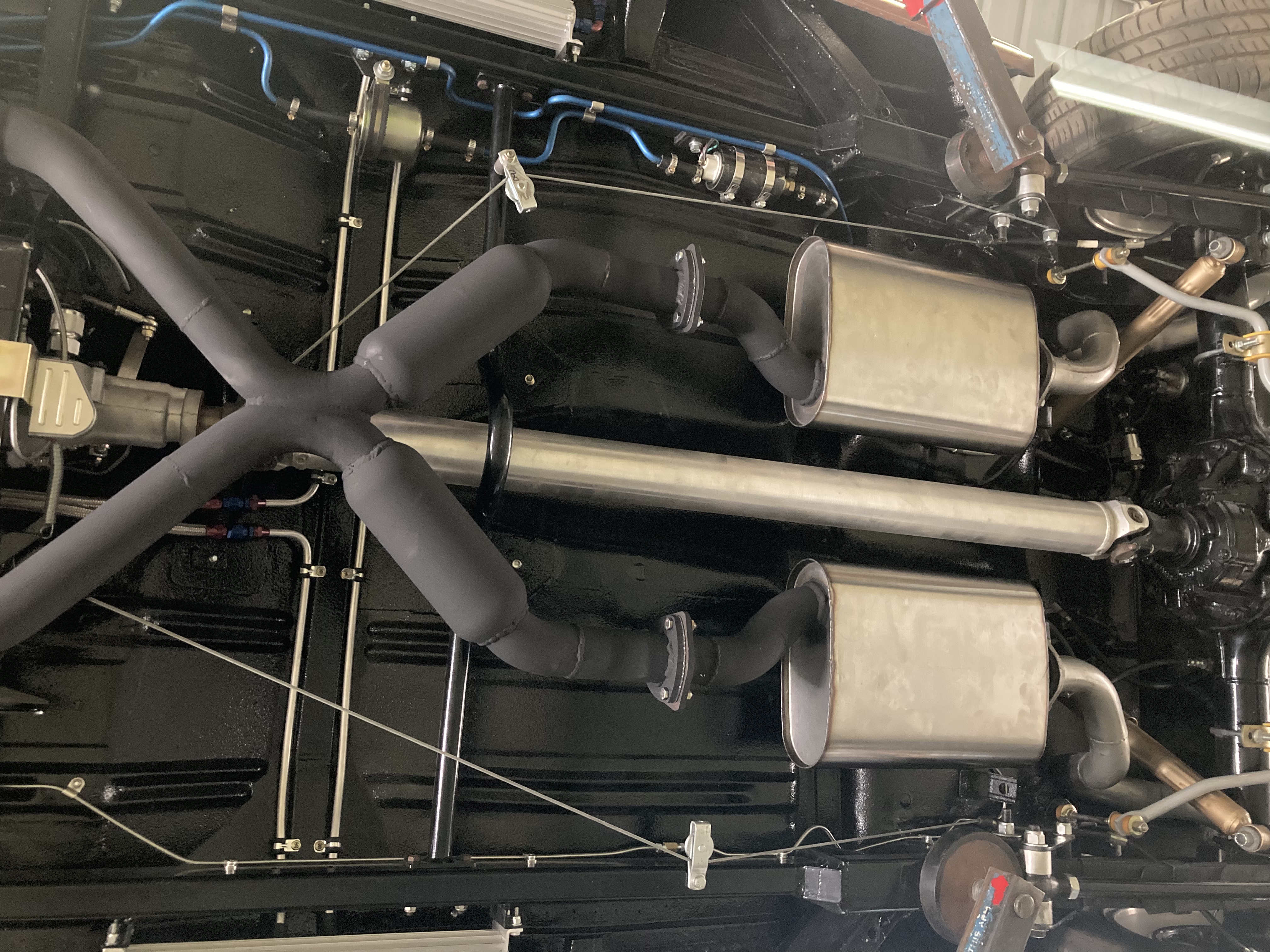

I have done everything he has requested so itโ€™s ready to go, the overheating I think is due to lack of air flow so 2 bigger and higher volume fans have been ordered. I will install them soon.
It looks like the car will wait until I get back from the Nationals.
New triple flow mufflers and resonators in, I wish I had a db meter as the phone one is not accurate.
So close yet so far !!!

by Brett027
I just love these pics. You are the neatest engineer on the forum. An absolute credit to you and your skills.
Re: Chev EK
Posted: Thu May 19, 2022 6:37 pm
Neat and functional as ever. Sorry I will have to wait until the Not The Vic Nats next year to see it by the looks, but it will be worth the wait Greg.
