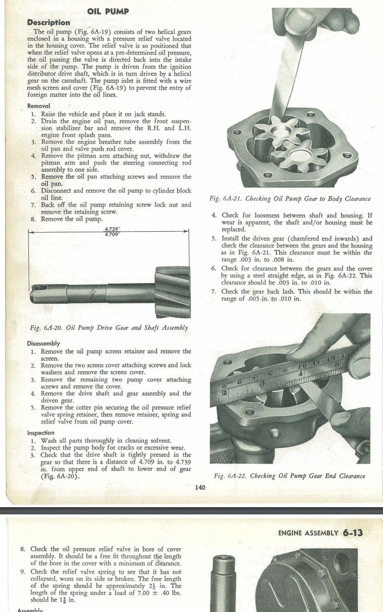

The spec is 29 psi +/- 2psi. 27 would be low, 24 is a fair bit underspec.
To be honest, I reckon there are a lot of greys out there at that pressure (or lower). If you were just tootling around, it probably won't hurt anything. If you really want to lean on it, then 24psi could catch you out.
You could try shimming the relief valve. Relatively easy to get at, and cheap. That might give you a few more psi. If you go down that route, then check pump clearance whilst it is in pieces:
oil pump tests.JPG (183.61 KiB) Viewed 980 times
Can't remember if you rebuilt the oil pump on this. There are rebuild kits available, but you may need to sell a kidney to afford one:
https://www.autosurplus.com.au/oil-pump ... ek-ej-grey

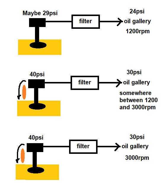

Some more thinking. This is what I think your system is doing.
At low revs (0-1200rpm) the relief valve is shut, and pump is delivering all the oil it is sucking up. You get some pressure drop across the filter, and end up delivering 24psi to the galleries. The galleries are still getting the same amount of oil that they would have without a filter (because the gear pump puts out a set volume). They are fed at a lower pressure though. This should be fine - if the oil is flowing the same volume, then the bearings are getting what they need.
oil pressure.png (14.55 KiB) Viewed 952 times
As revs increase pump pressure gets higher and higher. Somewhere above 1200rpm but less than 3000rpm (lets call it "X" rpm) the filter becomes restrictive enough that the relief valve lifts at 40psi. Some of the oil goes to the bearings, and some cycles back to the sump. You end up with 30psi at the galleries.
As revs increase more and more (up to 3000rpm, or higher) you will get no more oil pressure. The relief valve stays open, holding the pump at 40psi and the galleries at 30psi.
The engine is safe all the way up to "X" rpm. At every given speed, the pump is delivering the same volume oil that GMH thought it should. The risk comes in above "X" rpm when some oil goes to the bearings, and some to the sump. You're getting 30psi above "X", but no idea of how much flow. 29-30psi was fine at 1200rpm, and may well be fine above 1200rpm too.
I reckon a standard grey motor also plateaus like that. To test the theory, take a standard grey motor in good condition and measure the oil pressure from 0 through to the redline. If it plateaus around 30psi or so then I reckon you are OK.
