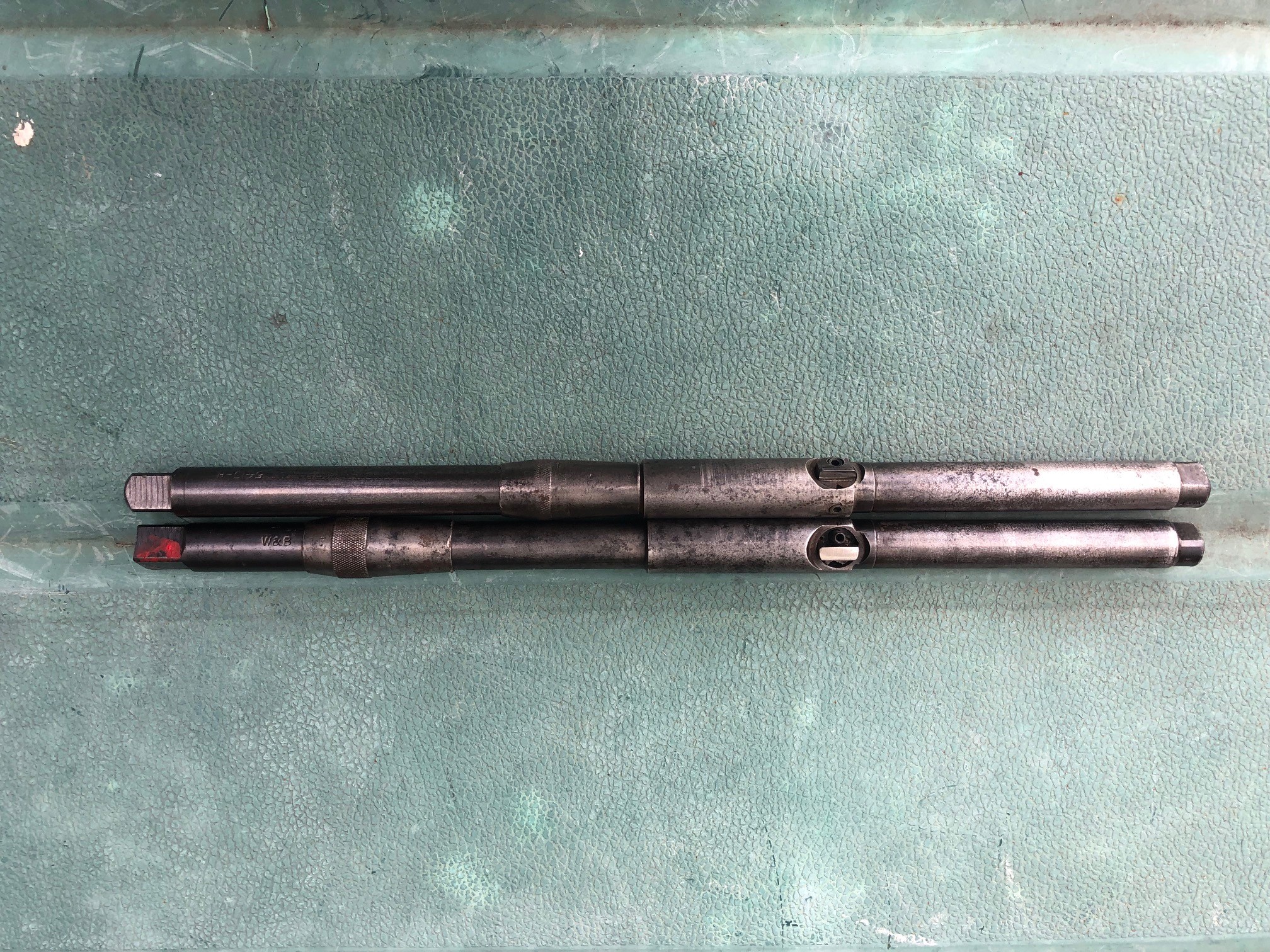

Yep, suspect my two are for the early kingpins.
If you get a chance Brett, can you please measure the pilot and ream diameters (less the cutter)?

Harv, pilot is 3/4 inch. Reamer is a Warren and Brown 5414-H type.ImageImage
