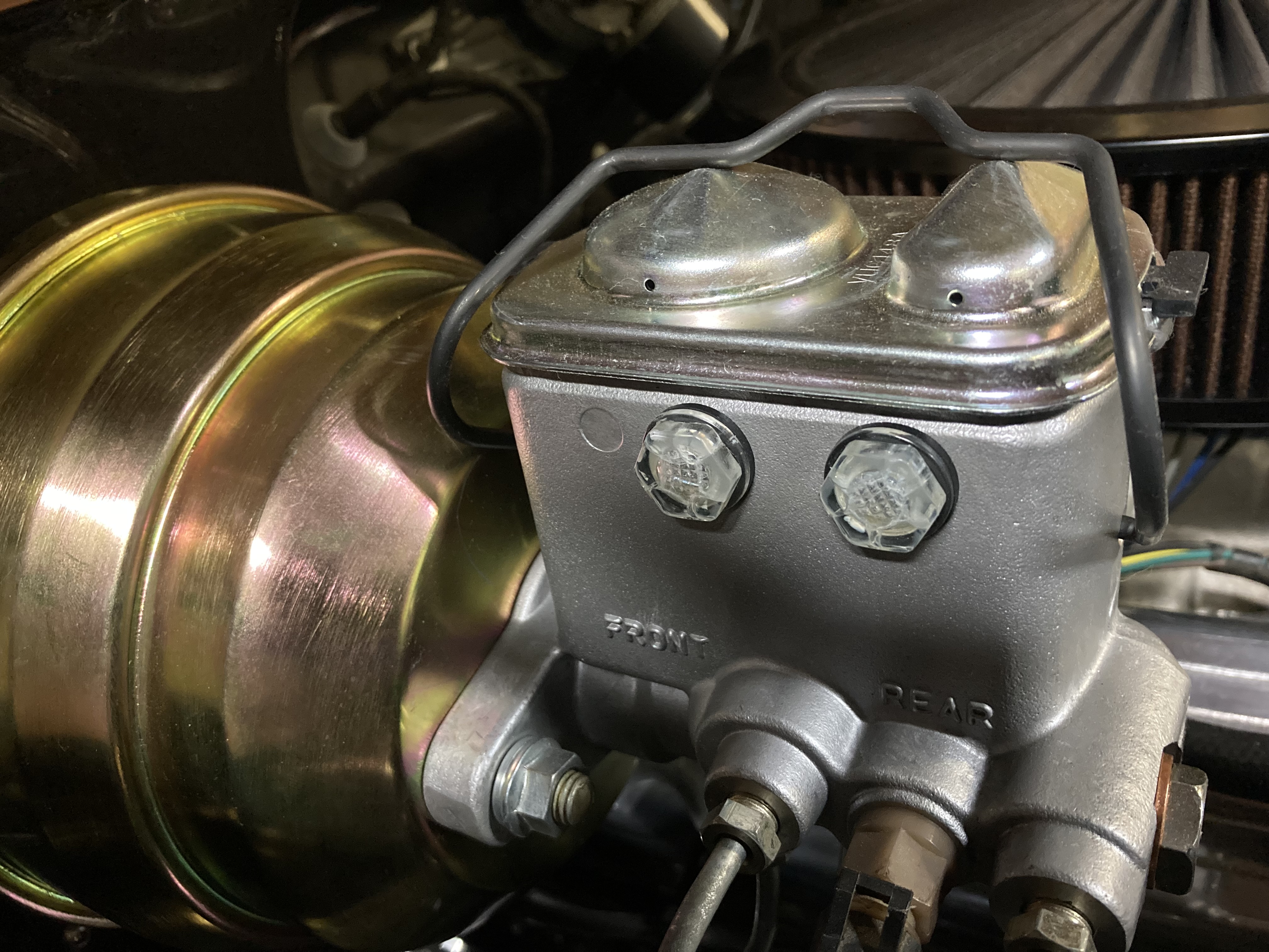

Brake sight glass plastic is a fail, they have developed cracks and are starting to go milky. I have ordered new ones that are glass and waiting patiently for those to arrive.
I was hoping I could be lucky with the plastic but no, the only other concern is the rubber gasket with the new glass but at least that will take a while to break down until I can source the correct type.
Next booking with the engineer is the 4th May, getting tight now time wise !!!!

Bummer on the sight glass. Give that injunear a clip behind the ear.

............or get it signed off quick and replace master cylinder with one that doesnt have those stupid sight glasses in it :thumbsup:

Blacky wrote: Wed Apr 13, 2022 10:12 am ............or get it signed off quick and replace master cylinder with one that doesnt have those stupid sight glasses in it :thumbsup:
Blacky,
That would be immoral as well as illegal, I'm flabbergasted that you would even suggest such a thing !!!!!!
I'll work it out don't you worry :evilll: :evilll: :evilll:

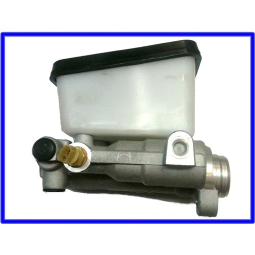

Greg is this type of master cylinder not an option?
