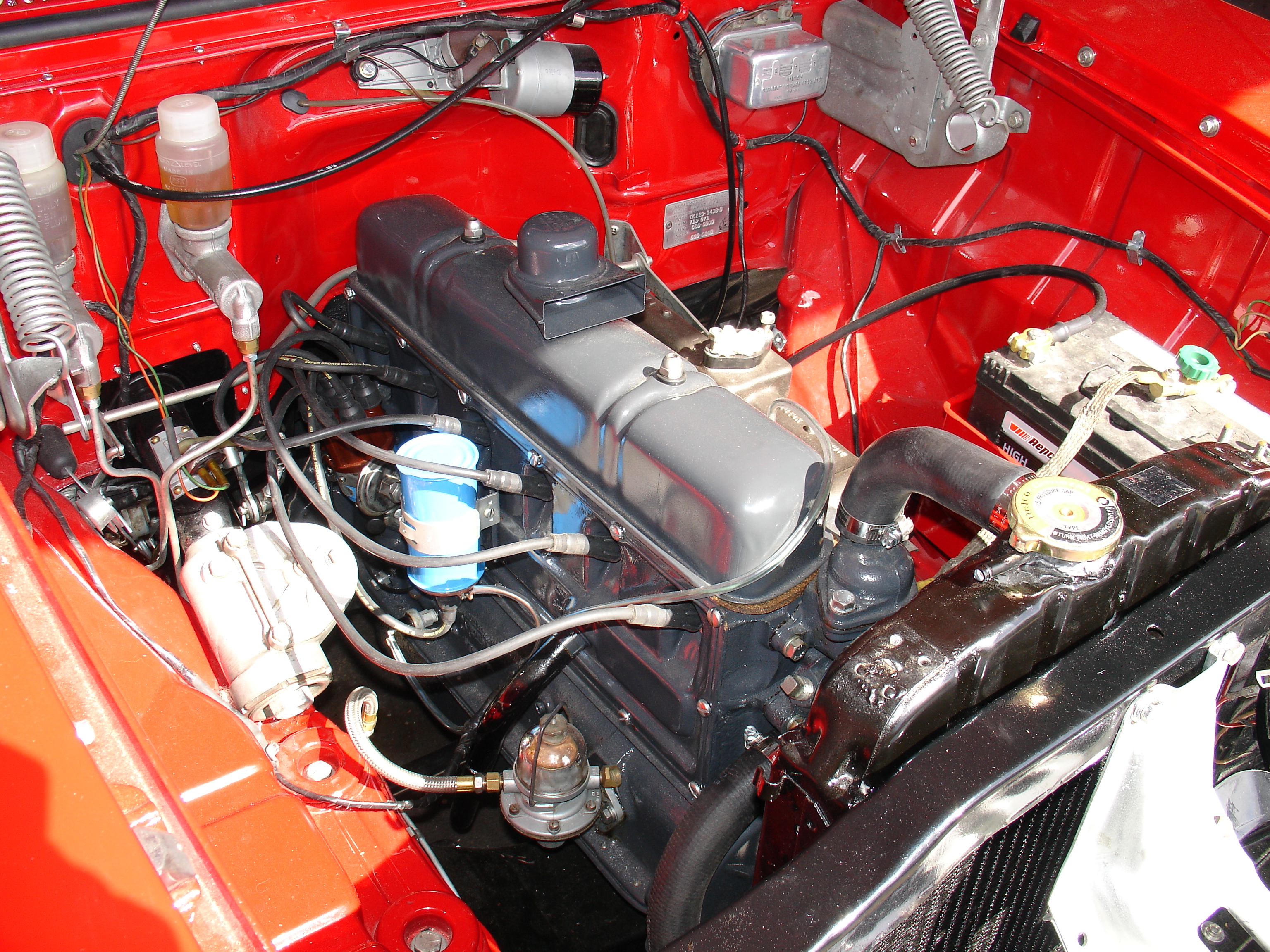

More shiny bits. The painting is now finished.

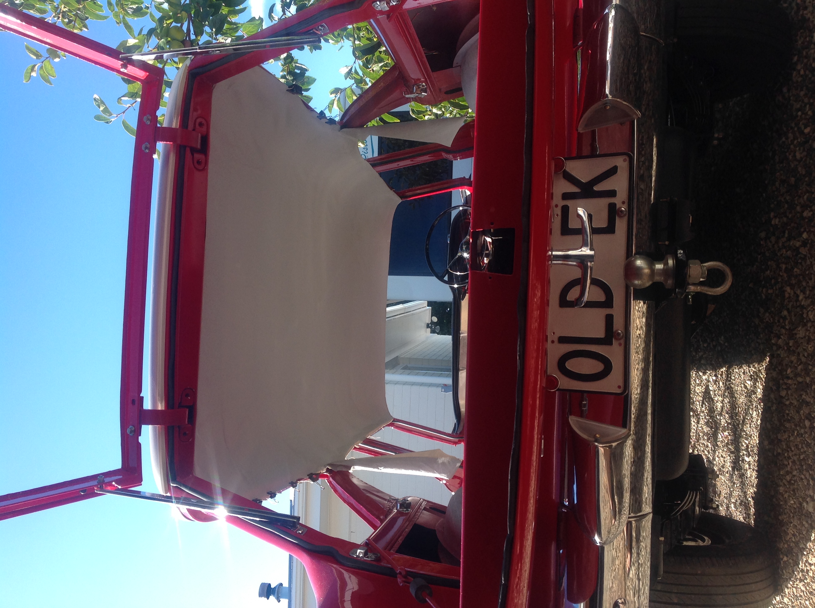

So Far so good assembly under way . Back rubber strips - rht hand new old stock ,left and centre made up from Para rubber stock. Also hood lining (nos) going in.

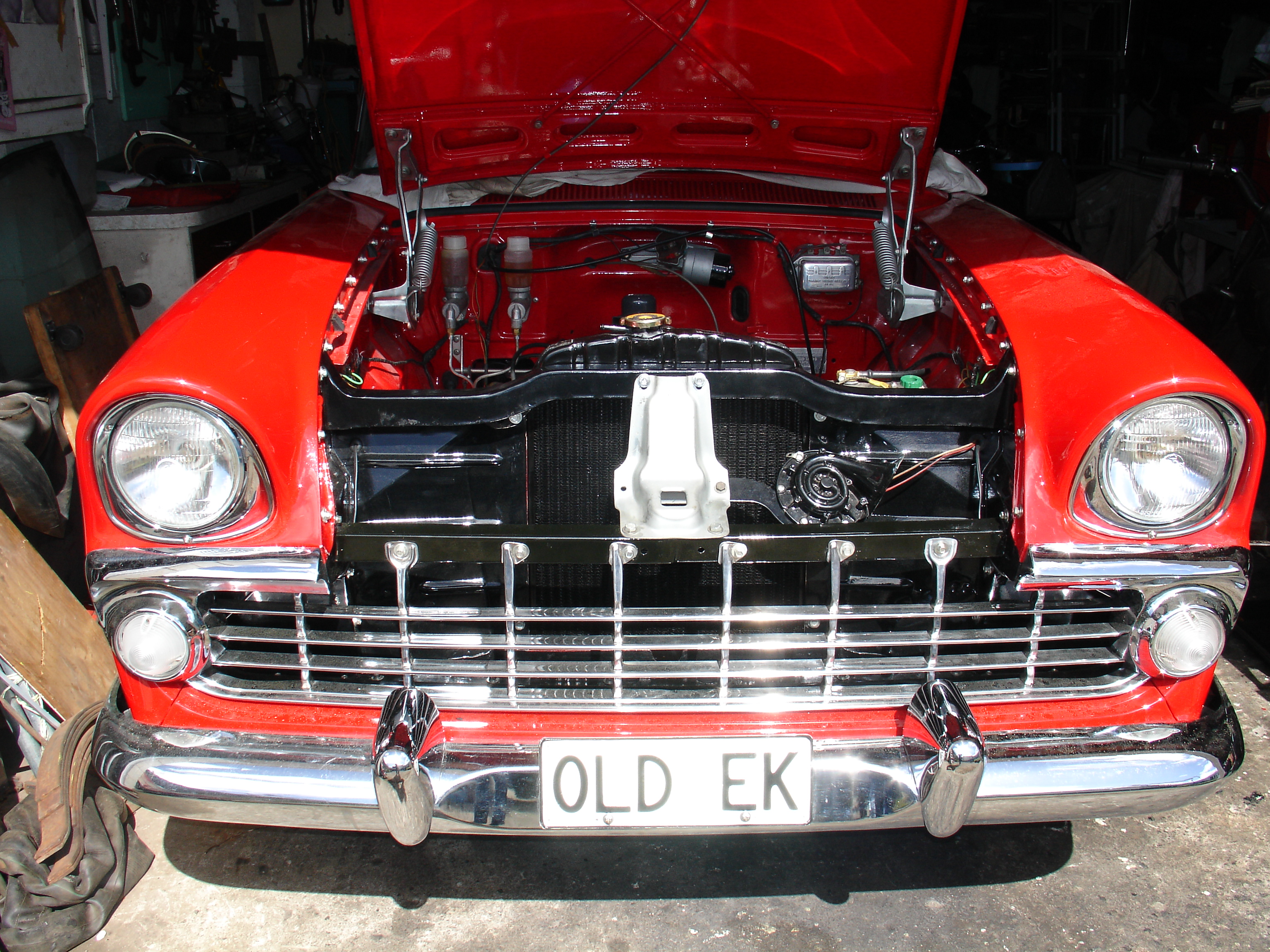

A N.O.S. Windscreen ready to go in and a shot with the front sheet metal in place. I loved the job bolting the guards thru the A -pillar and dropping the bolts down into the bottom recess.
