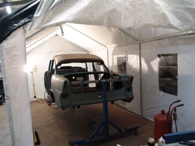

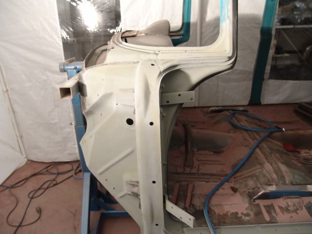

I stripped the VN SS and made up the seat rails ..... I welded the original VN nuts inside so the seats are mounted with the VN bolts, the rails are now fully welded to the floor pan 8)

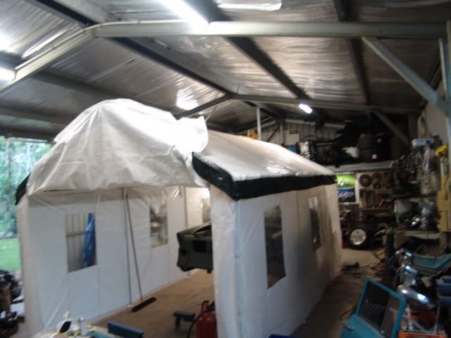

The sandblasters in Darwin are great with 20mm plate but it is recommended not to give them your car :shock: :shock: , so I have set up an area in the shed to deal with it, bloody wet season :wink: now and it is very difficult to do this out in the open, 'cause when it rains here it bloody pisses down (40mm yesterday) :shock: :shock: :shock:

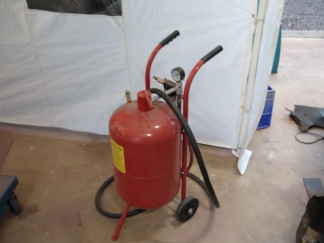

:? :? bought this little blaster and a shit load of garnet ......... :shock: :shock:
Damn thing works a treat .... very happy ..... should be all done and primed by the weekend :wink: :wink:
Once the blasting priming is done then it will be repair any "new rust" and then pre assembly of suspension, motor, trans etc...... :D :D :D

2pk spray booth as well, good idea :roll: .

what does the inner seat rail look like, i had a simular idea but my outer rail will just about bolt direct to the floor and the inner sunk into the floor
i'm only a short arse but still find commodore seats sit up to high :? :roll:

Now your just showing off, a shed inside your shed. :lol:

hey now theres a great idea for a spray booth .. wish id thought of it before i sprayed my car .. lol
Great idea, multi purpose too....Spray, blast, protect.
Blaster works well, you'll be done in no time at this pace.... 8)
