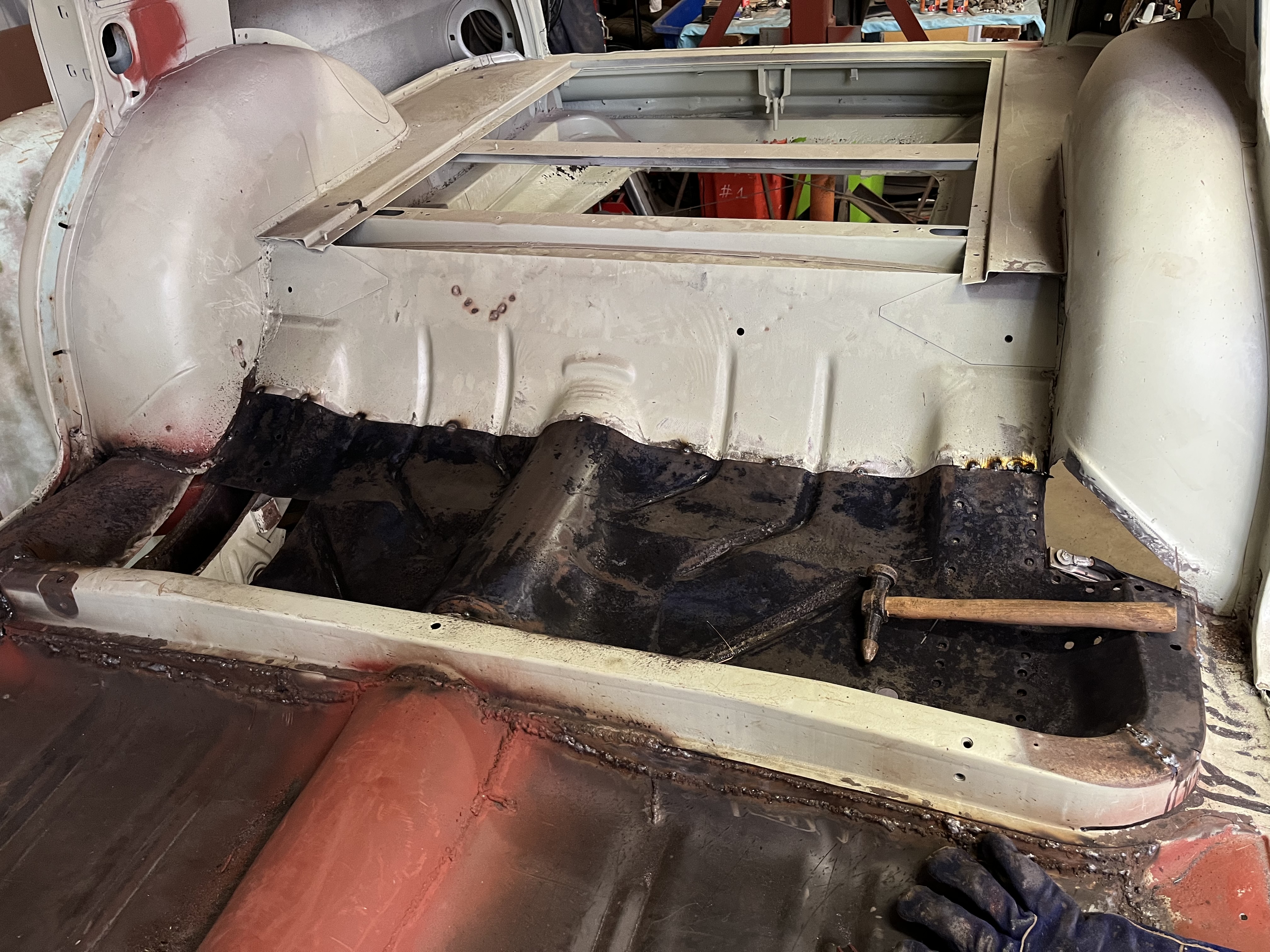

Well I was able to get into my workshop on Sunday and started to put the under seat repair into the wagon, was able to get it tacked for now and I'll finish welding this weekend hopefully, Saturday at least Dunn Run Sunday :clap: :lol:

Meant to throw a photo :lol:

Posted: Mon Oct 23, 2023 9:22 pm
Looks good mate

Posted: Tue Oct 24, 2023 12:04 am
Ready for tubs 8) 8)
