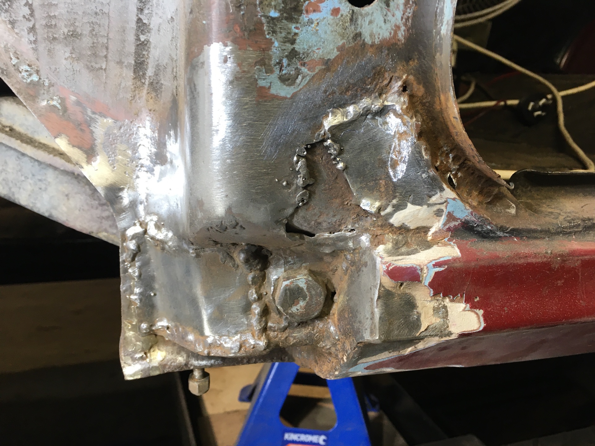

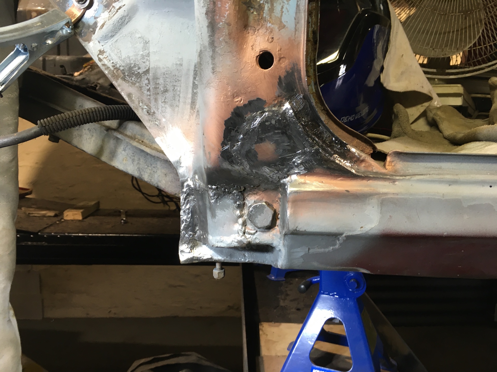

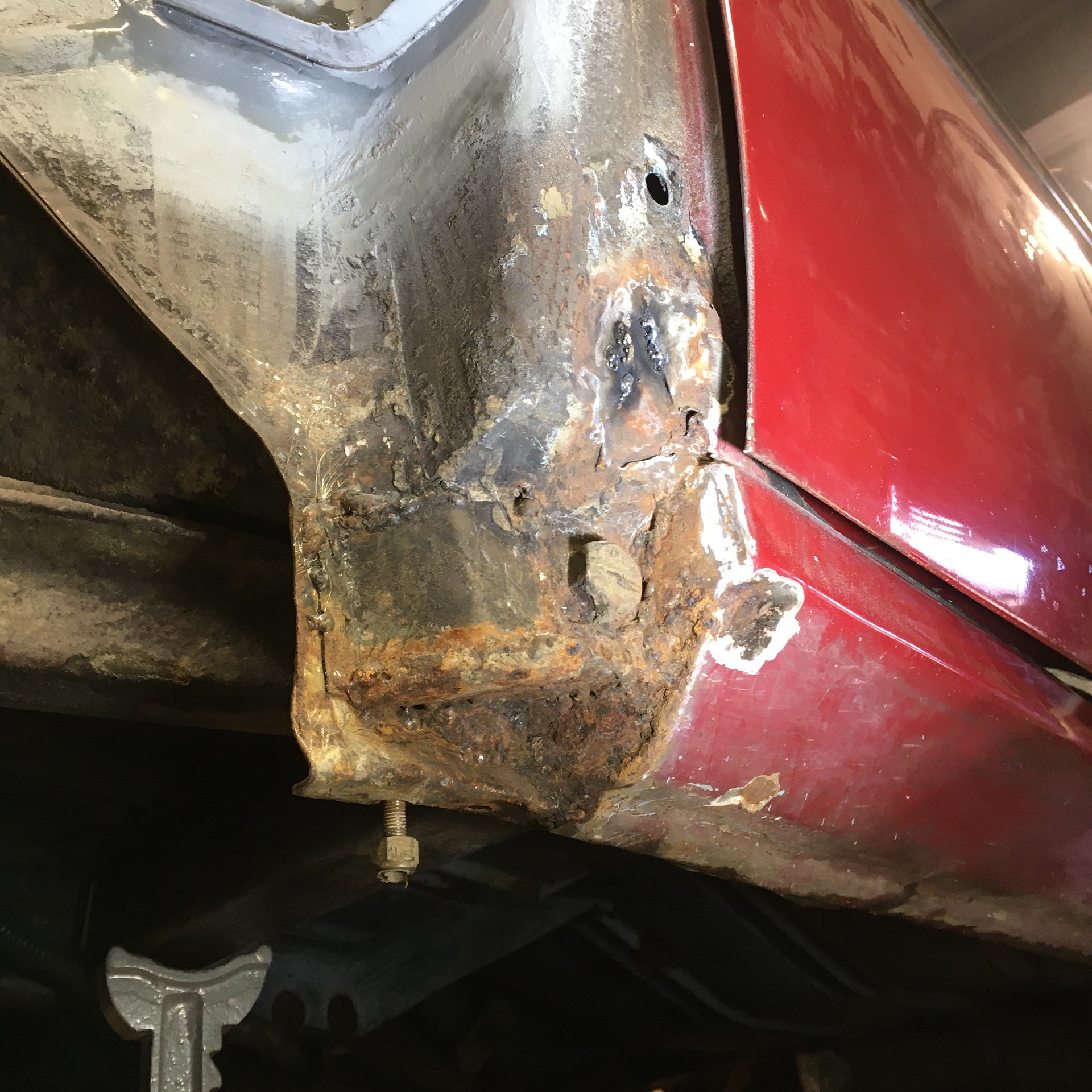

Hot day so more updates.
So next job which I started a couple weeks back. Passenger A Pillar Had a bit of repair work done at some point. Hit it with the wire brush to reveal a bit more. Part of the patch just came off in my hand. The picture also shows that this repair was before the car was painted red. You can see on the sill its bog, blue, red.
Cut and dremel out the rust. Going to try and fill in the lip with weld to avoid making a replacement section Much welding and grinding later I have this. Possibly should have not been so lazy and cut more metal out. Was worried my skills with metal fabrication would be worse than those with the welder! In the end I have this. Not awesome, still a bit of work to do.

Did a bit more welding on that A Pillar. Thought I did ok. Then I looked at the photo. Still got a couple small holes at the top. Be out the again tomorrow. Should have made a patch!
