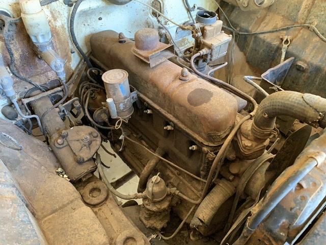

I have plenty of time for sure now Blacky.
First thing is to see if I can get this motor running...

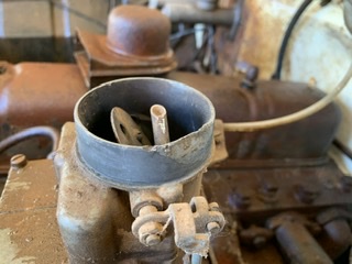

Post by FbSTDwagon »
Looks like someone has modified the carby with a hammer at some point!

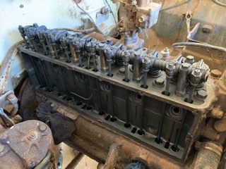

No bent push rods or broken rockers -good so far

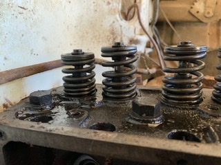

Stuck valve on cylinder 6...

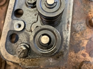

Valve free up ok with some Inox and a hammer but #1 exhaust valve is missing a retaining collet so I think that may be a show stopper for the start up mission.
I’ll move on with the rest of the process...

Post by ardiesse »
The old-timers used to feed sash cord down into the spark plug hole until it wadded up good and proper, then turn the engine over on the compression stroke to jam the sash cord into the combustion chamber. The sash cord held the valves shut, and then you could remove the collets, keeper and spring without pulling the cylinder head off.
ardiesse
Posts: 1204
Re: FB Standard Wagon
Post by ardiesse »
Oh, and . . .
Pull the distributor out, chuck a long screwdriver shaft into a drill, engage the oil pump drive, and run the drill for a couple of minutes.

Hi Drew;
I had to change valve springs on my Ute engine after I had reassembled it and didn't want to pull the heads again so made up an air fitting to screw into the spark plug hole and connected air compressor to the fitting, if your rings are ok this will keep the valves shut while you comress the spring to fit the collet, just a thought :thumbsup:

ardiesse wrote: Fri Nov 20, 2020 9:34 am The old-timers used to feed sash cord down into the spark plug hole until it wadded up good and proper, then turn the engine over on the compression stroke to jam the sash cord into the combustion chamber. The sash cord held the valves shut, and then you could remove the collets, keeper and spring without pulling the cylinder head off.
Gday Rob and thanks again for the tail gate badge.
Yes that is a good trick that I will use if I can get the motor to actually turn over...
And yes first thing I did was pull the dizzy to turn the oil pump.
More lube the better!!!
She is holding stiff.
