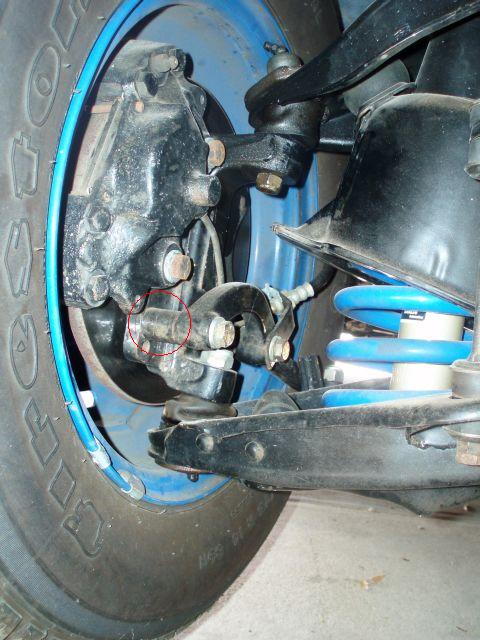

thebrotherj wrote: Mon Nov 20, 2017 5:49 pmMy ex-HT Monaro steelies look great on it, but foul the steering knuckle. I'll work something out.
One option is to put in a set of spacers in the steering arms (with thanks to Stinky who showed me this many years ago when I was figuring out Commodore rims). See the red circle in the photo below:
