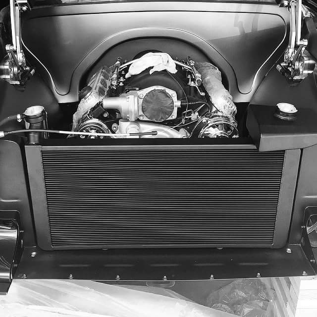

Zip ties 😝😝 yeah naaa. I have to cut into the inner guards slightly so will fab up a new support panels that will not rely on the cross brace to hold it all together. Similar to the photo.

Wow Taz pretty cool photo; thats in an FC isn't it?
Love your work mate please keep the photos coming of your progress.

Yes mate it is, FC ute that Downtown Customs built. Check out their FB page as they have plenty of photos showing the build.
