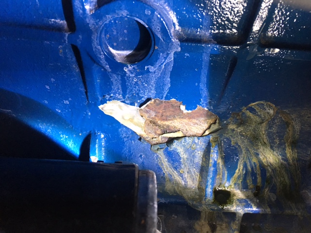

Clay - appreciate your thoughts and kind words. I have to admit Pa's Ute was never really intended to be restored back to complete original. The motor is painted blue, the tray is a combination of wood and marine carpet, the upholstery is obviously not original and you're right that the dash should be body colour. I also found out the hard way that the centre bumper I got chromed was from an FB and not an EK. Therefore the overriders (that are also rechromed) don't fit unless I put holes in it.
Anyway there is still a few things I want to do - rubber mat rather than carpet, retro seatbelts from Seatbelt Solutions WA, a bit more rechroming, lower it for handling and a new block as the one I have in has a very small water leak (tried a few products like Chemweld without success). But I suspect the restoration will never be complete. :wink:

Re: Pa's Ute
Posted: Tue Sep 26, 2017 8:38 pm
by ardiesse
You wrote -
". . . and a new block as the one I have in has a very small water leak (tried a few products like Chemweld without success)."
Where's the water leaking from, or is it difficult to locate?
Rusty stains on the left hand side of the crankcase are usually welch plugs.
An occasional drip of water from the bottom of the bellhousing is a sign that the welch plug at the back of the block's had it.
If you have water in the oil, it's either the welch plugs on the right hand side of the block, or a leaking head gasket.
Run your finger around the inside of the welch plug at the back of the head. If you wipe out water or rusty mud, you've found the leak.
Does water tend to pool up on the front engine mount plate? That's usually water pump or water pump gaskets.
Thermostat housing gaskets? Look in the little gap between the water pump and the cylinder head. If water builds up there, it's usually the thermostat housing-to-head gasket.
Your radiator may have a very slow leak.
I mention all this because replacing the block is an enormous undertaking.
(But if you need another block, I have an unmolested, Nov 1961 one.)

Re: Pa's Ute
Posted: Wed Sep 27, 2017 3:12 pm
by OldMan's Lacky
Hi Rob,
The leak is quite obvious (pictured). My old man actually tried to weld it a number of years ago. It hasn't held.
Would be interested in your block depending on price of course.
Thank you!

Re: Pa's Ute
Posted: Thu Sep 28, 2017 3:13 pm
by ardiesse
OldMan's Lacky wrote: Wed Sep 27, 2017 3:12 pm Hi Rob,
Umm, yeah. I see what you mean. I'll pm you with a description of my block, and we'll take it from there.
