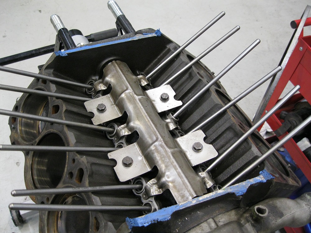

Hey Greg/Blacky
Thanks for the reply, I spoke to the guy (Noel) that I bought the engine from and he said they are hydraulic lifters, the roller rockers he had on the engine were not adjustable which I take confirms that is a hydraulic cam/lifters. I would assume that the rockers need to be adjustable if using solid lifters.
I just looked back at the photos I took when I removed the heads after receiving the engine and it looks like the lifters are hydralic.
The heads did have a lot of work done to them and the difference between compression and no compression is about a half turn of the bolt.

I've decided not to F around with my engine and just change out the lifters.
I spoke to another mechanic mate that runs his own shop and he thinks it is a stuck lifter so for a couple of hundred $ I may as well just change them and take it from there.
Do you really have to pre-pump them with oil or is it ok to just let them pump up when you first start up.

Just submerge them all in a tub of oil for a day or two.

Agree, sounds like a stuck lifter. Is the oil path on these things from lifter to rocker gear? If so, it may be pumping up, then not able to relieve oil to the rockers. Check for a blocked pushrod/rocker gallery.

That's a good idea Harv yes the push rod supplies oil up to the rocker, I've already purchased a set of lifters but will check the push rod to see if clear.
