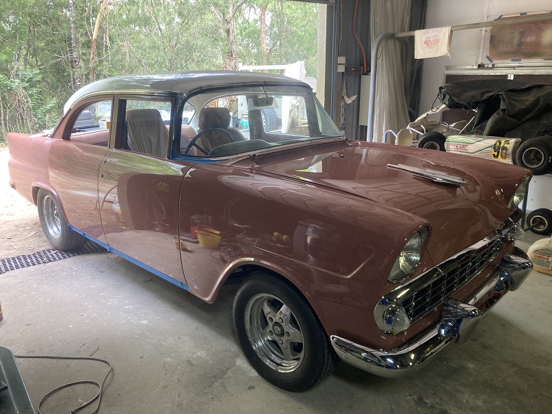

A bit more today with the buff !
Front is sitting high and I've only got the windows left to put in, May have to get the oxy out and adjust the spring coils !!!

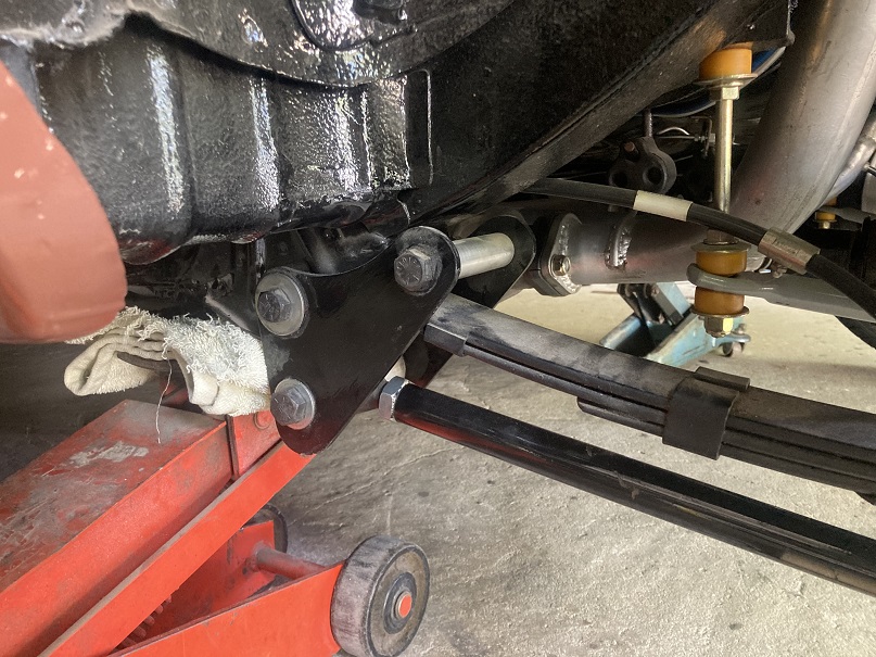

EK283 wrote: Tue Feb 02, 2021 5:39 pm A bit more today with the buff !
Greg would it have been possible to channel the sub frame any further into the Torana crossmember?

oz_ek wrote: Tue Feb 02, 2021 10:10 pm
Hi ozek,
The springs I have in the car at the moment were unknown apart from heavy duty standard height. I have HQ stubs that lower the car 1 inch already but I have 4 inches of bump and only 1 inch of rebound (rubbers to subframe).
So I will let it go and have a drive first see if it sags at all.
Channelling the sub frame any more would give issues with the steering uni coming up higher and fouling on the chassis rail. As it turns out I had to trim the rack shaft back about a inch to get it to fit.

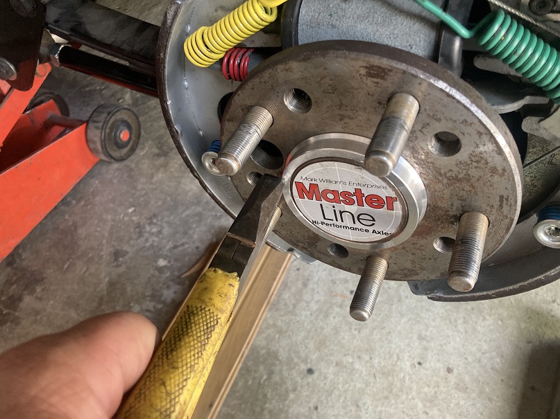

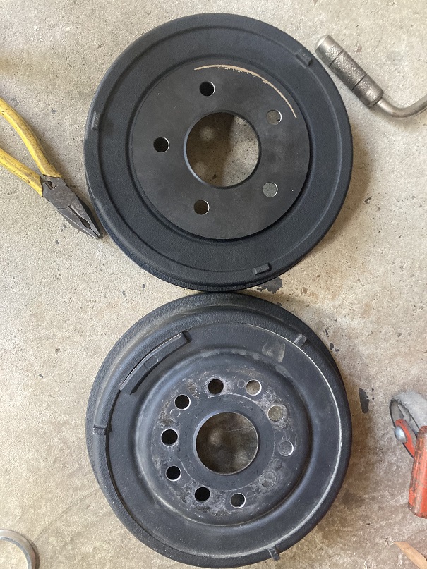

Mucking around with brakes today, I decided to change my stud pattern to suite Chev and to coincide with my new wheels. My axles were already drilled for both patterns Fraud and Chev and I also drilled my brake drums for both patterns. Apparently this is now not compliant with NCOP ??
I decided to change the drums and have found that HQ is the same pattern as CHEV and will fit the Fraud brakes. The only issue is the larger centre the HQ drum has over the axle. I had some rings made up from an ebay site that were press fit but I used a trick I learnt when in high school !!! Simply heat the rings and they will slip on cool down and shrink tight. Success !!!!!

Caltracs, nice.
4.75” HQ - HZ, WB? and Chev. You make it sound so easy Greg. Having the multi fit axles helps I suppose. Is it the drums that don’t comply, and could you weld up the holes?
Re: Chev EK
Posted: Wed Mar 10, 2021 6:14 am
EK283 wrote: Tue Mar 09, 2021 7:34 pmMy axles were already drilled for both patterns Fraud and Chev and I also drilled my brake drums for both patterns. Apparently this is now not compliant with NCOP ??
NCOP Section LG Brakes, 2.5 Modification of Components:
The re-drilling of drums or rotors to suit different stud patterns must not be undertaken
unless in accordance with the manufacturers’ specifications.
Hmm.... this might be an interesting conversation with the engineer for my meth monster disc brake conversion. It uses redrilled Mitsi rotors. Quite a few of the kits sold via Hoppers Stoppers though, which perhaps will sway the argument. Hoppers manufacture the hubs, perhaps the same can be said for the (new) repurposed (redrilled) rotors.
