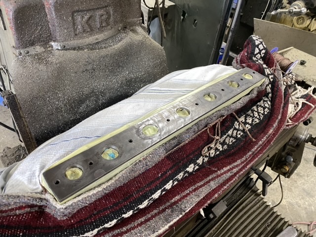

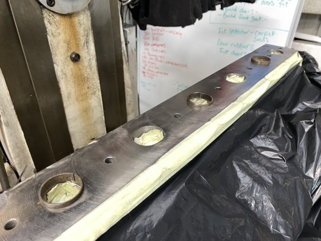

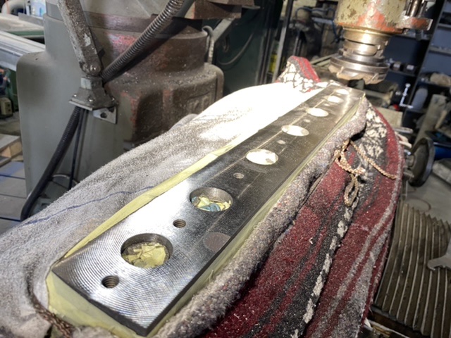

Spent the morning at my mates machine shop doing a touch of decking. The mill I own was didn’t have enough travel to get the job done at home.
Actually surprised the HSD head wasn’t decked on the manifold face and it needed it done so I hd to go and do it myself.
I hate work like this on a finished unit but I had no choice.

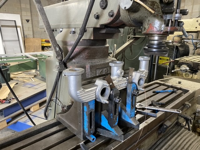

Re: FB Standard Wagon
Also decked the manifold too.

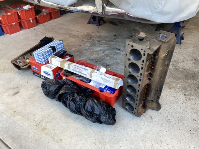

So finally I am starting the engine build, I will post heaps so you guys can point out things to me if it looks like I need some education

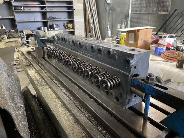

First job is to align the manifold and extractors to the ports in the head.
Manifold seems easy as the rings will keep the alignment whilst I drill the roll pins in.
I’m a guessing I will need to fit the extractor gasket and drill through that as well?
Drew,
I'm going to jump the gun.
Clean the mating faces of head and block, sit the head on the block, and try to insert your thinnest feeler gauge between the two in as many places as you care. If there's no place where you can, then - with a Texta, draw a cross-hatch pattern on the block deck and on the head face. Sit the head on the block, and move the head in little circles, or back and forth and side to side. Then examine both faces to see where they make contact with each other. It's best to do this now, rather than wonder why the head gasket weeps after the engine's assembled.
If I seem unduly pessimistic, it's Sod's First Law of Automotive Metallurgy speaking: Surfaces which have been machined flat aren't.
There'll be another post on fitting the front engine mount plate, and yet another about the rear main bearing cap and rear main bearing oil seal.
I always appreciate good tips Rob!
Both the block and head have been decked… is this not good enough?
