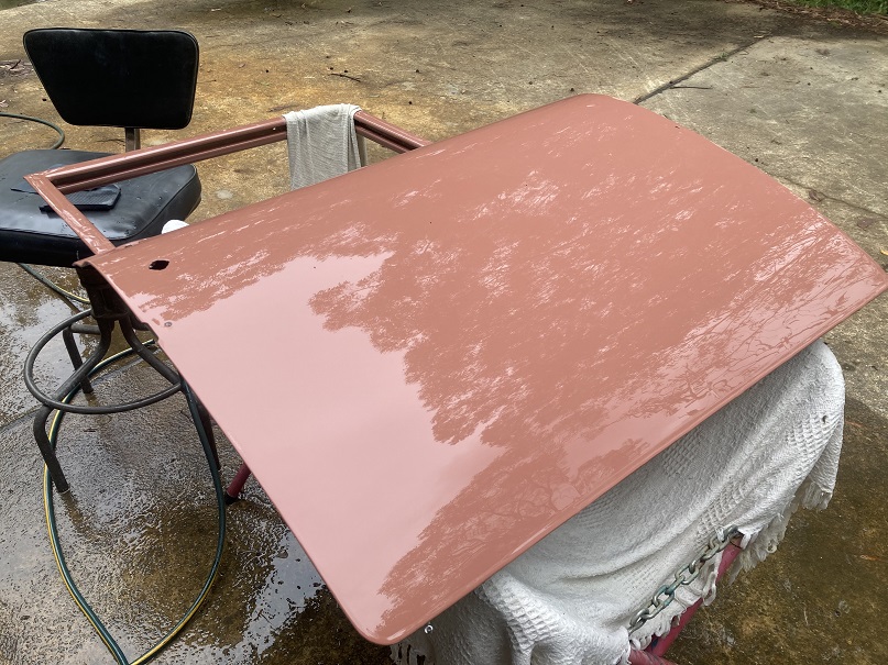

Anyway the whale has resurfaced !
Finally I can put it back together !!!!

The rewarding bit
Paint looks outstanding Greg.

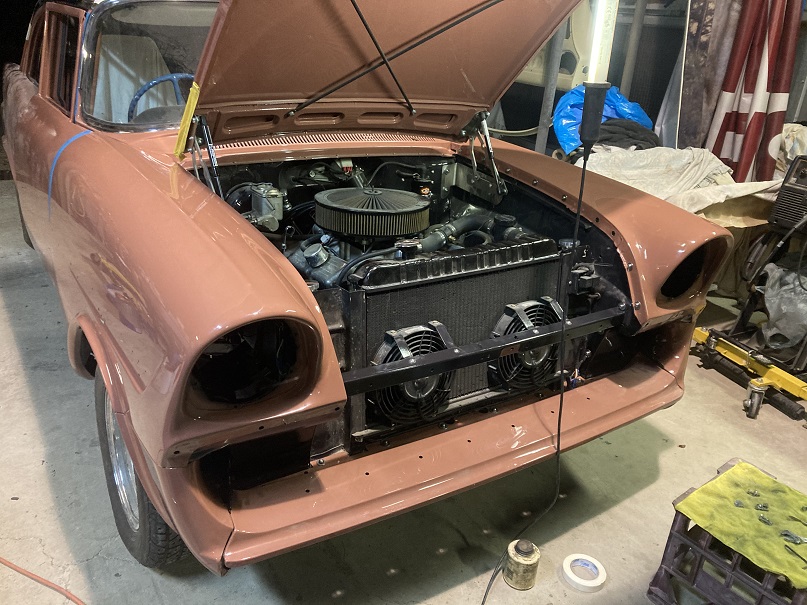

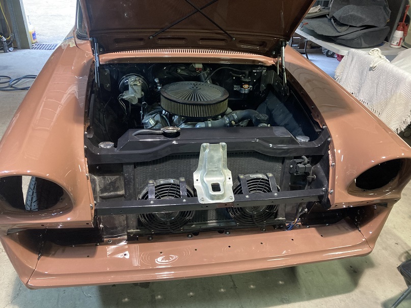

Not much happening,
Just a couple of bits before christmas.
Might have to take the guards off again as the sides are bending when I tighten the inside bolts and showing small waves in the paint !!! Arrgghhh.
More time off after chrismas so will make an effort.

Damn, fiddly job with the rear edge bolts from inside the car. Wonder why they are bending. Either both guards or sides of the subframe must be bent. Inner guards should be a plane surface I reckon.

Errol62 wrote: Tue Dec 22, 2020 5:25 pm Damn, fiddly job with the rear edge bolts from inside the car. Wonder why they are bending. Either both guards or sides of the subframe must be bent. Inner guards should be a plane surface I reckon.
Its the bolts that do up from inside the pillar, when I mocked it all up I had no rubbers underneath, I'm thinking that's the issue, as when I get to the point where I like the shape along the door edge it twists and the guard edge then pulls in and creates a slight wave about 10mm from the edge itself.

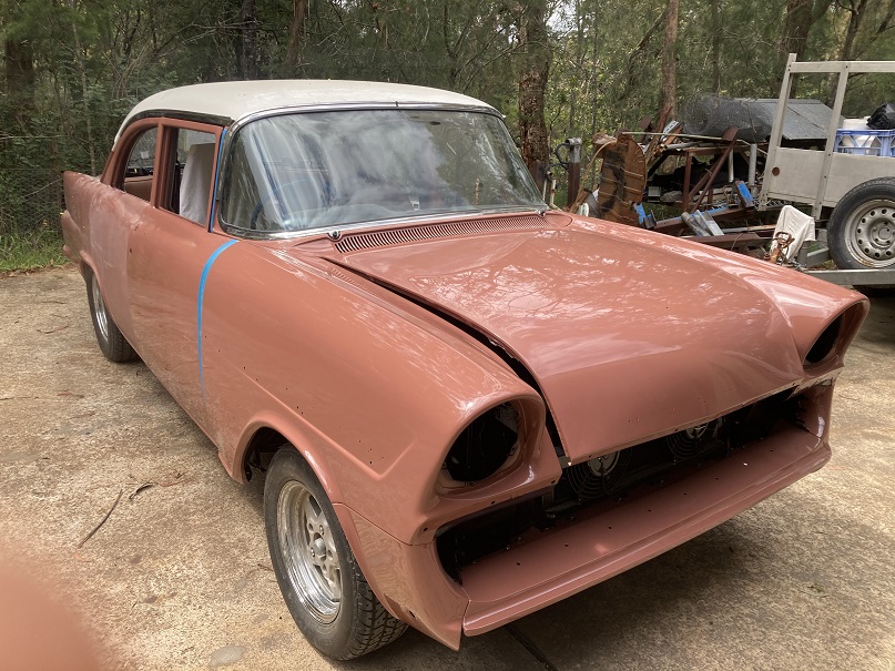

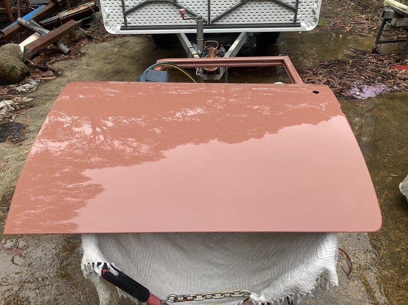

Couple of spare hours and started wet rubbing and finishing the orange peel out of the clear coat.
If the buffing process looks as good as the wet look I will be happy !!!

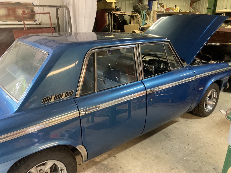

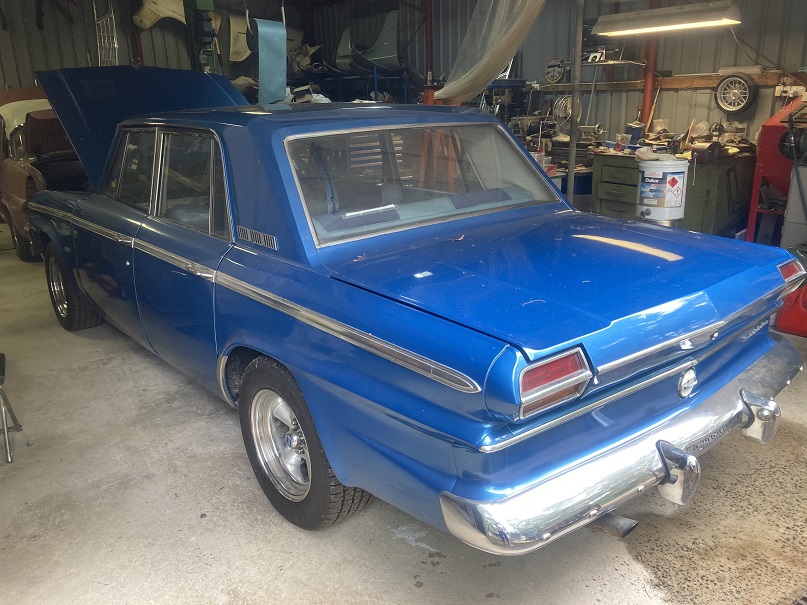

Also a blast from the past !!!! This is the second car I built after a FB Ute, there was lots of rust in the doors and guards and it still looks great today, I did it 30 years ago and still no sign of the rust worm !!!!! I put in a 350 chev 350 turbo and 9 inch, great combo back then and all the bits were everywhere. ( My brother owns it now.)
Just upgraded the front brakes to ventilated discs and a Camaro floor mount dual circuit front boosted system. (No wonder I have no time !!!!!!!)

We all want to achieve that wet look Greg! Love the stude though thought it was a rambler at first, I don’t know...
Posts: 2561
Re: Chev EK
Errol62 wrote: Wed Dec 30, 2020 7:39 pm We all want to achieve that wet look Greg! Love the stude though thought it was a rambler at first, I don’t know...
Its alright Clay, most people call it a Valiant ! Its a 1966 Studebaker Cruiser.

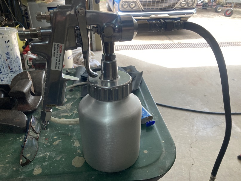

Got some rust proofing done and guards off again to sort out alignment,
New high quality chinesium rust proofing gun, worked once so far so good !
Weve all had to do this before !!!
