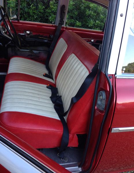

Seat belts are done for the front seats.

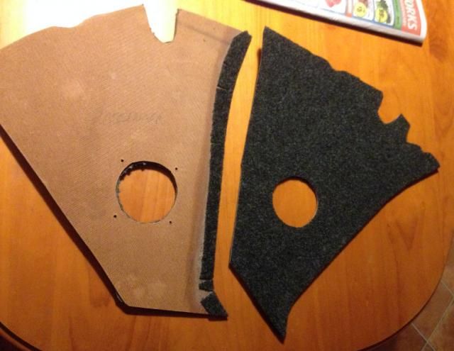

Picked up a old radio, it is complete and working, but I pulled off the face plate to check for alignment.

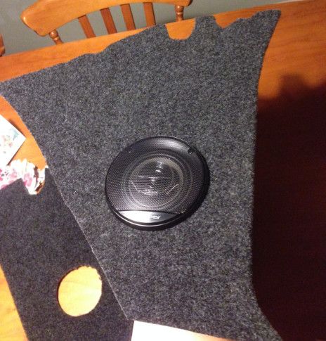

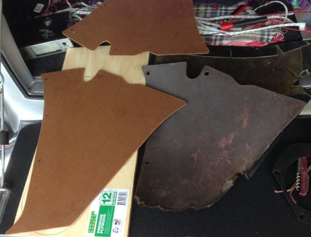

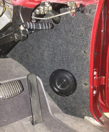

Now onto the front speakers, which I ended up mounting on the kick boards.
Made up new ones so I didn't have to cut into the originals.
Added some 4 inch 200w speakers that seem to allow a good space away from my feet.
All done, however I need to pull the passenger side off again as I still haven't connected the wire to the back of the door light switch.

And the wife is a little happier with seat belts re-installed in the front.

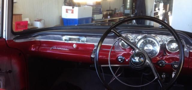

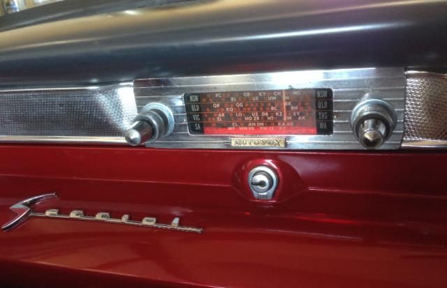

I wanted a nice stereo for the wagon, and ended up with a 200w, 4 channel, USB and aux inputs, full remote control, Bluetooth and full iPhone control (No CD).
The Radio (or at least what looks like the radio
) is finally installed.
It may not be a Holden original but it looks period correct and makes the dash look complete.
This is what I used.
Cut up an old radio frame, and utilised some surplus Volume and Tuning dials.
Took a while to shape the frame to fit correctly into the dash and use the face plate.
Moulded some black plastic to fit into the frame and used a paperclip as the station marker.
Also mounted a red led strip inside the unit, across the top.
All connected up, but I may need to paint inside the bottom so the red light doesn't reflect so much.
I thought the red would go best with the theme for the car.
I've run the power to the on/off switch, and have attached a power wire coming out, so that the "Real" stereo can be turned on/off via the switch.
All the rest will be hidden up behind the dash, and controlled via the remote control.
Now I'm just waiting for my son to do the final installation of the new stereo.

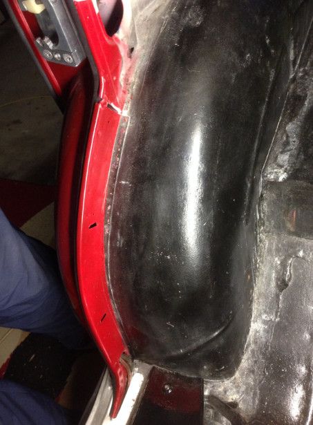

After finishing the radio, I needed to finish the rear speakers.
That meant finishing the wheel arch covers.
That meant trimming back the others to allow for the added thickness.
What starts as a fairly simple task, takes several hours.
I also wasn't happy with the wires running over the wheel arch's, which would show under the carpet.
One side was just the stereo wire and the other was all the normal wiring plus the stereo and another power cable.
Or at least make it difficult to lay down flat.
So I re-routed all the wires though the hole near the base of the pillar and straight through into the rear quarters.
Spent a bit of time getting a wire through first so I could tape and pull the others through.
You can see the wires going into the hole at down at the bottom of the picture.
Still haven't finished cutting and joining the wheel arch area, but It's getting roughly into shape.
