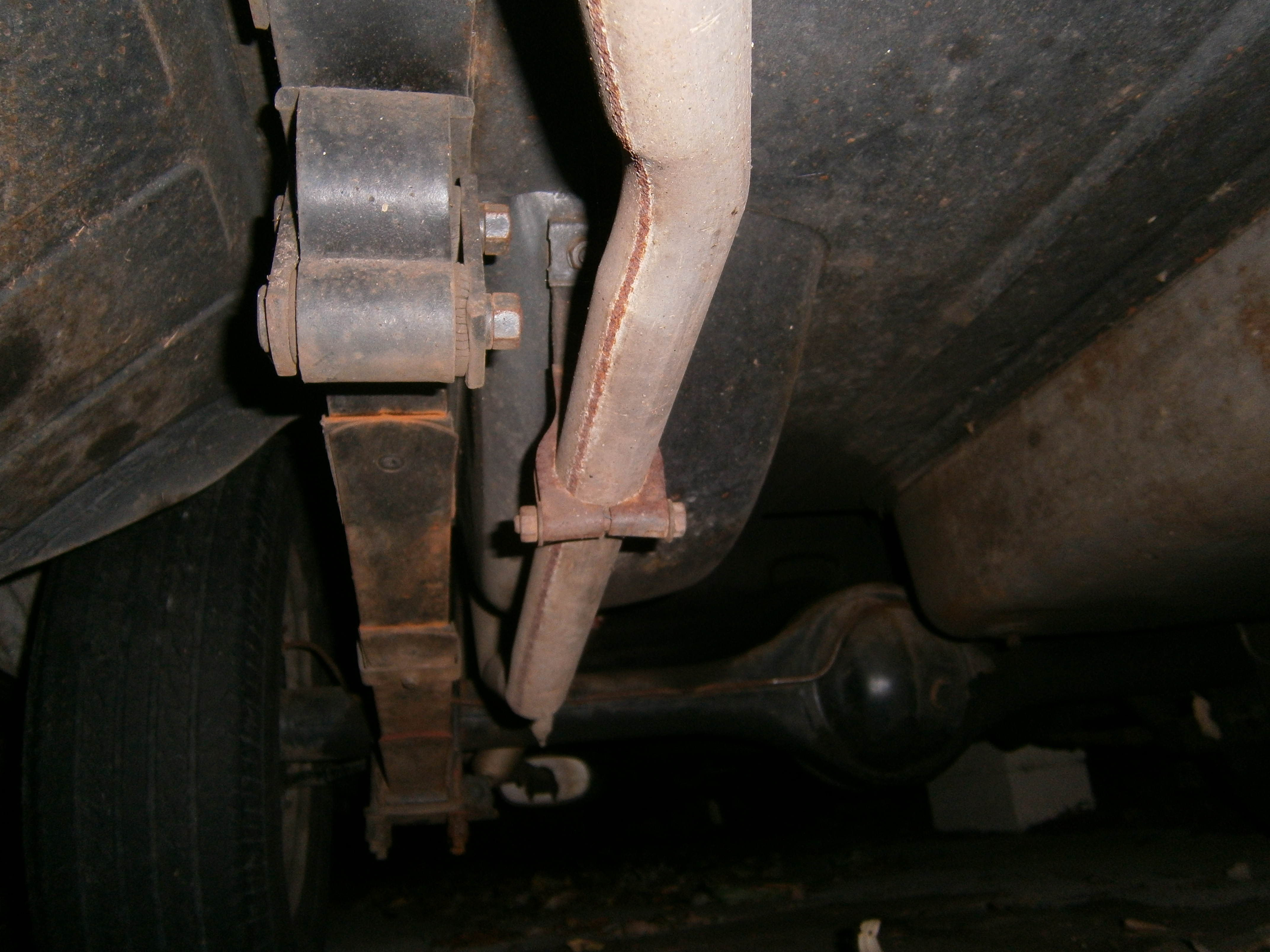

Brett,
You might have to lengthen the right-angle bracket on the tailpipe hanger by about an inch to achieve the right clearance. For comparison's sake, here's the tailpipe hanger of my FC (camera aimed in the dark):
FE-EK tailpipe clamp
The tailpipe clamp is this amazing folded sheet metal arrangement which grips the rubber insulator on both sides. The tailpipe sits about an inch below the rear bumper, and there's about a hand's thickness between it and the boot pan behind the spare wheel well.
Re: Wilma FB project
Posted: Wed Jul 28, 2021 8:42 pm
by Brett027
Thanks Rob. They are pretty much the clearances I currently have. It's hard to tell from photos I guess.
