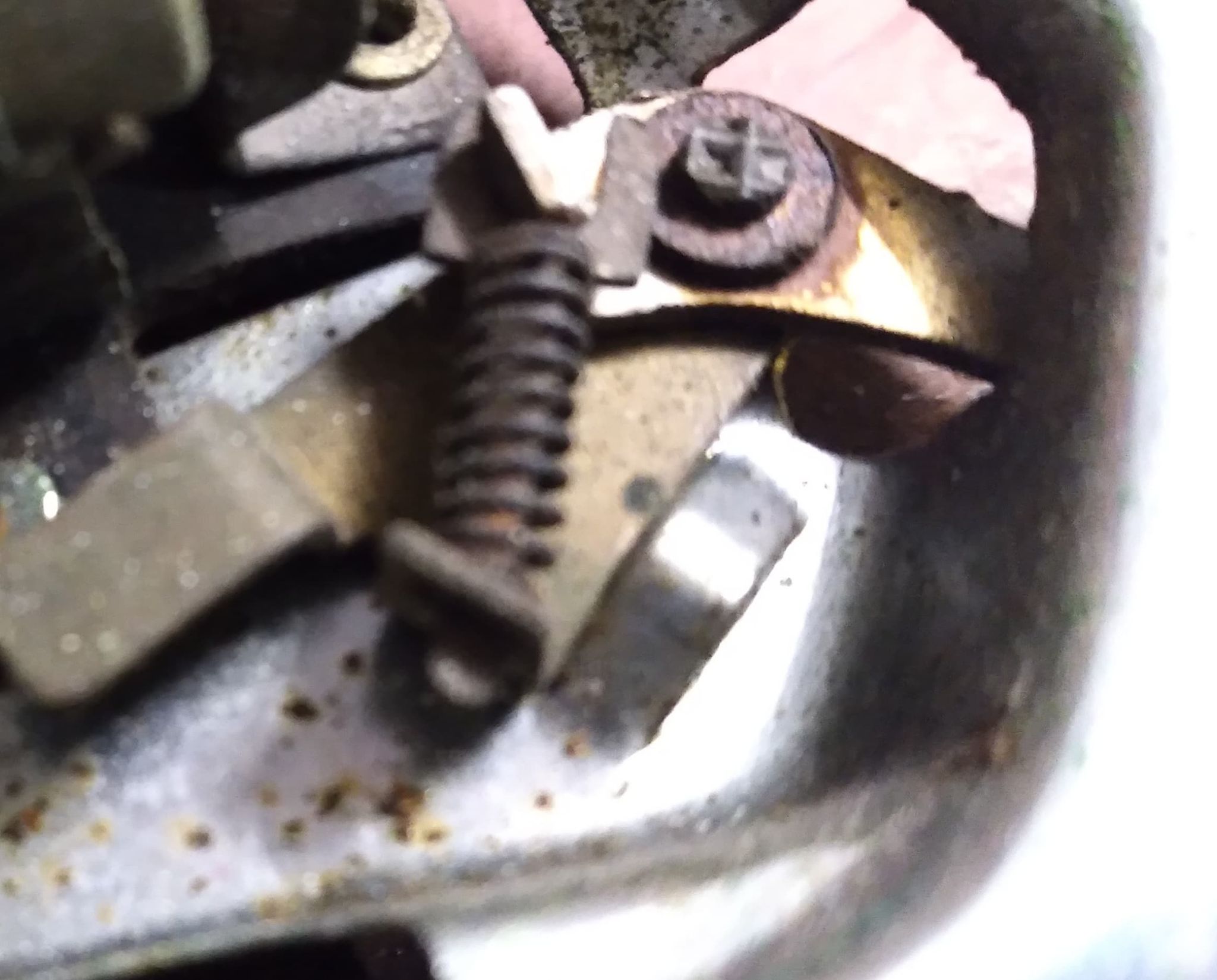

FbSTDwagon wrote: Thu Mar 17, 2022 7:49 am
Mick if your interior light is complete just leave it complete mate, no need to strip a small part out and then be holding a light that don’t work.
you can have the whole lot if you want it just send postal address
