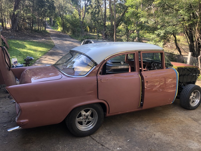

Like Harv says more like a car when the windows are in. Might have to rig up the hot water in the shed to finish rubbing back and buffing, Cold days I hate em !!!

Looks great Greg no long now.
Re: Chev EK
The more that goes back on, the better that colour looks. The original colours are really beautiful on the body shape.
