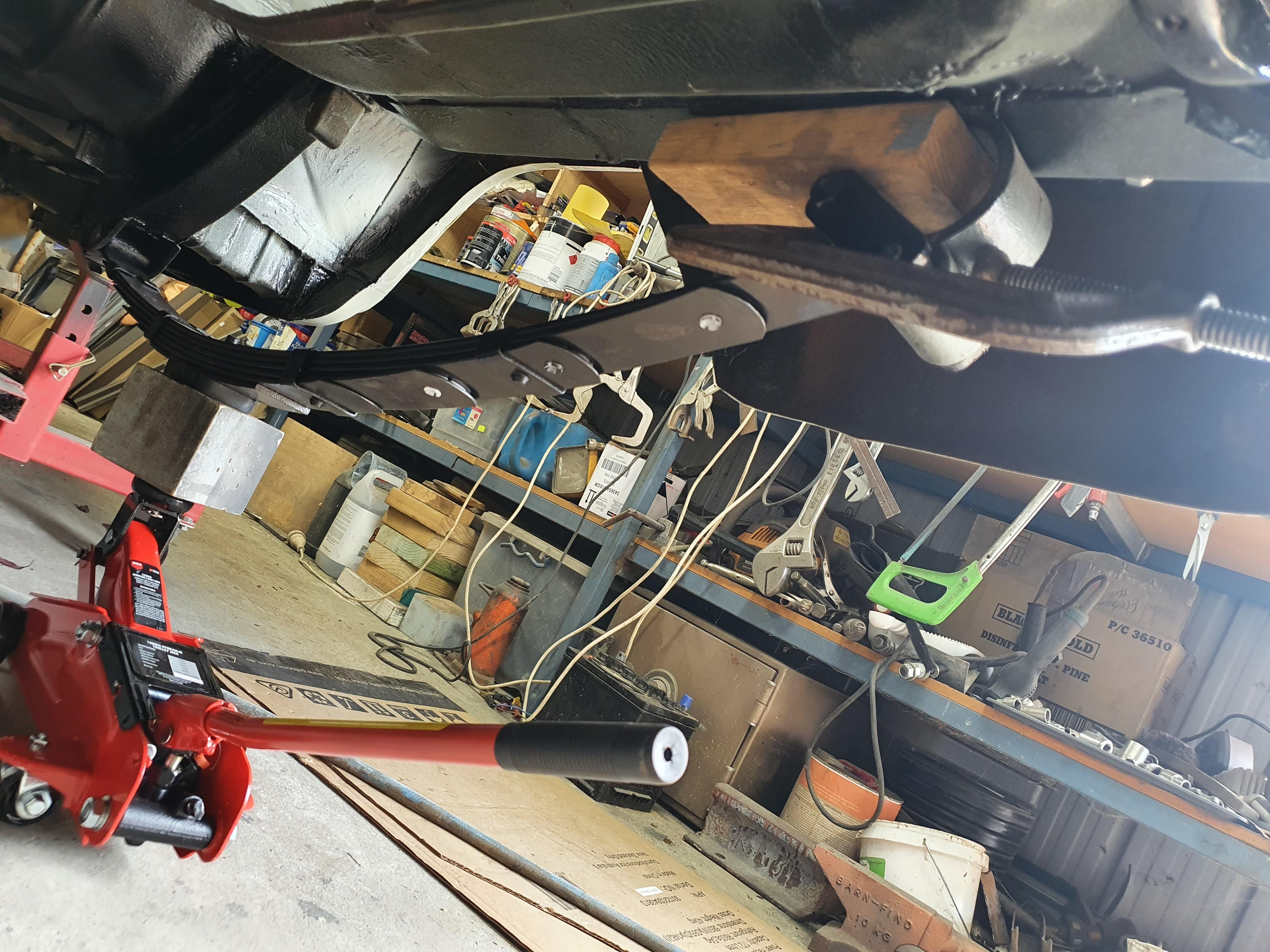

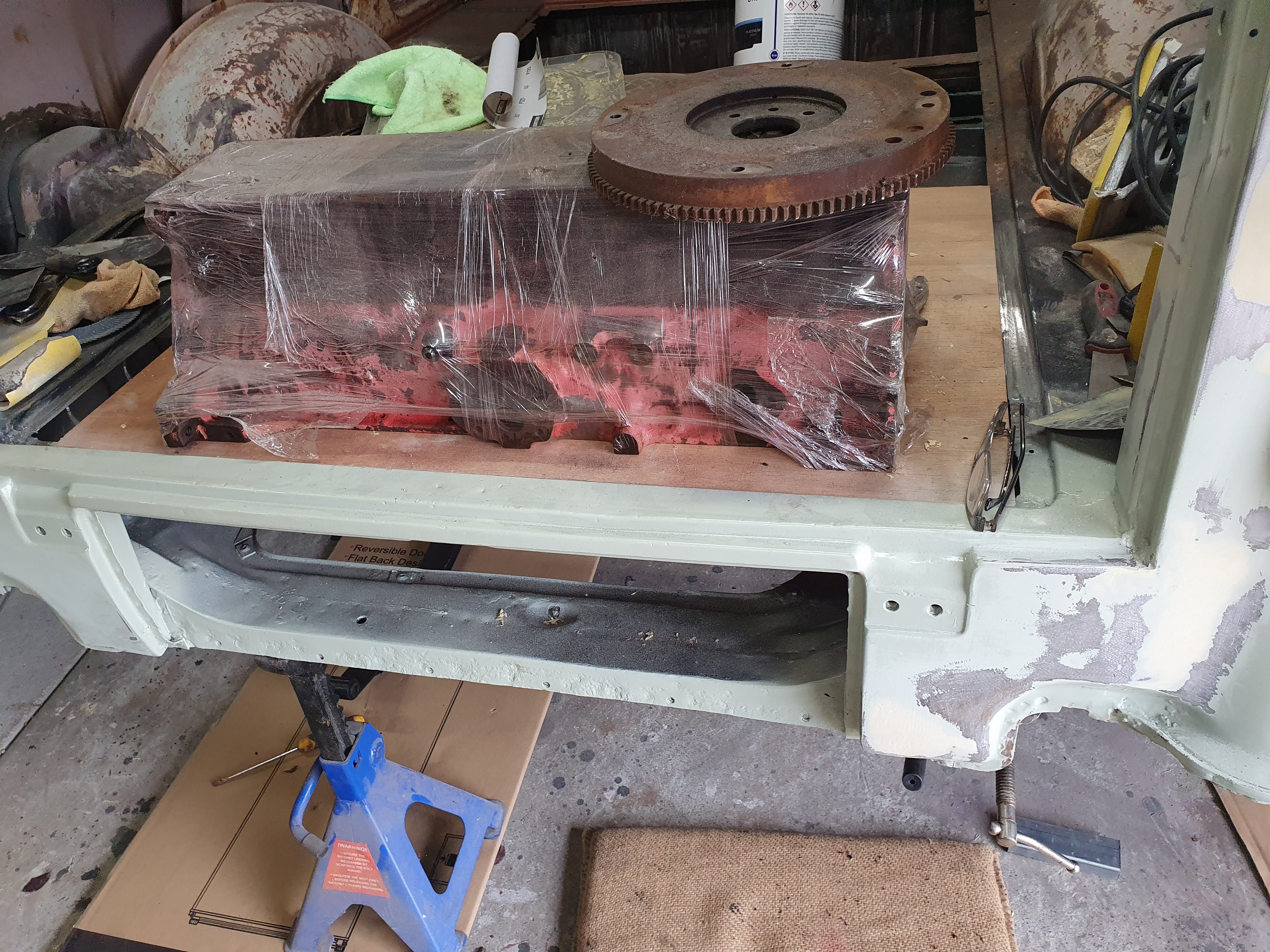

Mucking about doing odd jobs while the weather improves a bit for body work. Cleaned and painted rear springs and HR rear axle yesterday. Nothing flash, just GMH chassis black.
Putting rear springs back onto a bare shell is a bit of a struggle on your own, so for anyone who's not done this before - a couple of pics. Used Orange Betty Dave's spare engine block and a grey flywheel to add a bit of weight, as when you put the pressure on the spring to compress it enough to fit up the shackle bolts the back end just lifts up. A clamp and trolley jack were the muscle. The clamp is necessary to get the two shackle bolts in line enough to put the tie piece on. The jack stand stops the front of the car from coming up when you takes the pressure off the spring and the dead weights make the back heavier than the front and wheelies occur. Obviously this is not necessary if the front end/ engine is on the car.
