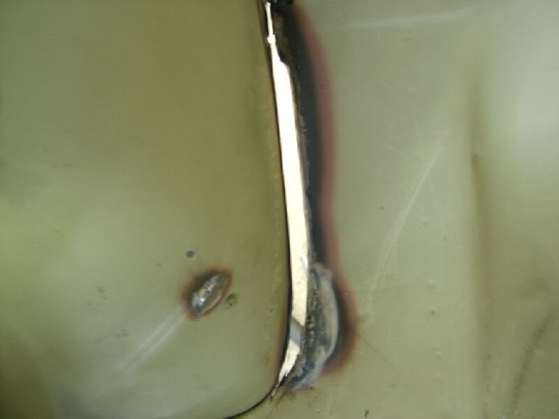

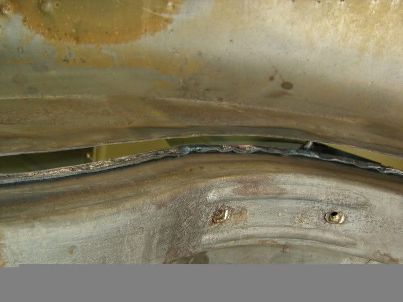

Posts: 2689

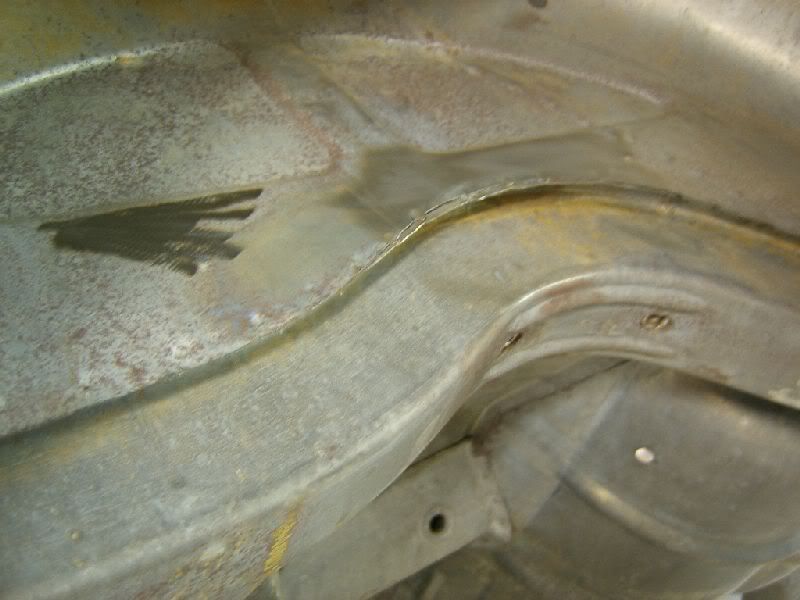

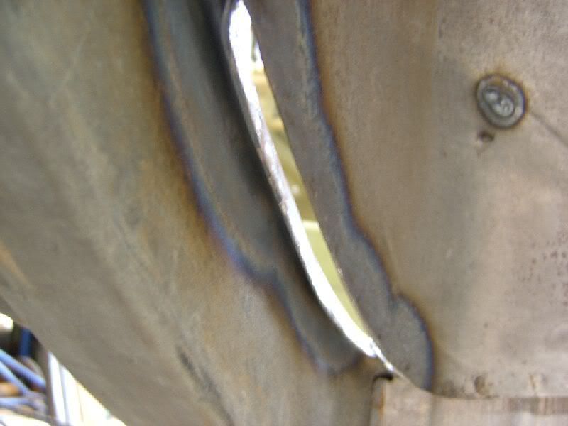

Mal, and anyone else interested
I will just pump the inner across and flatten any high spots, the tyre shouldn't travel all the way up so I dont think its necessary to move the whole tub across.
Here are some clearer pictures
After cutting the tub away from the Chassis and then bending the lip over
Image.
The now gap which is approx 12mm will be closed when the tub is pumped across.
This mod is legal in NSW because the chassis rail has not been moved at all.
Although it dosen't look much it is the difference between the tyres rubbing or not. My wheel arch is now 300mm from the tub to the lip of the quarter ( I have pumped the guards a little as well ).

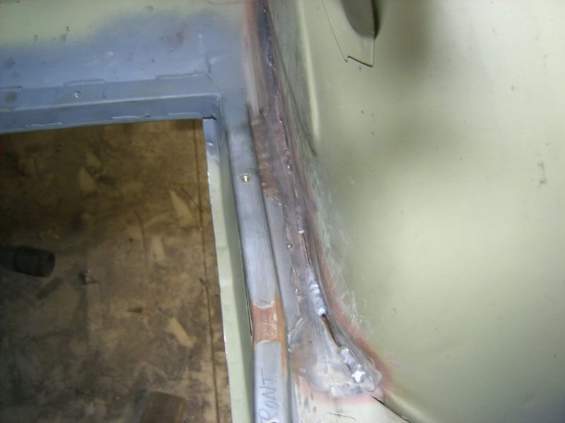

Posts: 2689

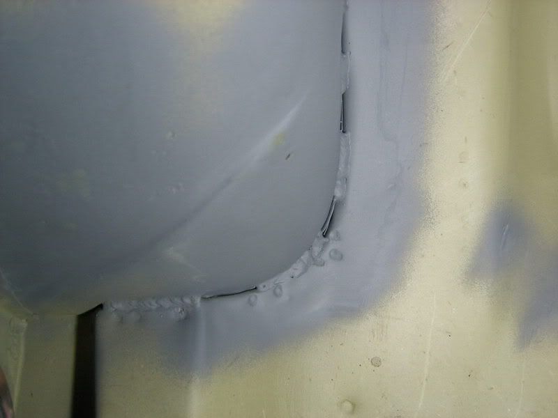

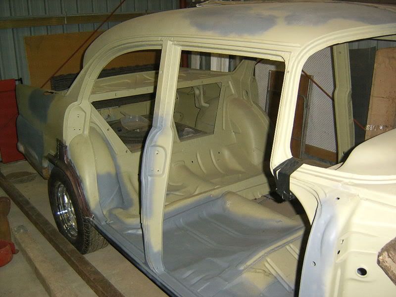

Guys and Gals,
I have completed the tub jobs yes I did say tub :lol: :lol: :lol: .
The inner tub was stitched into place and the new edge fully oxy welded.
Image.
Total amount gained just under 15mm. I originally had just 15mm from the tyre and inner tub but now its 30mm. Im hoping this will be enough for the tyre not to rub. I suppose it depends on how hard it gets driven! :roll: :roll:

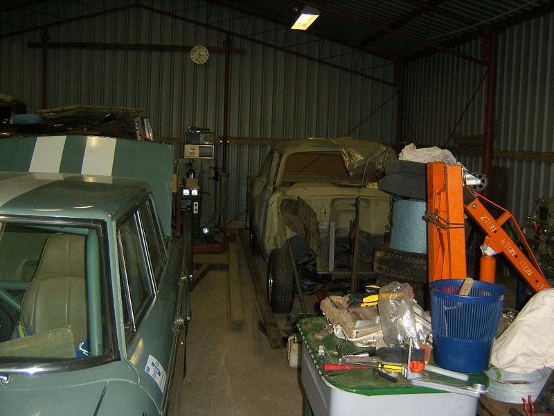

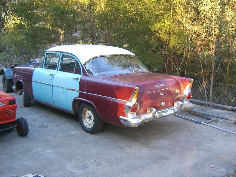

Ok Guys,
Im almost settled in to the new house just need to sort the garage a little more and I will back on the car.
Heres a sneak shot at the shed.
The car at present
Finally got hold of a parts car at the right price. Dont be fooled the car is worse than what it looks (rust).
Will update in the next month or so. I know have 2 roofs MMMMMMM! :idea: :idea:
