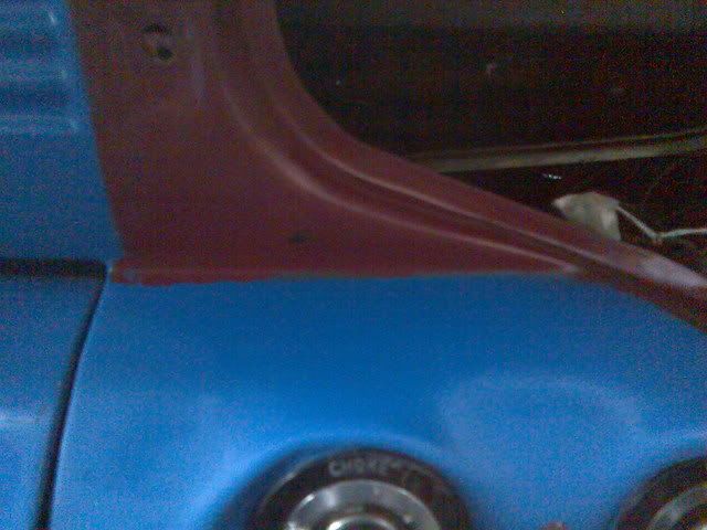

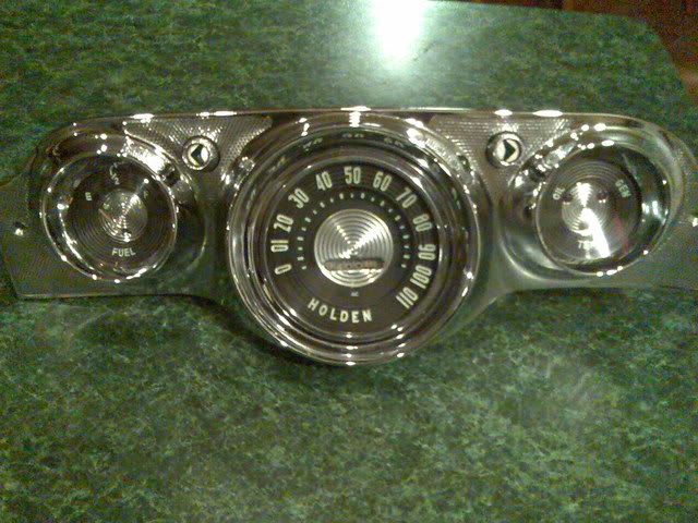

Wet weekend, did some more minor work on removing the inside. Only had an hour to spend.
Got the dash out, and chrome dash strips off. I think I found the original colour.
Similar to what will be going back on it in the end.
Gave the Instrument panel a quick wipe, and it came up pretty good. Haven't polished it yet, but It will be OK. Only a couple of pits, mostly fish oil cover. Dame that stuff is an absolute pain to remove :evil: , but does a great job of protecting things :D .

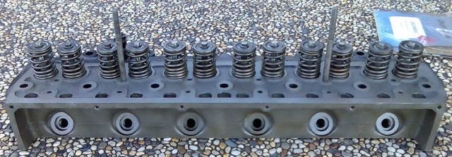

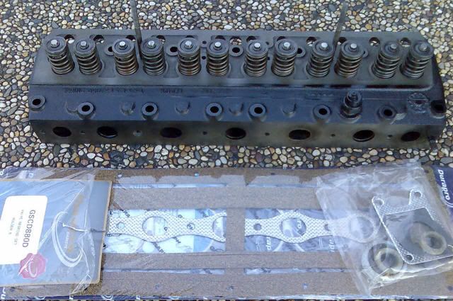

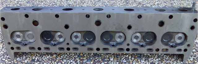

OK, I have finally got the head back. :D
The delay was in getting the exhaust valves, which I finally got off EvilBay.
Total cost was $533. Included full valve grind, Pressure test, new inlet valves, unleaded upgrade and new gasket set. Looks good, but won't really know for a couple of weeks until I get the time to put it back together. Very happy with Barry the guy that did it, very helpful and knowledgeable. And he fixed up the push rods and plungers?
The Gasket set was only $48.20 +GST. I thought that would be a lot more expensive. Full set, Head, Side cover, Fuel, Water, side plate, Exhaust, the lot.
Just have to wait and see if the block had any issues. :roll: :roll: :roll:
