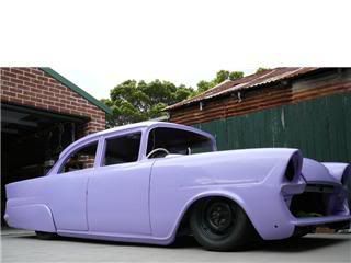

My bagged EK - Final trim fitted......
EKK001 wrote:Im going to fit the Cruzin skirts too.. i havent had them fitted with the bags yet.. probably wont be able to see the back wheels at all.....
:twisted: :twisted: :twisted: C'mon already, do it do it do it!!!
It'll look like its floating! 8)
Keep us updated, I can't wait to see it on the road.
With your door poppers do you have a mechanical means of opening them from the outside (simple yes will do, don't need to now where) as this is a hot topic in Vic at the moment. One of a few items Mr plod is cracking down on, the other being no gaurds on Hot rods :oops: .Reason being no easy access for rescuers in an emergency.
As for the copper lines the reason they are no good is under pressure copper flexes (or in this case expand) and will cause a poor brake feel and pedal. This is what I was told many moons ago so it could be a bit of a wives tale. Although it does sound right as copper is a light metal as such.

The short answer in regards to the doors is yes, but not yet....
Havent organised that part yet....
A lot of newer cars have door locking systems that lock automatically when you begin driving..
And falcon wagons have a weird setup that doesnt have locking barrels on the passenger door and rear doors... hard to explain but you cant open the other doors unless you press the central locking button inside..
Emergency crews are gonna smash your windows regardless if you have door handles/locks to get you out... it can be hard to explain that to authorities though....
Im hoping i dont have to overcome any major hurdles with it....
Will try and dummy fit the skirts this weekend and get some more pics up..

EKK001 wrote:A lot of newer cars have door locking systems that lock automatically when you begin driving..
Apparently most new cars also have an overide in an accident that will unlock all doors. This comes from a mate who is the Australasian Production Manager for Toyota. But either way first people on the scene are always emergency crews so smashing there way in is the likely outcome.
Either way your ride is awesome, can't wait to see more shots as it goes back together :twisted: 8) 8)

As for the door poppers, i have a letter from the RTA saying its ok as long as i keep all the original interior mechanisms and handles operational..
DAD fitted the skirts this morning... look great when its down low... DAD was feeling a bit left out because i wasnt giving him credit, so THANKS DAD! ha... there you go...
Also a pic of the gauges set up... Im pretty happy with the way its all coming together now...
