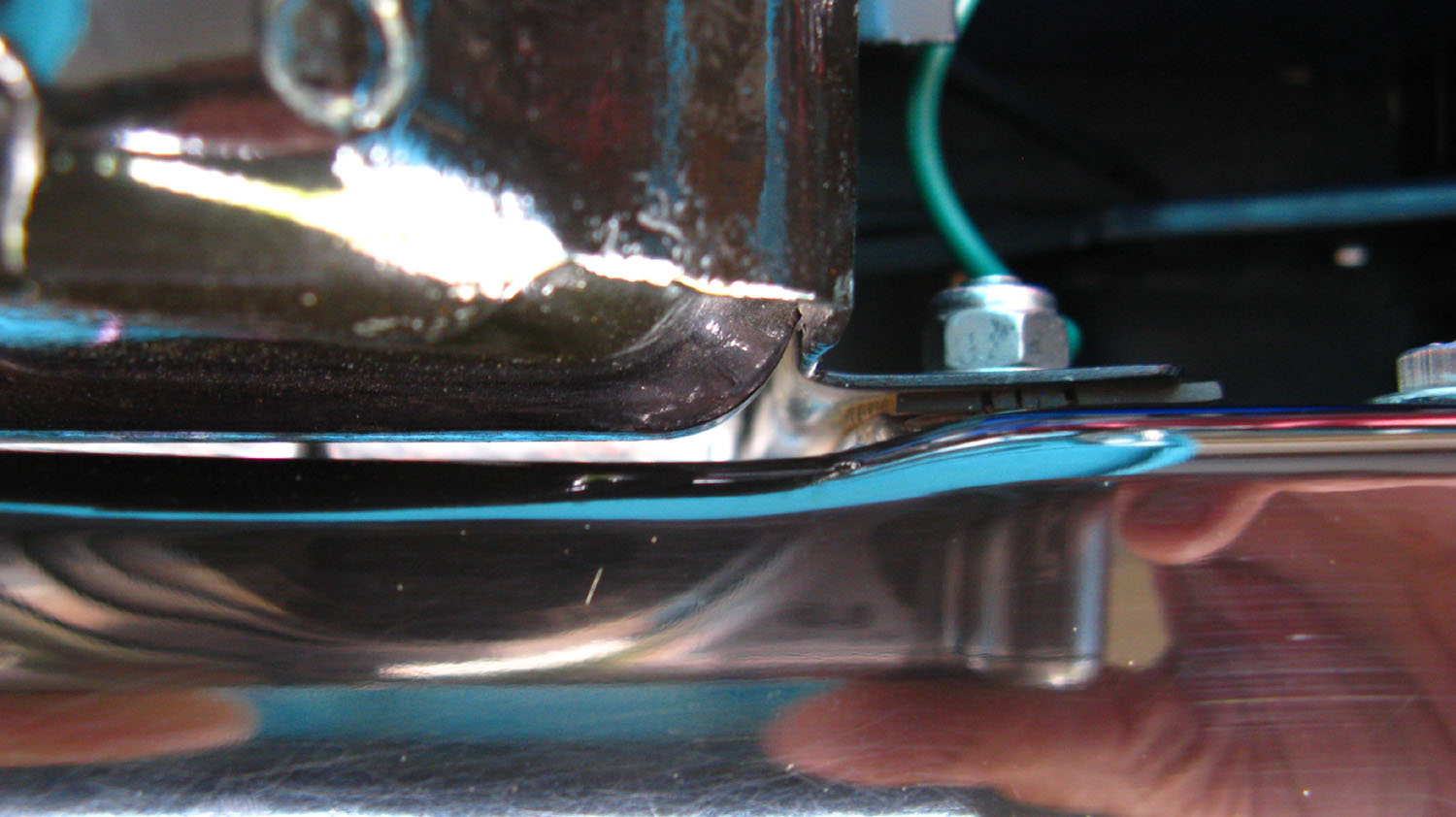

To start off with - you seem to be focused on the lower stone shield part of the baffle... in this pic, you can see how I "bent" this forward to create a gap between the radiator and shield...

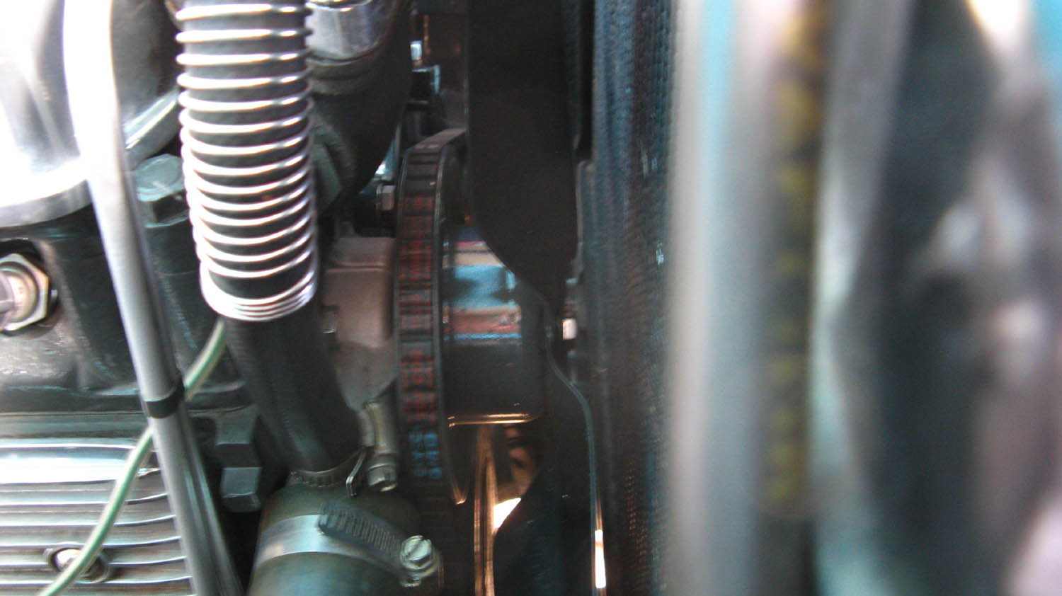

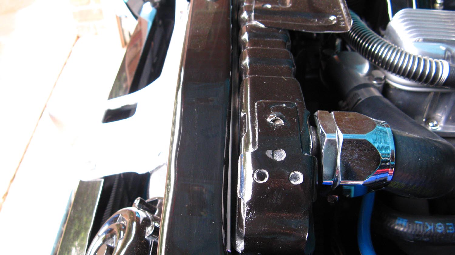

I had to mount the radiator forward to get clearance from the fan to the radiator.... as you would appreciate, engine thrust would force the motor forward, so I needed as much clearance as I could build into the fitting of the radiator....
I ended up with enough to "just" get my little finger between the back of the radiator core and the water pump/fan bolt heads...
002 fan to radiator mail.jpg (122.65 KiB) Viewed 1073 times

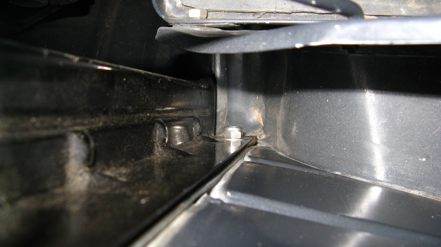

As promised, with reference to you wanting to effect a "factory" look that would not attract undue attention - I cut out small triangular infills for the ugly openings where I had to cut the baffle on both sides to fit the wider radiator - these were welded in and ground off...

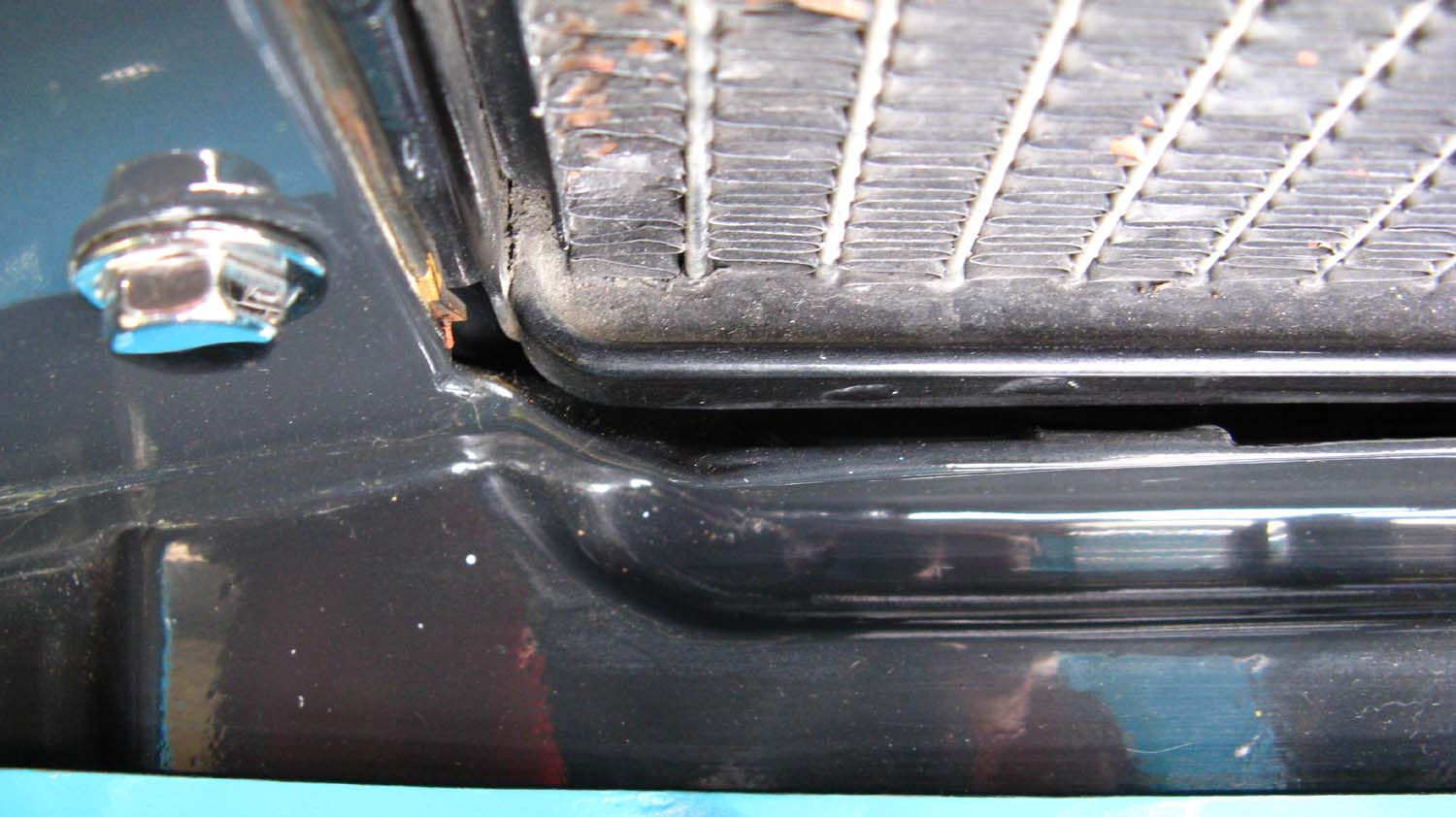

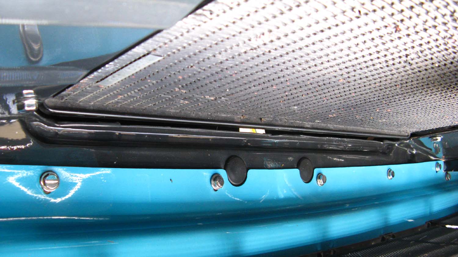

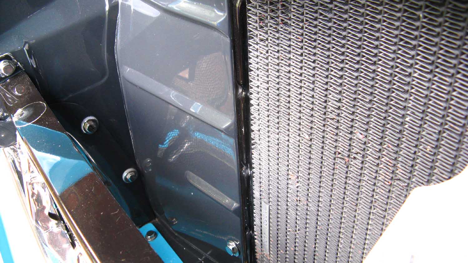

Getting back to the lower section of baffle/radiator - this shot shows the clearance I effected between them, it took a bit of beating to push the shield out.. but I got there. From memory, I did push it too far and split the metal... but welded it back together again. It's pretty tough metal down there and will take a fair bit of hammering...
005 radiator lower clearance mail.jpg (138.08 KiB) Viewed 1073 times

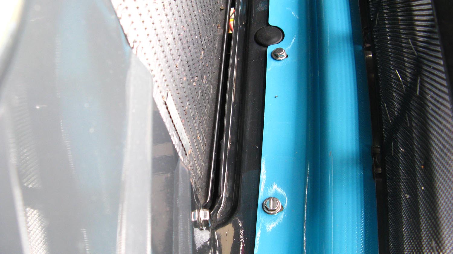

Here we go to the upper crossmember. I had cut away the rear, top and bottom of what would foul the radiator - and welded in plates then ground off the welds. This pic shows the second attempt at doing this - I learned to stitch weld the second time and kept a close watch on measurements.
In these pix, you can see the clearances I effected so that the radiator would sit inside the outer line of the original upper cross-member....
009 upper crossmember lh rear radiator clearance mail.jpg (166.66 KiB) Viewed 1071 times

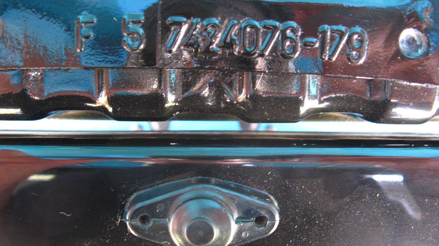

In this pic, we are looking down at the gap - the part number for the radiator I fitted is also shown in this pic.
011 upper crossmember radiator clearance mail.jpg (117.05 KiB) Viewed 1071 times

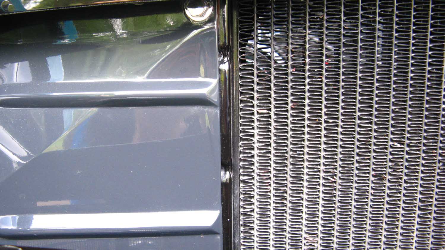

In this final pic, you can see the total width of the lower shield clearance. It was always my intention to attempt to create an illusion that this modification was perceived as it being factory....
