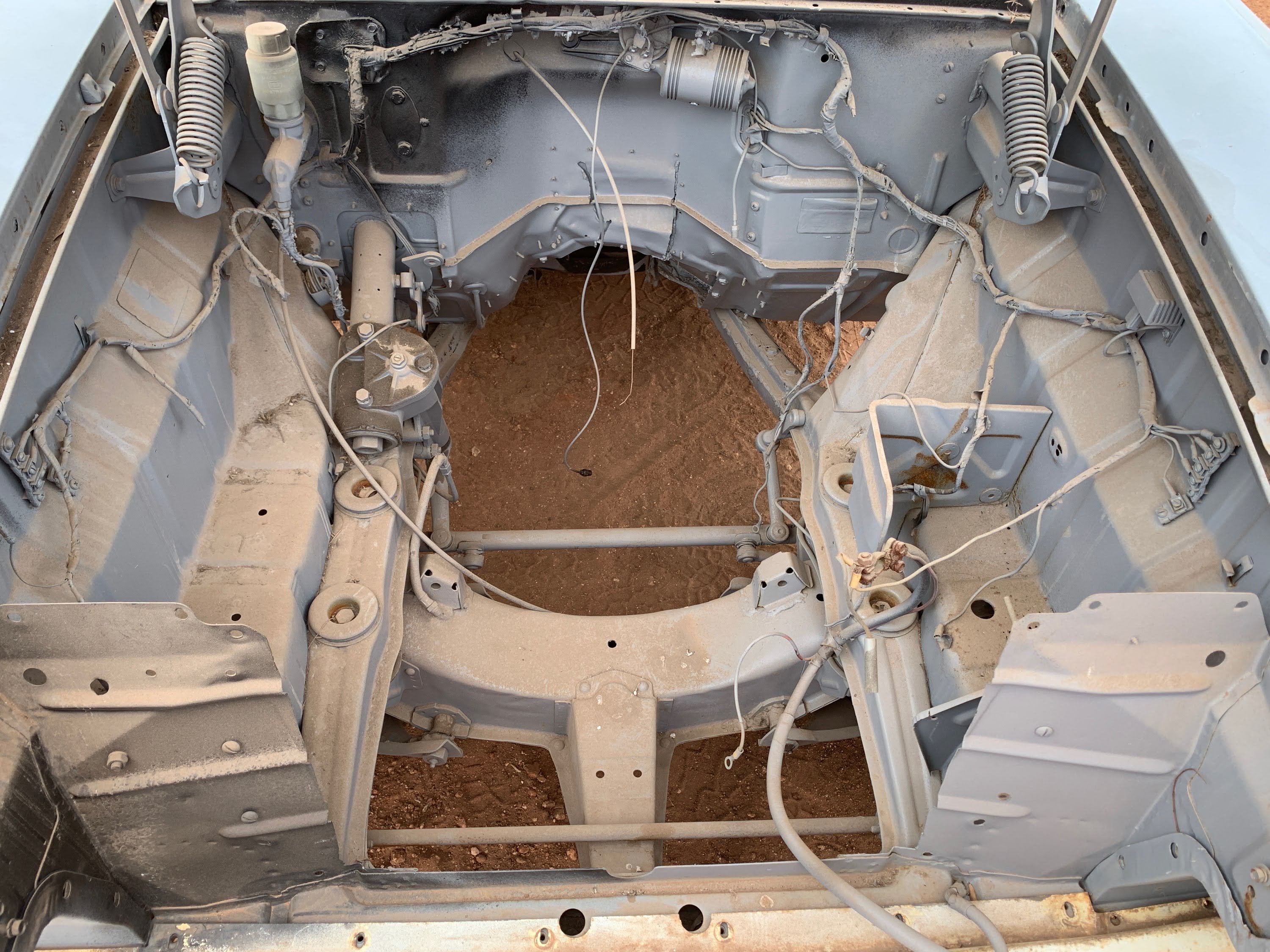

- New ute firewall nasties
- 632202926.jpg (1018.97 KiB) Viewed 745 times
Re: Project 2.
Jesus mate looks like they really hacked at the firewall

Not to worry Neil, easyish fix
. Does make you wander about what people are thinking when the do this stuff though.

Mate Franks tunnel was pretty similar looked like they had taken a BFH to it and when I went to cut it out I found a big thick doubler plate they had welded in, could get the aftermarket tunnel to fit up to the firewall nicely so had to massage it in.
Like you said makes you Weber what sort of death traps were getting around with really bad "upgrades"
There were photos of mine in my build but not sure if they are still there.
Neil.
Neil.

Unfortunately a heap of your pics are gone Neil, but while having a look, found WOT's ute build and some useful photos in there. This forum is such a wealth of informative stuff. Fortunately this is Project 3 "Project Last" and is a good few years away- plenty of time to cogitate over options and gather bits.
