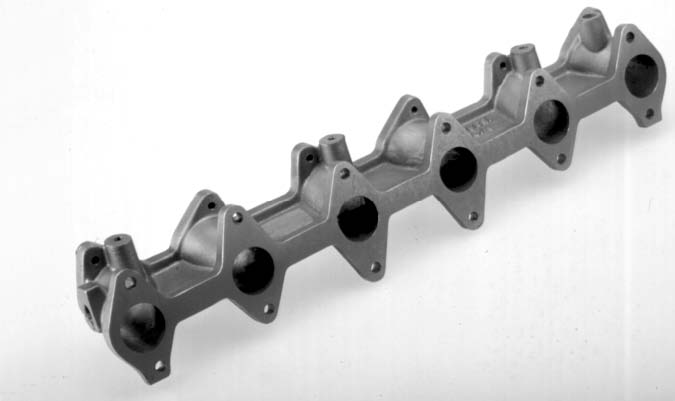

Agree - looks like triple DCOE's. I don't think any of the Falcons came from the factory with triple Webers, but thought I'd ask (my Fraud knowledge is slim).
Because the manifold is made of three separate throttle bodies, you could use one throttle body for a car with only a single Weber, two throttle bodies for twin Webers etc. My guess is that the Falcon that these came off had an adaptor like this one:
Ford 250 crossflow Weber manifold.jpg (19.79 KiB) Viewed 17519 times
So not really a McGee Falcon setup... more like a McGee Weber setup that someone has cobbled together with angle iron to suit a Falcon.
