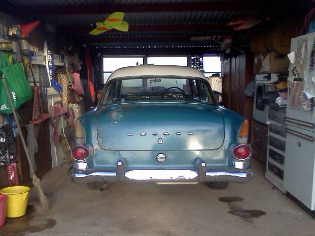

Had an awesome weekend, cleaned out a shed yesterday so I could finally get my old K Bird locked up.. It has spent the last couple of weeks in another shed that didnt have doors. Gave her a bucket bath and gave the rear end a quick polish ....came up ok! Looking forward to polishing it all up now its out of the weather.
Also found the rear airshocks I put in 20 years ago still work well!
Hope to get the old wheel cylinders out this week and buy a clutch slave.
Diggin it!
Diggin it!
