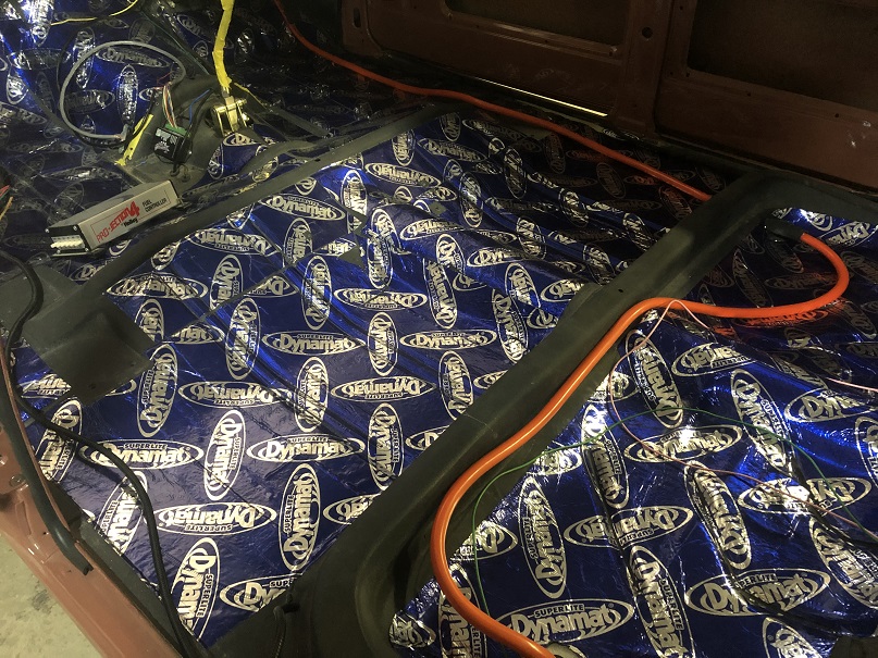

Morning guys,
This was yesterdays effort, the dynamat is not a 5 minute job took me most of the day. Plenty of shapes in the EK floors, Holden were still engineering the floor pan for strength back in those days.

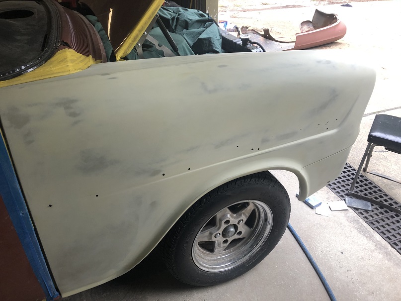

First rub down of the guard, not so bad might get away with one more hifill and rub.

The guard looks very close, Greg..... just a few little lows there that I can see.

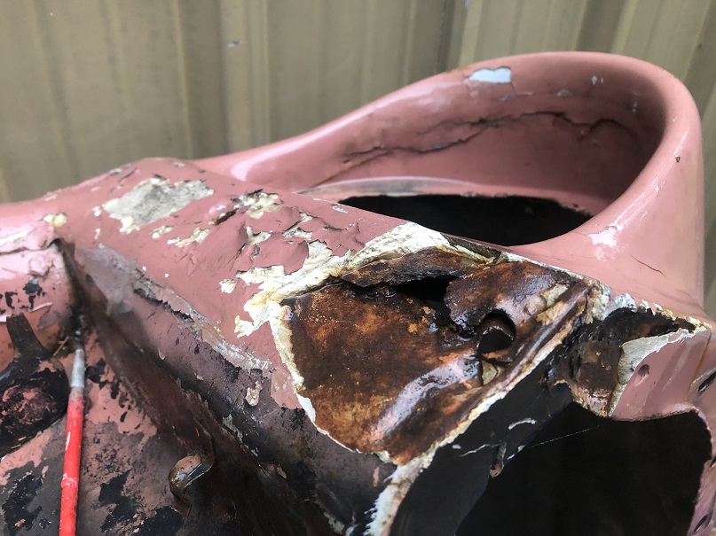

Good observation, I used the guard as a template for the badge drilling on my new guard. This guard was on my car and looked fine for many years until the bubbles started !! It was repaired back in the 70's by a reputable panel shop after my grandfather had a mishap one afternoon clipping another car at a stop sign.
A bit of proof that rust does start under filler although there is plenty of moisture traps in this part of the guard, and plenty of bog as well.

I'm guessing that bog was viewed as the wonder cure after its introduction. Sledgehammer the panel out, slap the bog on, sand it back, paint. The customer isn't Clark Kent, and can't see what's beneath.
Did you say "reputable panel shop"?

Greg, the "70's".... we were learning a lot about bog back then...
The beater's choice was the traditional panel putty.. which was simply very thick paint with some extra fillers in it....
If applied in copious amounts - it shrank.... or worse - cracked or split open.... it was a stop-gap filler that sort of sat somewhere in no-mans land between the traditional lead filler and the latter plastic..
Plastics, back then were yet to earn a reputation - many feared them, even joked about them.. but, as we know today - they quickly became the preferred filler and quality developed over the ensuing 50 years.... and we still use them...
Sadly, back then - not a lot was known about preparation for ensuring the plastic filler would stay "stuck" to repairs...
As we very well know now - any traces of rust, dirt or anything "loose" was a time-bomb in waiting...
Once the filler broke away - the dreaded rust began to explore and geographically map the unknown world.... to far reaching sympathetic reaches .... as shown in your pic...
We also did not know about attack from behind our own lines back then either... failing to seal the other side of a repair allowed attack from mounting holes and voids in the metal joints at rear....
Your pic reveals all of this...
At the end of the day, even a "reputable" panel shop had a philosophy - labour hours vs repair longevity.... back then, depending on the state of the rest of the vehicle - the repair only had to outlast the likely demise... and a relatively quick process of rough clean, apply, sand and paint was the usual....
If they had incorporated just one further step - the likelihood of the damage shown would more than likely have endured.... and that stage was to de-oxidine and then seal out joints/voids and the rear of the repair... in total, perhaps another 15 minutes to the job... but, they didn't.
It is for this very reason, that I prefer to do my own body work where needed.... I believe I have an appreciation of the outcome - and commit much time and effort to such repairs and refurbs to ensure that I need not revisit the area....
Finally, I wouldn't throw that guard onto the scrap pile yet.... it looks grim, but with a MIG or even TIG for smaller areas - wonders exist which can make that guard serviceable .... with the exception of panel repair sections now available.. many folk in this forum would snavel up this guard if push came to shove as a result of a prang... We see this with dog-leg repairs which are effected to literally "missing" metal - only holes to work with.... this guard is far from that stage...

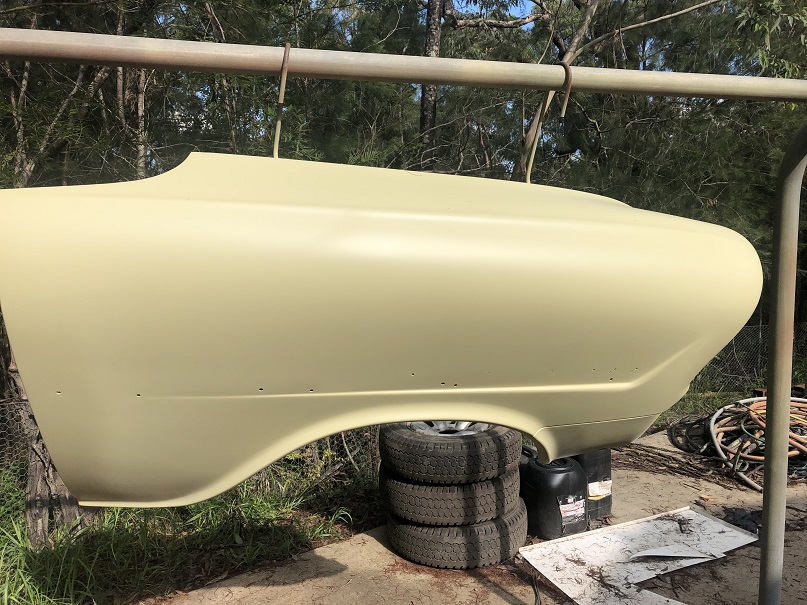

So today was a nice day and I decided to spray another coat of hi fill over the last rub back.
Hopefully this will be the last !!!!
This guard has taken a bit of work, steel repairs deoxidine then epoxy primer. Skimmed with filler then rubbed back again and then re epoxied with 3 coats of hi fill wet on wet. Rub number one was done a couple of days ago.
This is the second application of hi fill, 3 good coats and i will let it dry for a day or two then rub again. If its ok then basecoat then clear, same thing wet on wet after flash off.
I can't believe it ! Not one bit of dust, spots or anything !!!! We will wait for the final coat to cop all that no doubt !!!

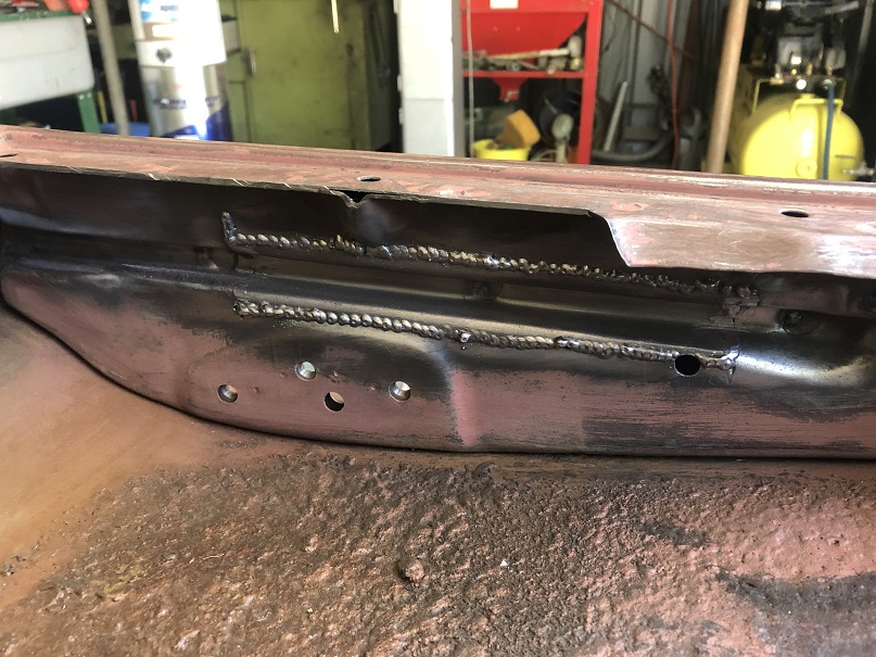

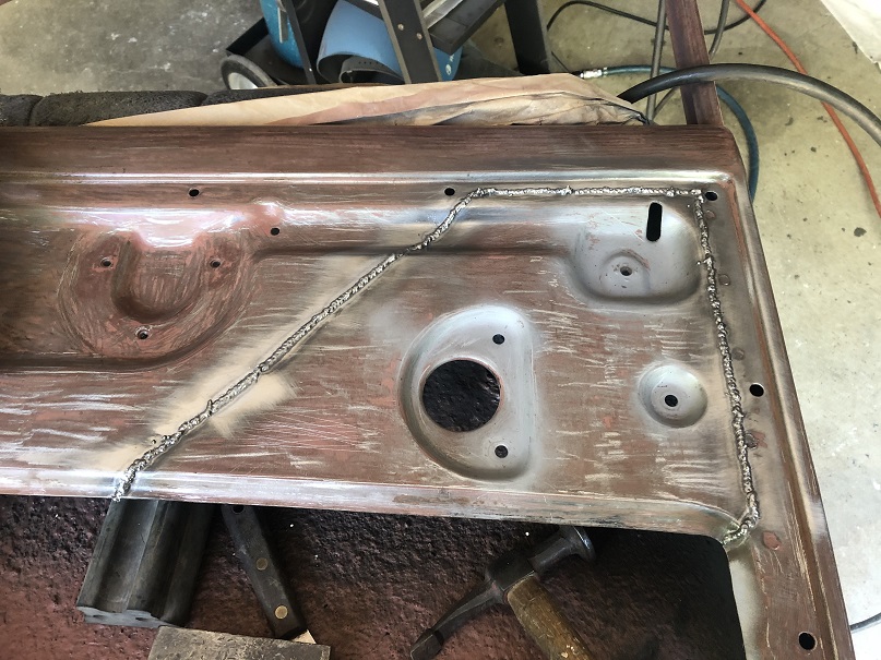

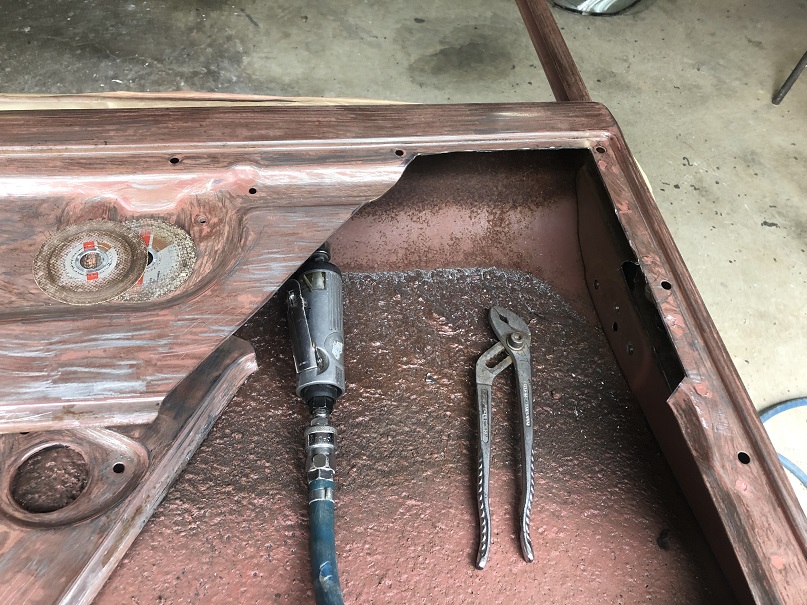

I left this door to dead last just in case I found a better one along the way, but today was the day for rust removal.
The inside channel bugger, had to chop the centre out to get to it.
While it was open I treated inside where its hard to get with rust converter and paint.
Also left a hole for future rust proofing between the two panels,
Anyway time for prep and paint after lunch !!
