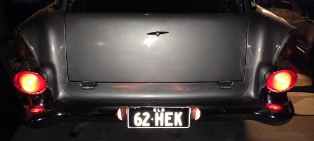

Number place lights working and connected.

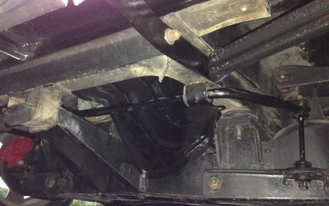

Front sway bar back in place.
Can be a little tricky and it has to be raised at the front.

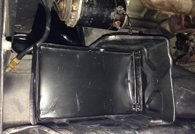

Had to actually make my own Battery tray.
Big vice, Bigger hammer, Lots of cutting and grinding and bending and welding and grinding and painting.
All done and bolted in.
Actually came out a lot better than I expected.

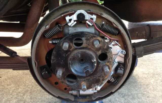

Did a final check on the brakes, and handbrake re adjustment.
All pins and plugs in place and working.

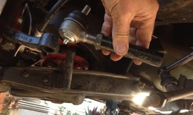

Need to get a steering alignment tomorrow morning and upon check noticed that I really should replace the ball joints.
So out with the old and in with the new.
Otherwise I'm sure I would be told that you need to replace them first.
Steering is now really out and fairly erratic.

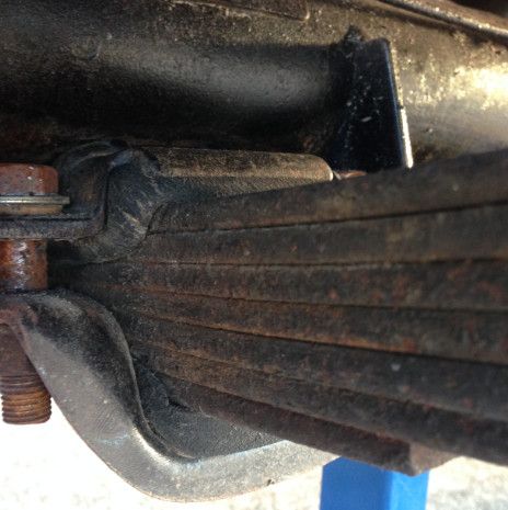

Yes I know the photo shows it still needs spacers.
But I was counting and no wonder it sits high at the back I count 7 springs.
Maybe I can just take 2 out ?

I may be wrong, but your sway bar issue might be to do with the top insulation rubber from the outrigger - does is sit roughly where the EK cross-member outrigger did?
I'll take a peek at mine today and maybe take a pic for you - my bar does run close to the outrigger, but it doesn't touch.
All of this sort of needs doing before the wheel alignment - or if you change the angle of the cross-member, it will likely throw the caster out a bit.
Good move to replace those tie-rod ends.... I did the upper and lower ball joints on mine, plus the wishbone bushes and upper control rod - it made a lot of difference to the steering of the vehicle... unless you take the load from the springs away from the wishbones - you really can't tell if the ball joints need replacing.... the wheel alignment blokes will probably find any replacements necessary.
Battery tray - yes..... grrrrrr - another week of my engine bay project.... well, it would have only been a few hours if I didn't go overboard (again!).
I should have just built a new one out of 1/8th steel..... by the end of it, I probably had...
I tried cutting out the "holey" bits and building up using the mig with brass/copper backing plates... gave up after about 1,000 goes at filling holes (the mig is a great way of finding out where any rust is).
For the small amount left of my original tray - you went the right way, trust me....
Mine ended up with four angled down plates all welded together with a 1" flat section and new wall right around it.
I drilled out the centre of the base to make a 5/8th hole then welded in a drain tube made from a piece of 3/16" thick steel tubing - long enough to reach below the sub-frame skirt.
I cut the base of the tube at an angle to create the same drawing effect of the sump breather pipe on a grey motor.
This tube runs down through the hole in the horizontal part of the sub-frame skirt.
I cut out and fitted a 1 1/2" x 1/4" thick perimeter insulator from neoprene strip to keep the battery away from the metal base.
I lost one sub-frame due to rust down in that corner - and wanted to prevent any battery acid (not that we use unsealed batteries much these days) finding its way to the corner where it can't be seen.....
I can't help you with the rear springs - there sure are a lot of leaves in yours. hoping someone will chime in and help you with options.

i could be wrong, but I thought EK wagons had 5-leaf rear spring assemblies (havn't got my Workshop Manual here in front of me to check, and my wagon is out at Daves for rust paint and panel, though FE/FC is definietly 5-leaf on the wagons).
The MasterParts shows FB/EK wagons as 5-leaf, and that the only early Holden with 7- leaf rear springs is (early!) FX. Looks like yours has been modified at some stage (gasser with the wrong end lifted!!!!!!! :P :lol: 8) )

Just checked the EK Workshop manual and it states.
"Three types of rear springs are used in production, a four leaf spring on Models 215 and 225, a six leaf spring on Models 219 and 229, and a six leaf spring of higher load carrying capacity on Models 2104 and 2016."
It had a tow bar on it and was probably used to haul some heavy stuff around at some stage.
If it's possible to remove a leaf or two that would work well, but I'm sure it's not that easy. :? :?

No reason why not Finny , not that hard a job mate .....
