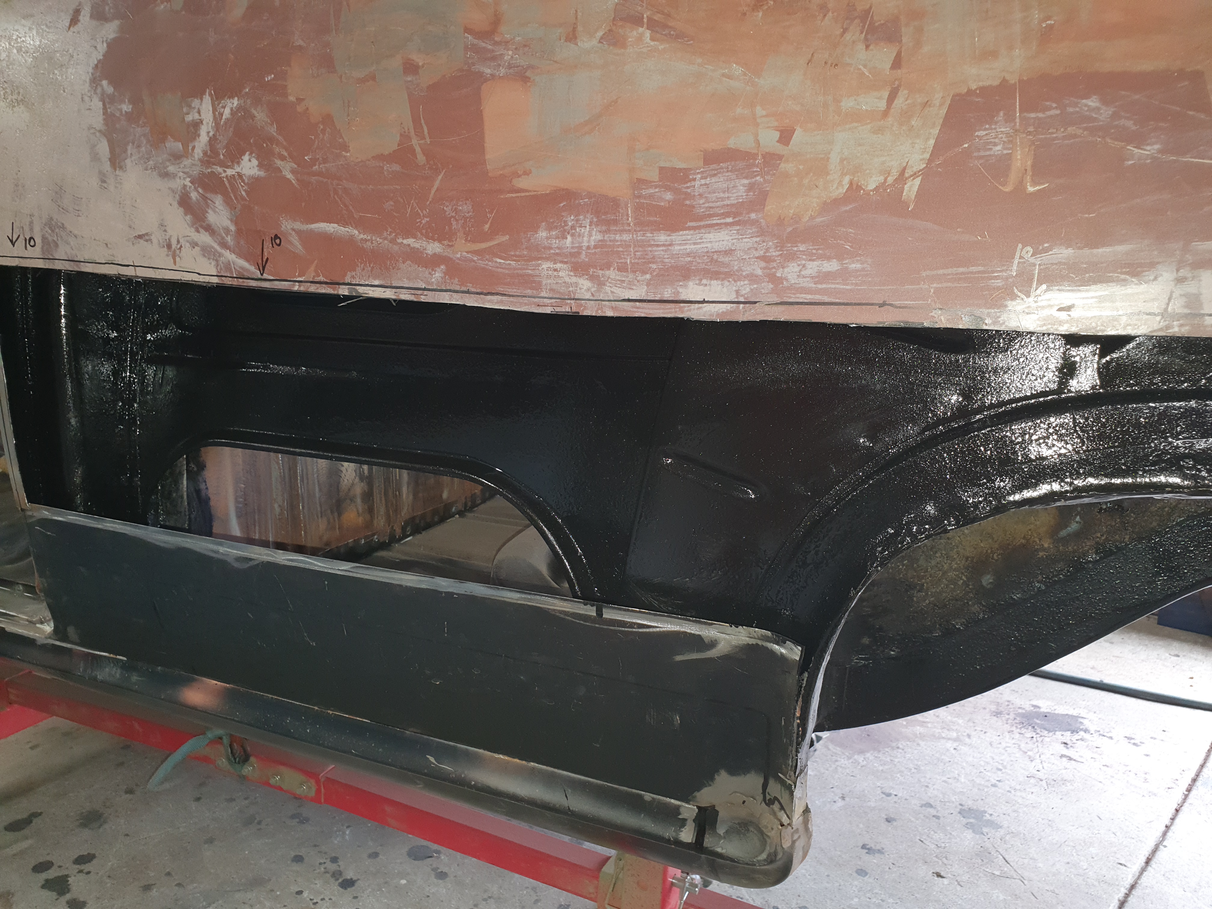

Posts: 2542
Re: Project 2.
Mandrake reporting in.
Made patch for second last panel repair this morning. Prepared area with rust converter and then KBS. Better than new in there nowImage.
Welding later today.Image
