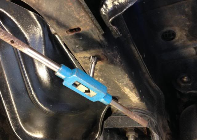

When I removed the stabiliser bar, one of the bolts snapped off.
Drilled it out and recut the thread again.
Worked perfectly.

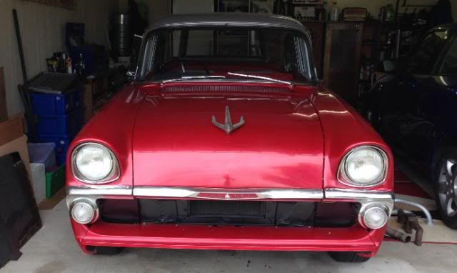

Front end all finished and bolted up.
Had to replace a few wires and connections and fix a few dodgy contacts.
Lights all tested and working on the front end.
Also redrilled the number plate holes so they are in the correct positions.

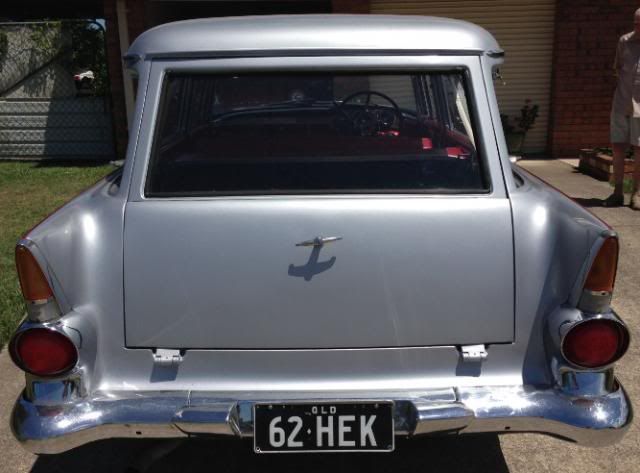

But the bottom of the plates should be level with the bumper.Finny wrote: Also redrilled the number plate holes so they are in the correct positions.
Got to keep Tim Happy.![]()
Re: EK Wagon project - Total rebuild
Watch out the plate police are out again....lucky you painted behind the grill black or you would be in deep s@#$But the bottom of the plates should be level with the bumper.

That's it, why are the police all over me.
No more photos.
The plates are now attached to sliding brackets that allow it to move all the way from the top to the bottom.
I was actually scrolling through forum photos and noticed that only 1 to 10 have the bottom of the plate level with the bumper.
I also didn't like the sharp edge of the plate sticking upwards.

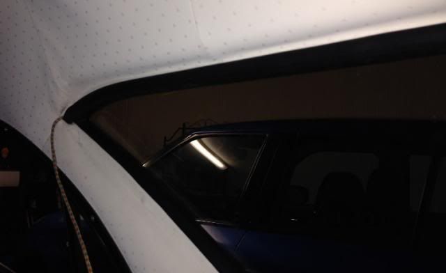

Thought I'd tackle the rear cargo area glass.
The front windscreen was a piece of cake compared to these suckers.
Got to the corner and she would not pull out.
Went in the other direction and same thing happened in the other corner.
Before I could do this I had to attached some extra roof lining material to extend it so it lipped over these areas also.
That wasn't quick or fun.

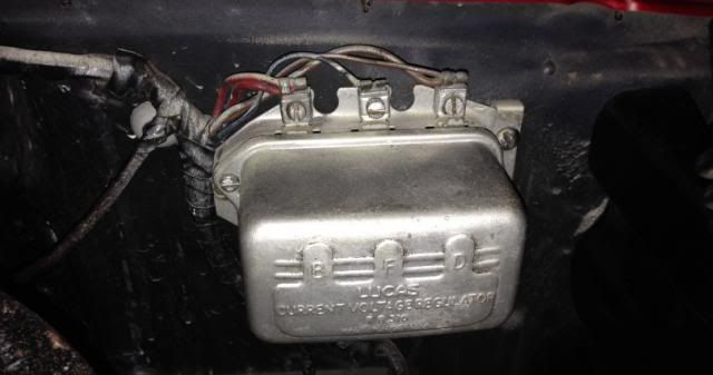

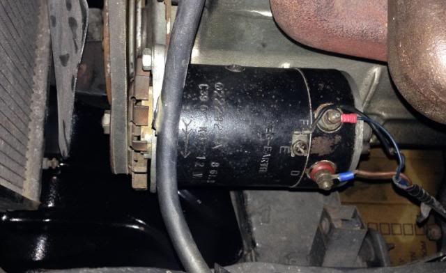

Had my cousin over to look at the generator issue.
He was an auto electrician who did 12 months of his apprenticeship working on these systems.
And he knew his stuff.
Thanks Tony.
The generator bushes had frozen
, but the bearings and everything else was in excellent condition.
Stripped it down, cleaned and oiled and generating perfect output.
And best of all no permanent generator light on the dash.
And no more draining battery.

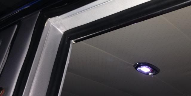

Interior light

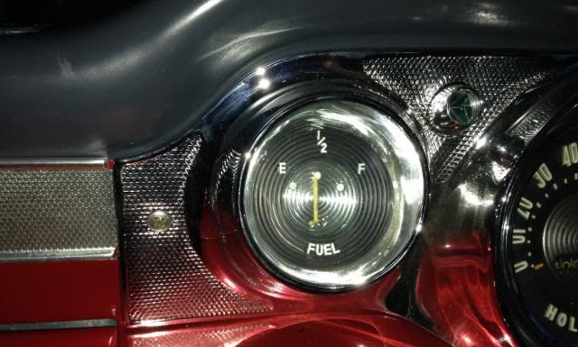

Fuel gauge now working, had the connections around the wrong way.

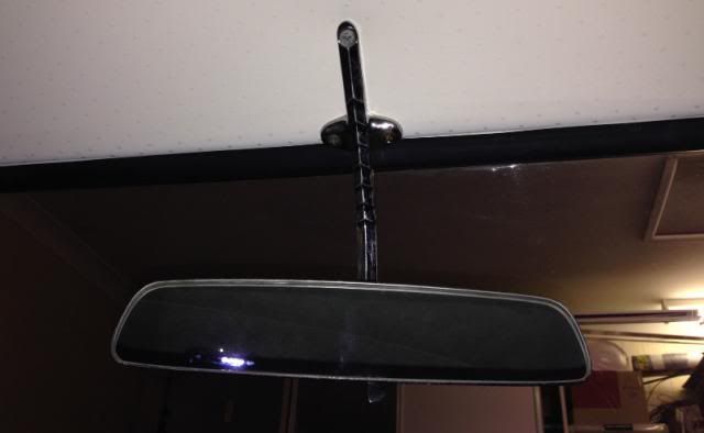

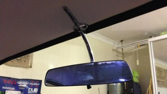

Rear vision mirror back on.
Actually kept the bracket but swapped the mirror for a night adjustable one.

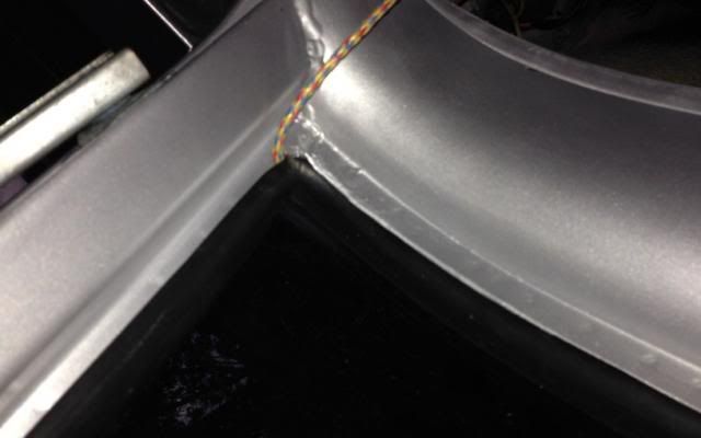

Left the car out in the sun (Yes Tim, I do listen sometimes)
And tried the windows again, but started at the sharp pointy corner.
Managed to damage one rubber but I'm sure I can glue it back together.
Both rear windows are in
, and I do NOT want to do it again.
