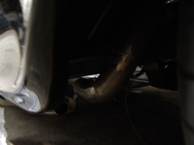

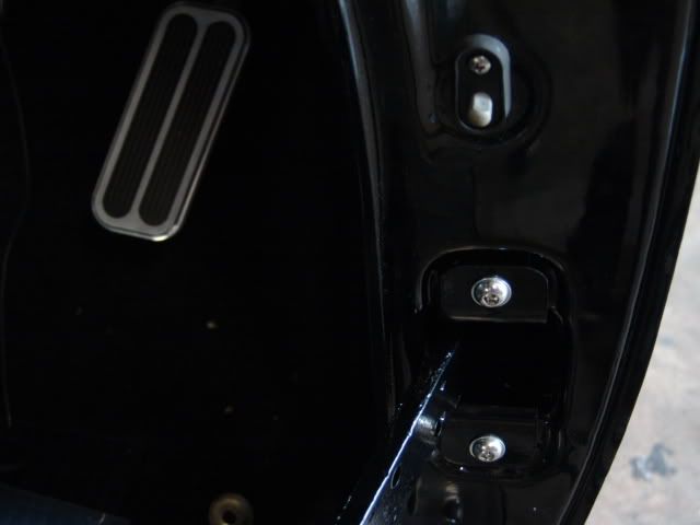

A lot of work going on but not much worth taking pics of. Here are a couple of the exhaust (from header flange to under the K frame) and the head lights are on (Aussie Dessert Cooler and thermo also in). Pic of the polished "Button head" S/S bolts that replace the old door hinge bolts.
First stage of exhaust from headers made up:
S/S button head bolts and the Commodore interior light switch (also fitted to back doors).
