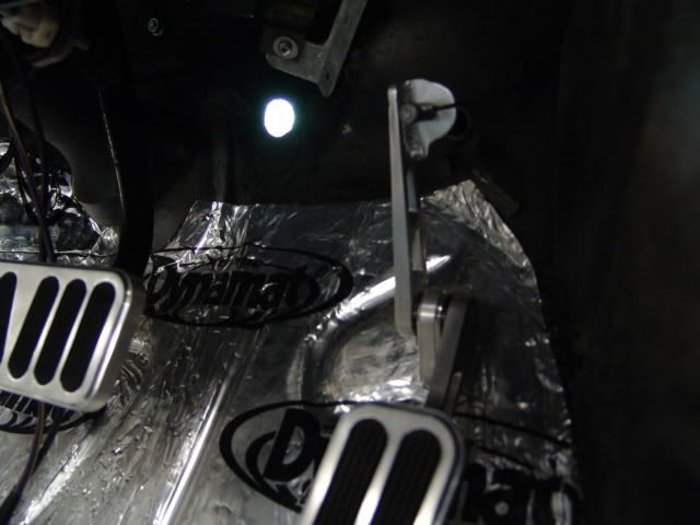

Here are a couple of updated pics. The acelerator is a billet "Lokar" unit, we welded some 3mm alloy plate on the side then shaped, drilled and slotted it to fit the standard VN throttle cable.
