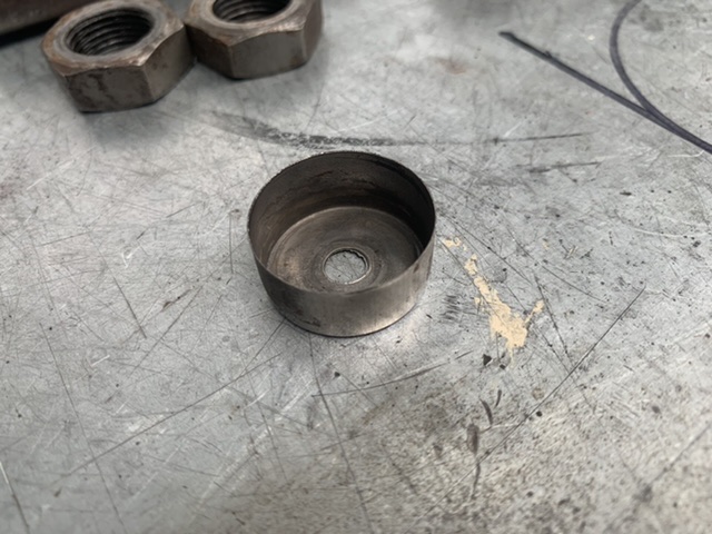

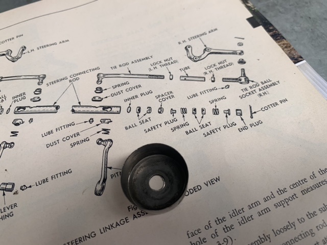

So I am sorting all the pieces for the steering linkage and I’ve got everything ready to go, just going to sand blast a few little bits in the cabinet and give it all a rattle spray with some etch primer and Matt black.
However ther is one small piece that I haven’t got for the linkage…
It’s called the ‘spacer cover’.
I have 1 good one (need a 2nd) out of 6 that I had access too, 5 were total mashed when I disassembled the spare parts linkages.
I have been thinking about the linkage and it seems the spacer cover may be more of a cover to hold grease in place under the ‘dust cover’
So the questions are-
Does anyone have a spare ‘spacer cover’ in good nick I could buy ?
Drew
ardiesse
Posts: 1204
Re: FB Standard Wagon
Post by ardiesse »
Drew,
The "spacer covers" all wear out. I reassembled my steering linkages without them.
FbSTDwagon
Posts: 790
Post by FbSTDwagon »
ardiesse wrote: Sun Dec 19, 2021 9:16 pm Drew,
No worries Rob, perfect answer!
I’ll go have a rebuild it without them.
I am guessing they are more to stop and grease pushing out of the linkage, so yes it’s not really a drama.
Thanks
Drew

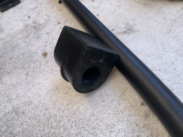

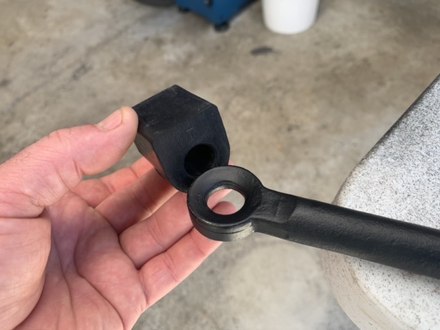

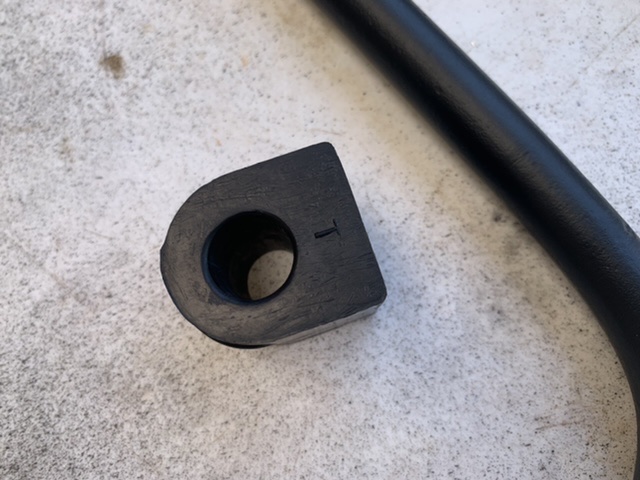

Haha the new sway bar rubbers are a bit of a mystery!
How you meant to fit these buggers???
Drew
Posts: 2697
That is funny !
Most of the new type sway bar rubbers are cut on one side so they open up and slip over the bar, to be honest I cant recall if the originals were like that or not ??
Posts: 14242
A new stanley blade will sort that little conundrum out in no time flat. :thumbsup:
