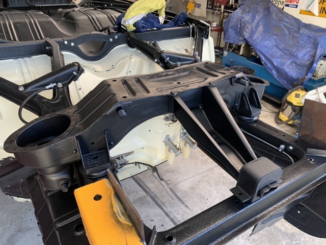

Next up is fitting is front end.
Dropped it in place with my brother yesterday and it’s sits in place well with new rare spares rubber.
However the front leg which mounts under the radiator has a big gap to fill.
Does this look normal?
I would have thought it should be sitting down closer more flush
My brother daughter to add a spacer to fill the gap but I’m looking for opinions on if it looks correct to you guys please.

Re: FB Standard Wagon
Nothing unusual Drew, as Brett says. Just bolt it up before you do the long bolts.
Great progress.
Drew,
The outrigger will only sit correctly in place when the four big bolts are installed and tight. The "top hat" rubbers have to compress a fair amount.
And: it's best if, on disassembly, you (had) marked the short and long tubular spacers so that they go back in their original positions. Both types of spacers come in different lengths. There's a long, long spacer; and a short, long spacer. The long, long spacer goes at the rear. The short spacers are used to set the amount of compression in the rubbers. See the workshop manual for the gory details, including the use of a micrometer depth gauge (as if your average mechanics' shop will have one of those . . .) You want to compress the front rubbers a bit more than the rear so that the outrigger tongue is centred in its rubber when the U-clamp is in place.
But you have machine tools, and can adjust spacer lengths to suit.
Hint: king-pin front suspensions like lots of positive caster. That happens when the outrigger tongue sits close to the front subframe tie member.
Hint: Assemble the control arms onto the the front crossmember before you put the front suspension in the car. And it's much easier to install the front springs when the engine and gearbox are in the car..
Like the others said mate, normal . Looking good
