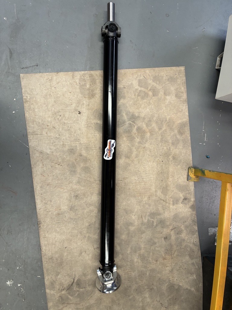

Decided to get a tailshaft made so that I can physically check alignment of gearbox and diff, then I can lock down the engine mounts and finish the gearbox mount.
Final drive have made my last two tailshafts so it was a no brainer to go back to them.
Image (1).jpeg (213.7 KiB) Viewed 3525 times

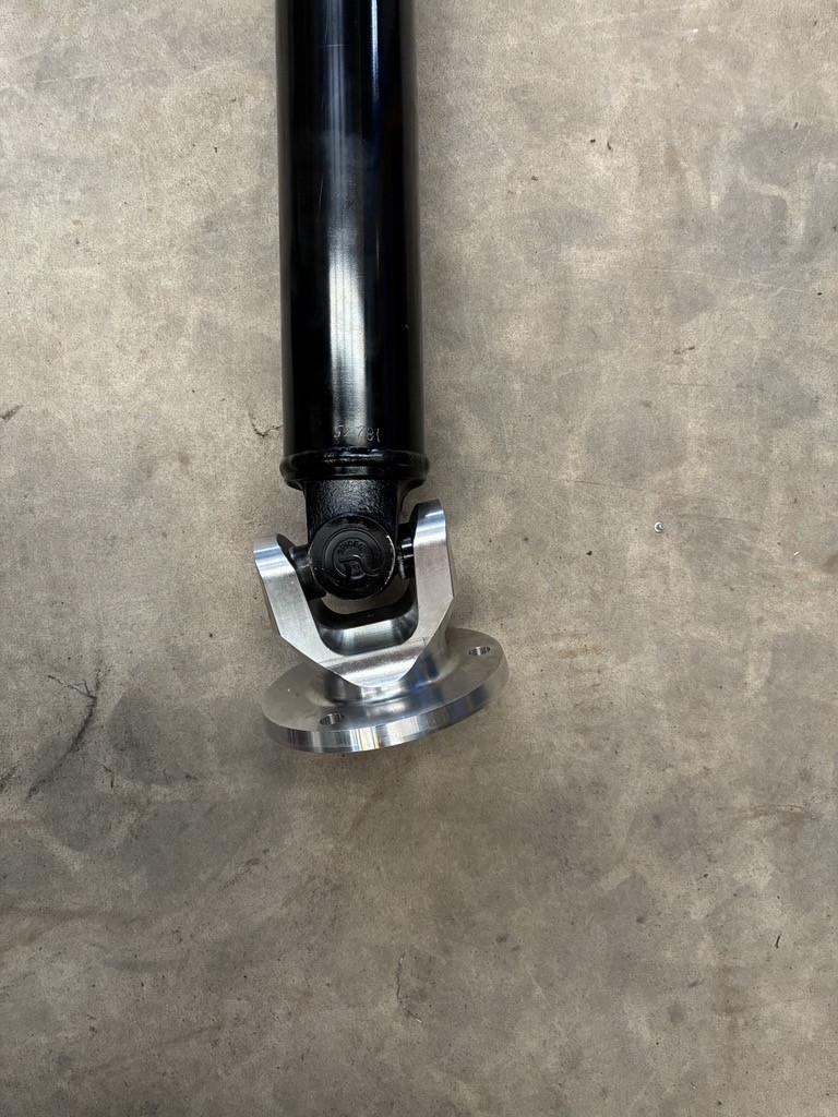

They provide an adapter at the diff end that eliminates the rubber donut that VE diffs use and gives you a Uni joint at both the diff and gearbox ends.
Image (2).jpeg (258.78 KiB) Viewed 3525 times
Not cheap but really great quality.

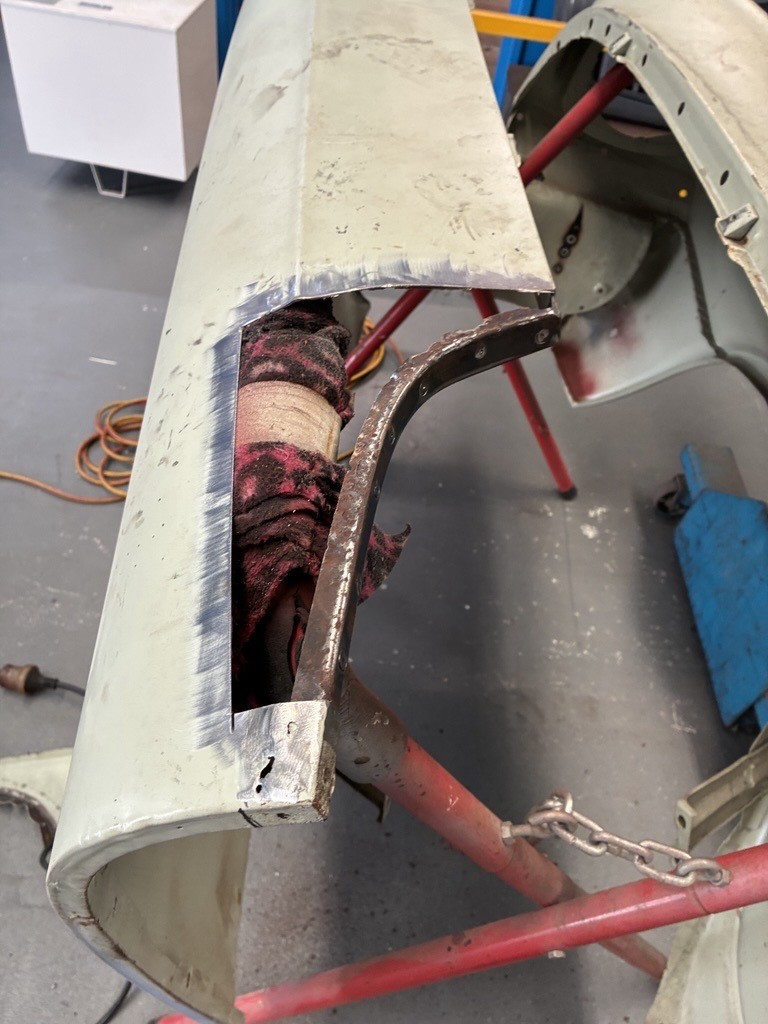

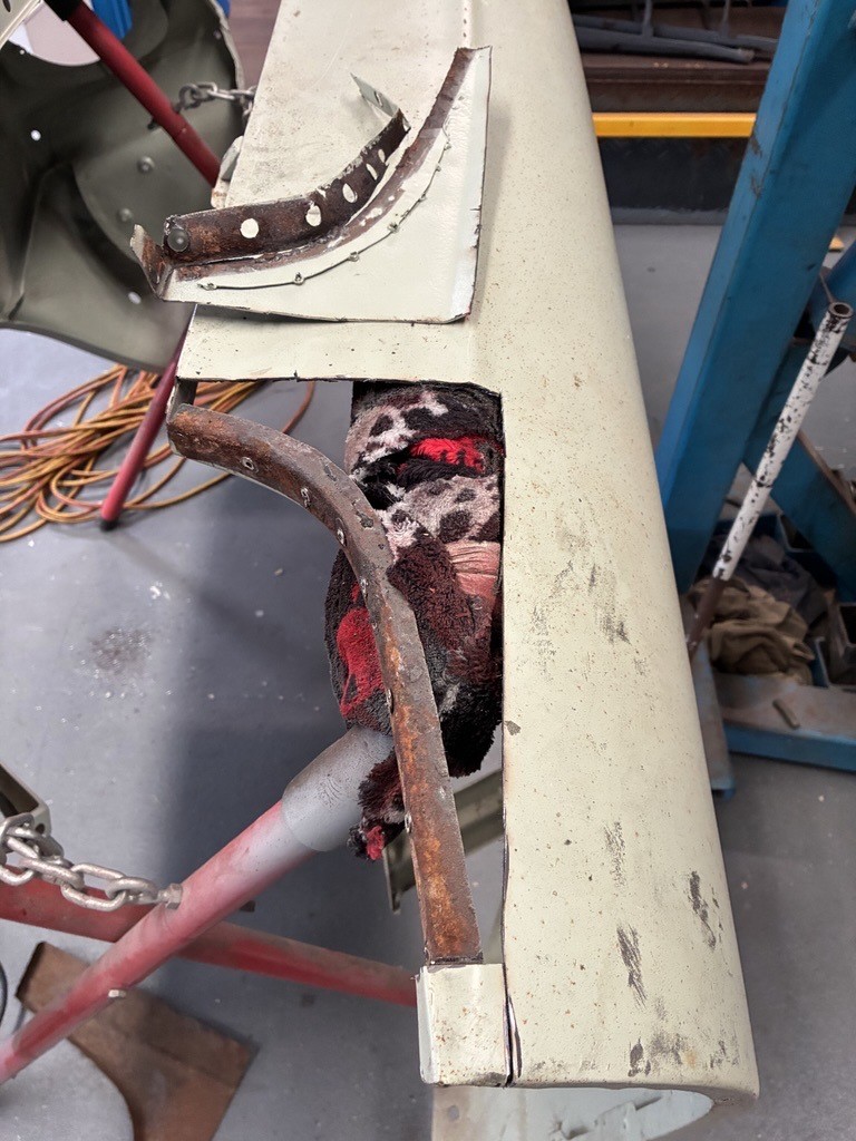

Have started work on the repairs on the guards, usual place
Image (1).jpeg (196.76 KiB) Viewed 3104 times
Image (2).jpeg (154.43 KiB) Viewed 3104 times
trying to make headway
Posts: 11686
Re: Neil's FB Station Wagon
Brings back nightmares, trying to get that crease along the top right. Very slightly convex.

FireKraka wrote: Tue May 19, 2026 3:03 pm Have started work on the repairs on the guards, usual place
I may have a patch panel for that Neil if you are interested. I had one for each guard, but used one on Wilma. Will have a look if you are keen.

Posts: 2828
Thanks for the offer Brett but I have a pair of old Taylors panels that have the sides as well as the top sections.
And yes it is hard to get the top line lined up properly that's why I didn't show the photo of the passenger side I tacked in, got it slightly out so am going to have to go back and cut again, oops :lol:

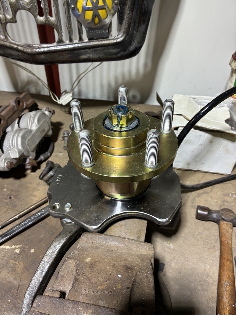

Finally received drop spindles and came up against the same issue I had with Frank.
Adapters fitted to stub axles.

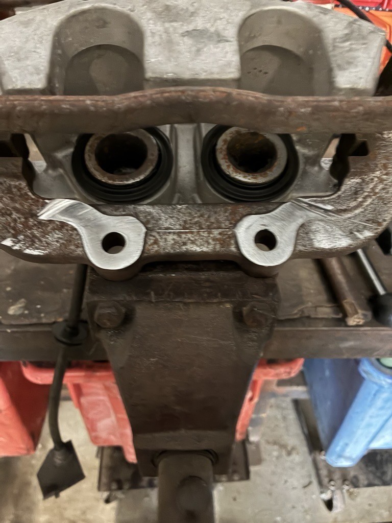

Ground clearance on the VT twin piston callipers

Good progress Neil, the adapters are a bit of a worry if they are supposed to suit that calliper.
