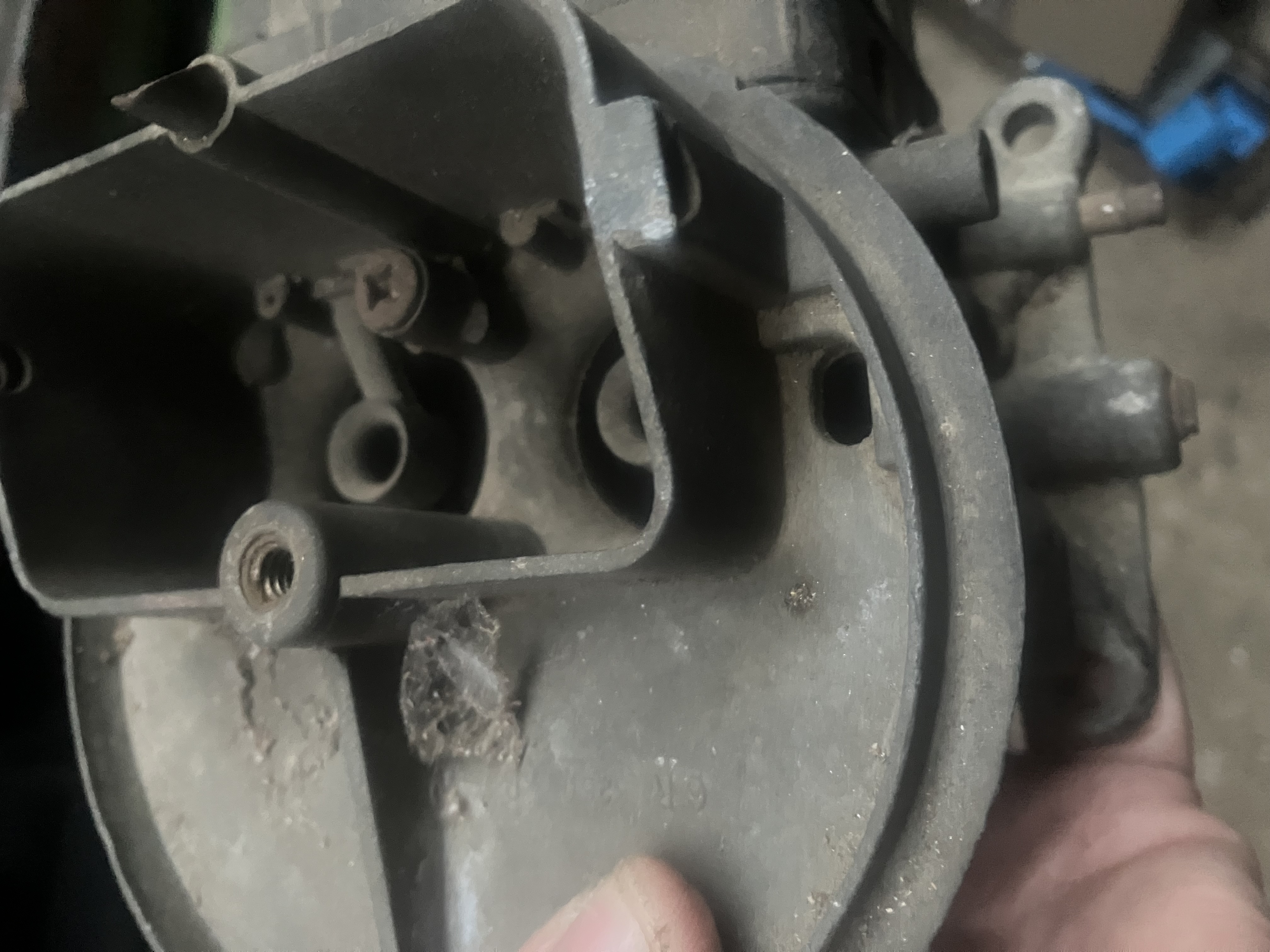

So far so good on the fast idle and choke butterfly install, without the carb requiring removal. Obviously there are more important things I should be focussing on such as camouflaging minor cracks in the marbled steering wheel and replacing a broken hand brake handle.
The butterfly actuating rod has to pass through a hole in the filter mounting plate, which currently is blanked off.Image
I was set to drill it out but looks like it could be removed by partly disassembling, which appears to require removal from the manifold. Can anyone advise?

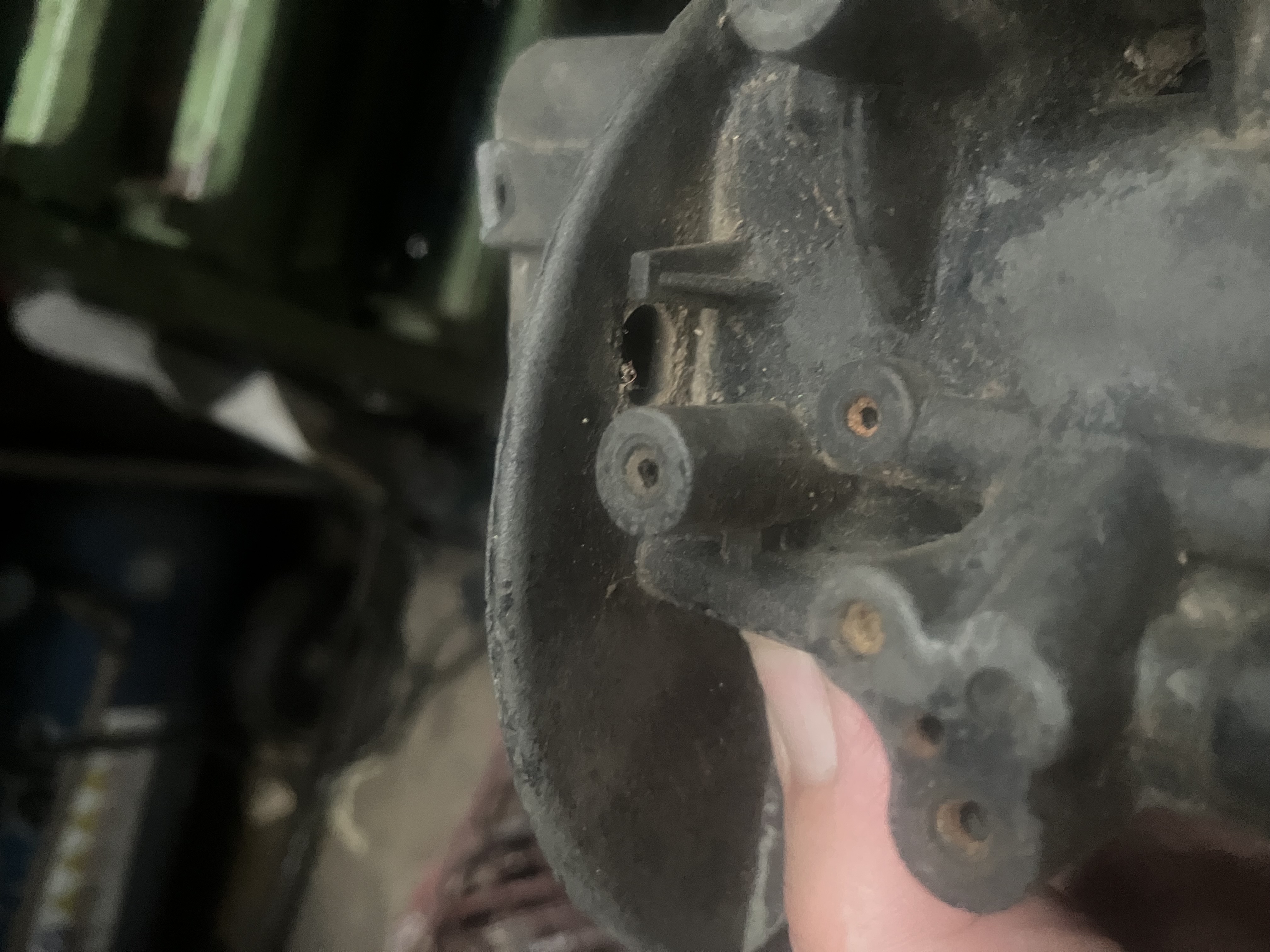

bottom photo is as useful as a third armpit - the first pic it looks like there is a coin epoxied under it ????
Posts: 5732
Re: Elle’s 1960 FB 225 mild custom
It’s an oval shaped hole, and agree with blacky that yours look likes an araldighted disk. Mebbe try tapping gently (SFH) from above with a drift.
Posts: 11633
Thanks fellas. I thought to try a drift. Camera doesn’t like to focus so close but it does show the shape.

Errol62 wrote: Tue Dec 17, 2024 8:08 pm
Blanked off with coins?
