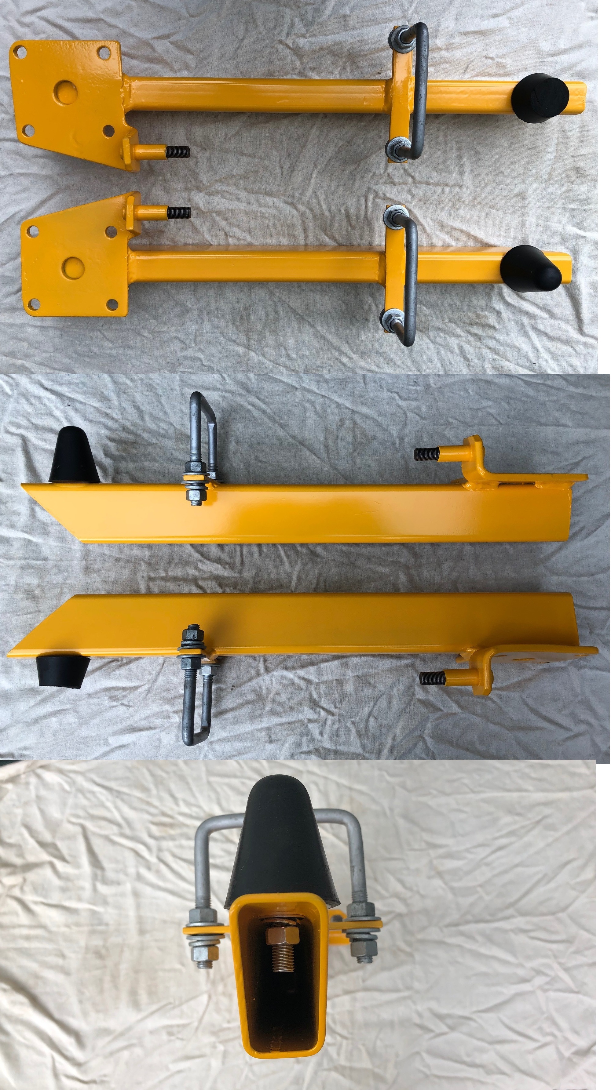

Traction bars welded out and painted in "Oh My Goodness That's Yellow!".
Traction bars 3.jpg (2.33 MiB) Viewed 11383 times
Need to finish bleeding out the brakes on the FB (for the whopper stopper Mitsi discs) then will fit the traction bars up.

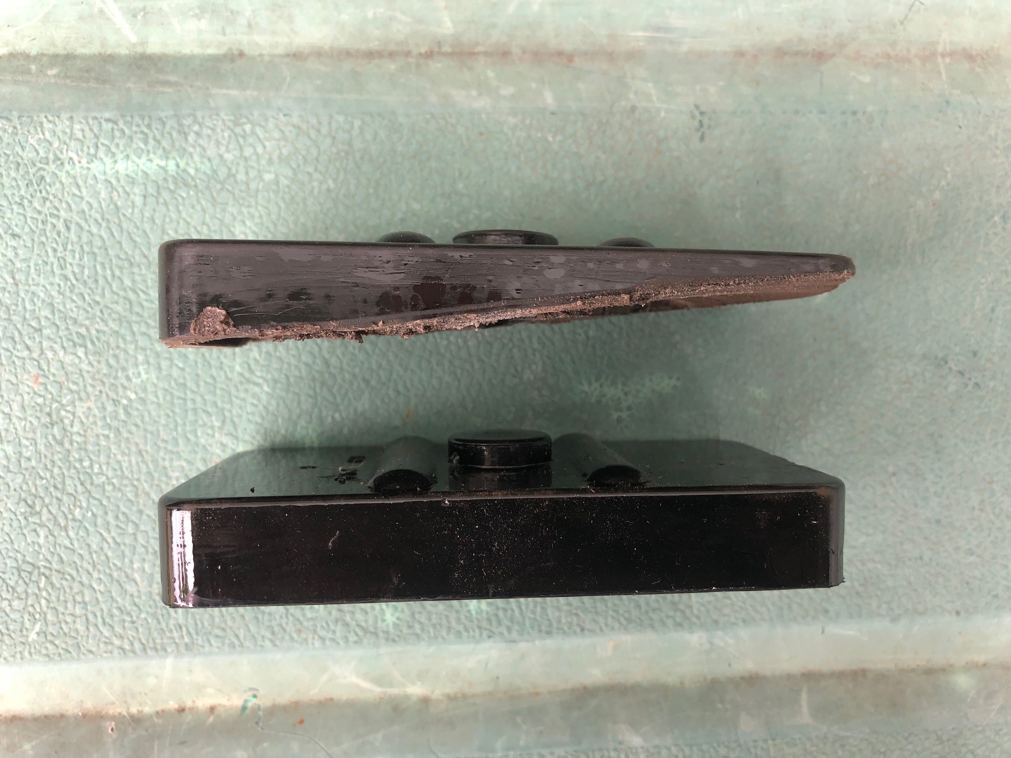

Got one side of the bars installed yesterday. A little butchery with the hacking-saw and some deft touches with the bench grinder, and voila! Nolathane wedge.

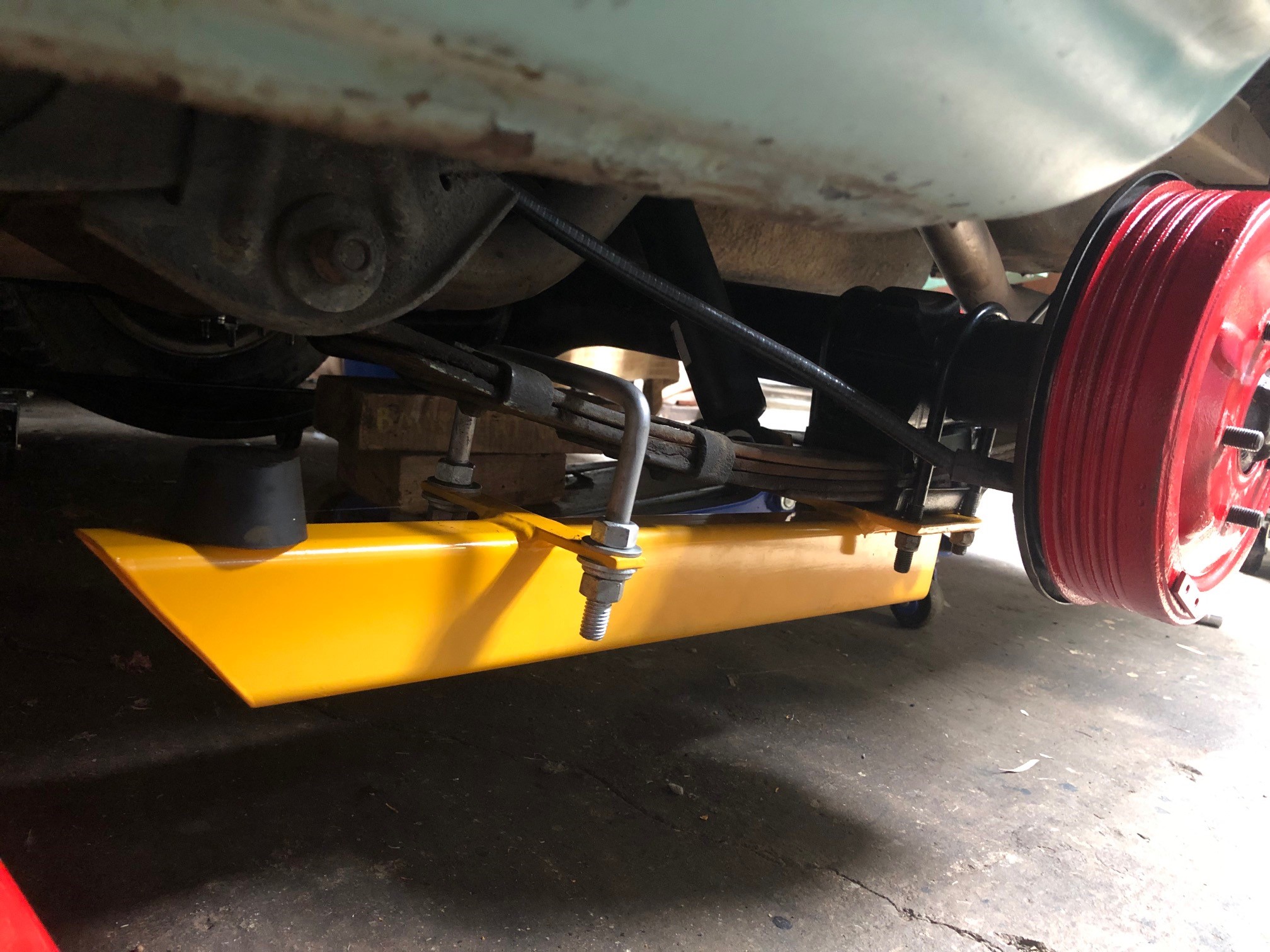

traction bar installed 1.jpg (526.69 KiB) Viewed 11353 times

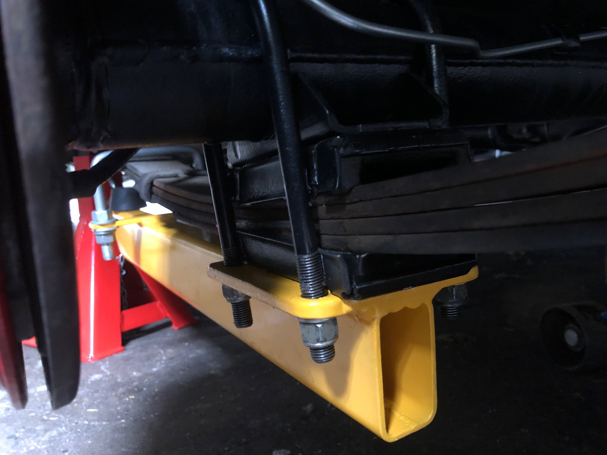

traction bar installed 2.jpg (492.06 KiB) Viewed 11353 times
traction bar installed 3.jpg (542.35 KiB) Viewed 11353 times

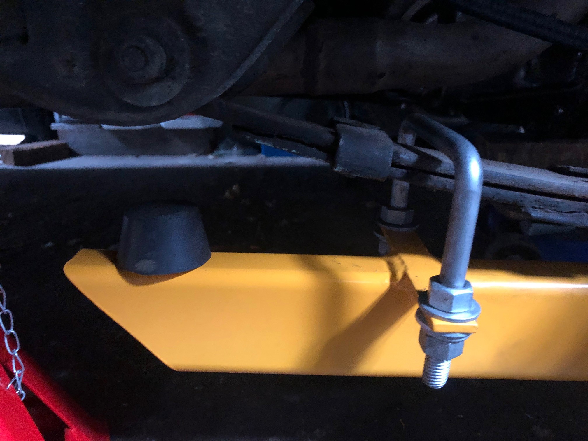

The photos show the suspension unloaded - big gap between the snubber and the front spring eye, and the u-bolt propping the nose of the traction bar up. With the wheel back on and the car on the deck, the suspension squats. Nice clearance on the u-bolt, and about 1/8" gap on the snubber. Noice.
