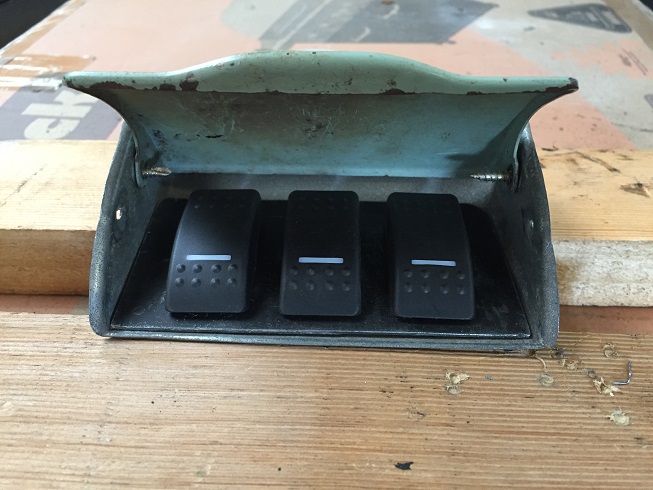

Replacing the switches on the dash with the gauges shown previously and adding 3 rocker switches into the ashtray, wipers – heater and driving lights.
I have not had the switches engraved yet but likely to be in modern style.
Temp set up for photo only, lots of filing and sanding to go.
Ashtray 2.JPG (111.57 KiB) Viewed 927 times

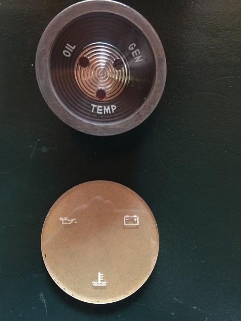

Changing the face of the red tell tail lights to a modern look. The red light will still working injunction with the gauges.
telltail 1.JPG (91.04 KiB) Viewed 927 times
telltail 2.JPG (95.79 KiB) Viewed 927 times
I have not found the correct cone / dish to shape these yet but will careful heat in the oven and press into shape.
I had a couple of test pieces to practice on

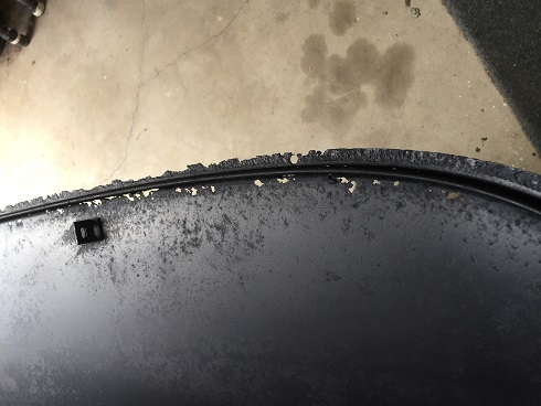

Pickup he sunvisor this morning from paint strippers, Minus Paint here in Adelaide.
As I suspected under the bog was rust holes.
sun visor 1.JPG (61.23 KiB) Viewed 834 times
sun visor 2.JPG (100.9 KiB) Viewed 834 times
Any suggestion on how to go about fixing this ?

I got a repro one from Auto cables retro spares Eltham Vic. Doesn't use the roof brackets so no need to drill holes in your roof. Welcome to have a look at it of course.

Thanks Clay for the lead.
I may repair this one by replacing the rusted area with a strip of metal or bronze weld then file to shape.
I have the metalised filler that could work as this set like rock.
plenty to do before I need a sunvisor.
