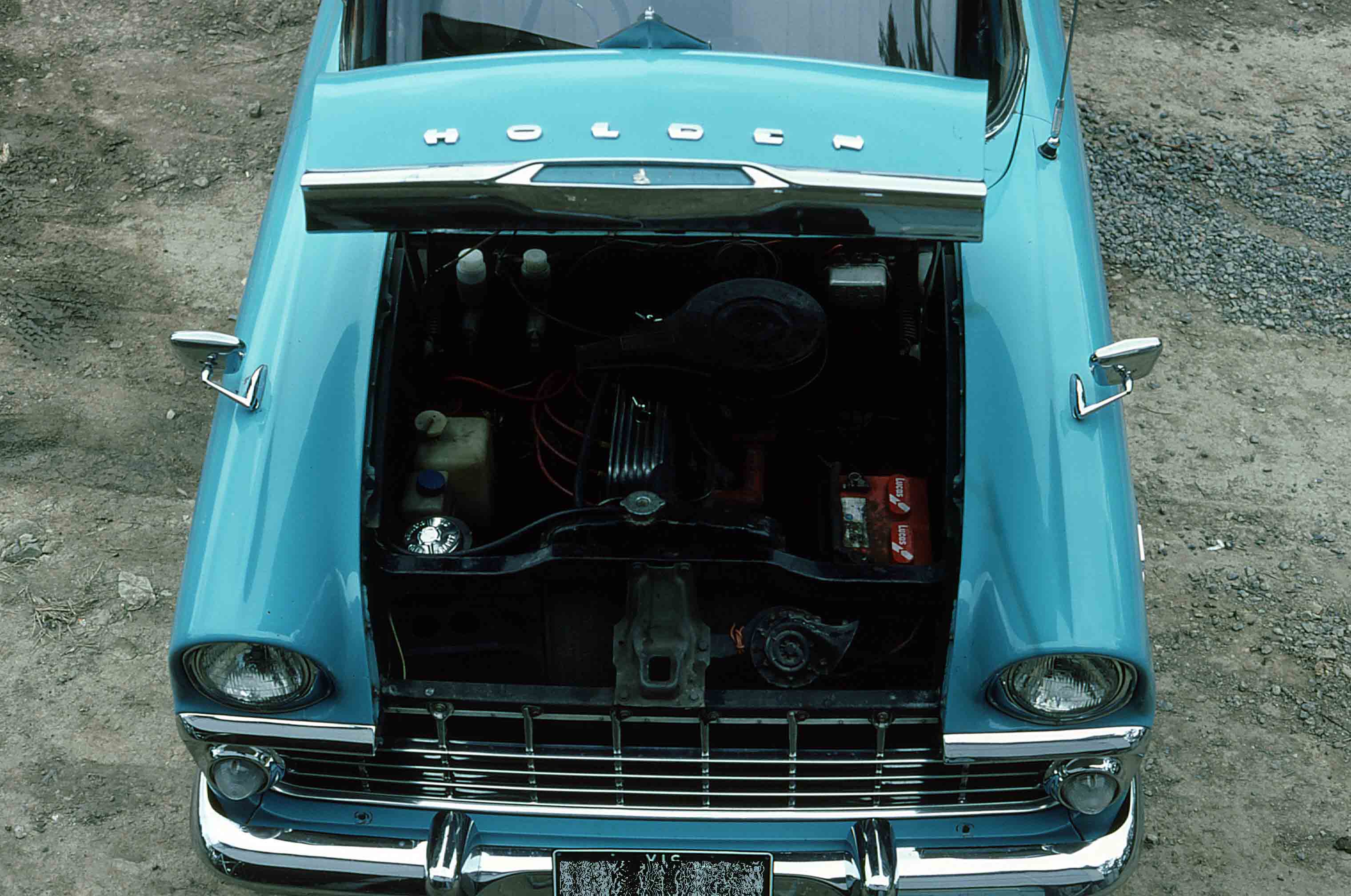

So, here is the very last pic I took of the old girl complete with the original subframe and a grey motor - albeit the second one.
We can see at left in this pic, the Frantz oil filter, the radiator overflow bottle and a windscreen washer bottle. My log book reveals that the alloy rocker cover came from "The Old Tin Shed" at the top of either Elizabeth or Swanston St, Melbourne on 10th January, 1973 for the princely sum of $11.50..... I fitted this to the original motor to stop oil leaking out of the "buckled" steel rocker cover - I did not know that winding down on the two nuts too far would cause permanent buckling... with the alloy, I could wind down to my heart's content... and each gasket lasted about three adjustments of the tappets... pic.....

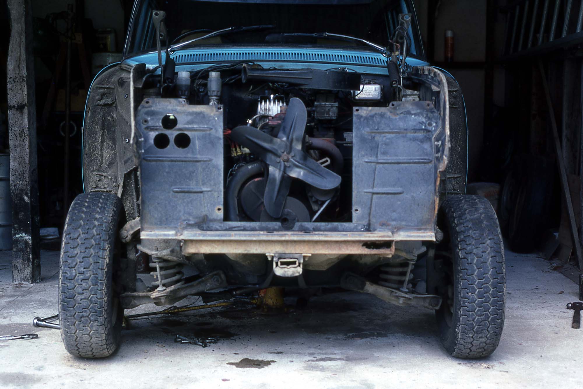

In this pic, we can see how untidy beneath the bonnet was.. the motor was very tired, my wiring left almost everything to be desired and as far as keeping it clean - the layers of crud and oil probably resulted in much less damage occurring to the firewall and subframe mounts than would otherwise have resulted.... We also see the two holes in the stone-tray where those "pesky" fog lights were once mounted....
For those with very keen eyesight, we can see the aluminium strip running along the lower edge of the bottom radiator baffle cross-brace - I became an advocate for the fitting of insect and stone screening... my first attempt was to fit aluminium fly wire mesh.... it served the purpose, and was concealed behind the shiny stainless of the grille...... we'll get to what I now use, but this is not to come for another 21 years....... pic

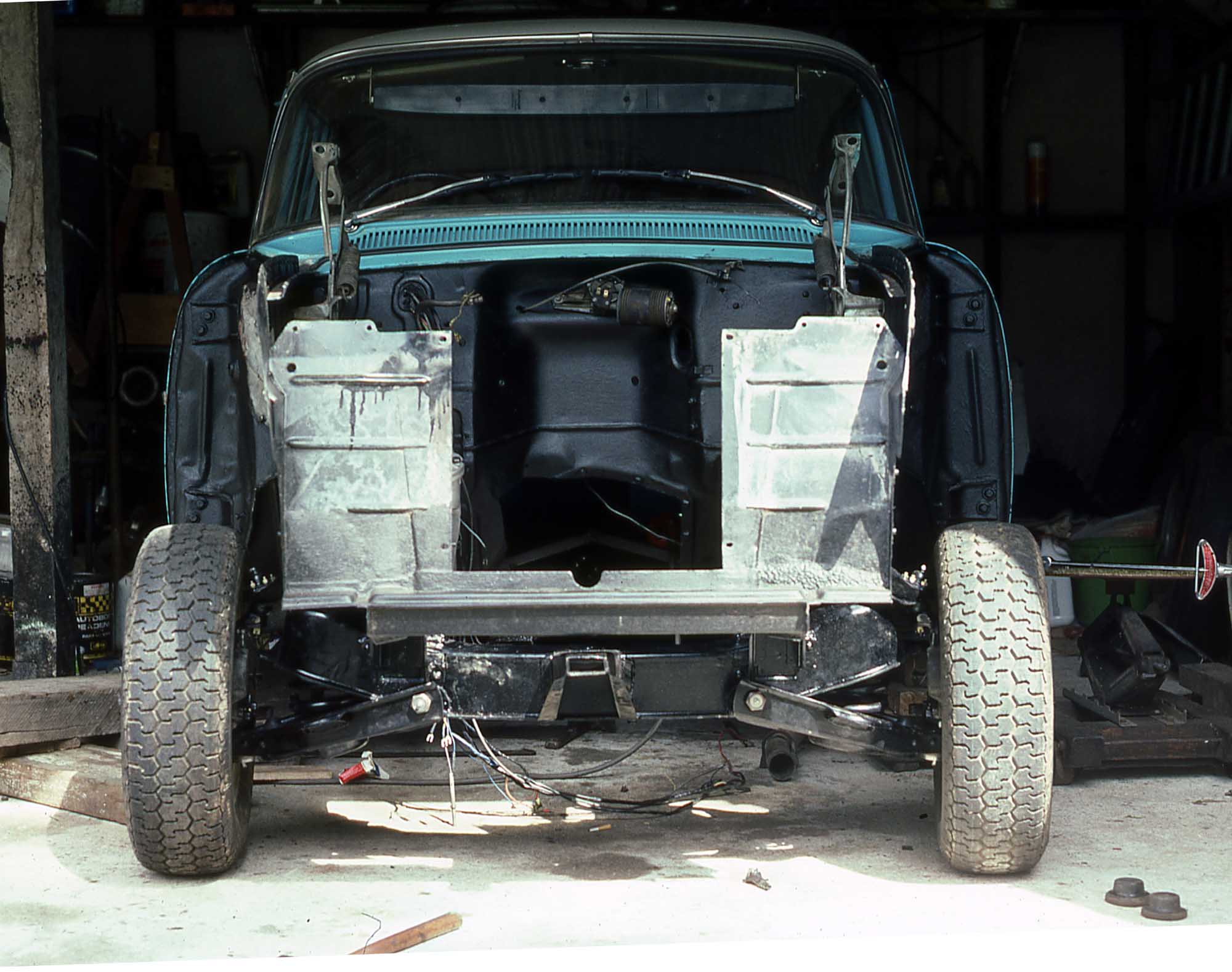

I did not take "disassembly" pix... but did capture one last look at the damaged sub-frame and the last grey motor ever to have lived in this amazing old car....
What you can see in this pic, are the three holes cut for air cooling to the Frantz filter - I did not cut these in the replacement.

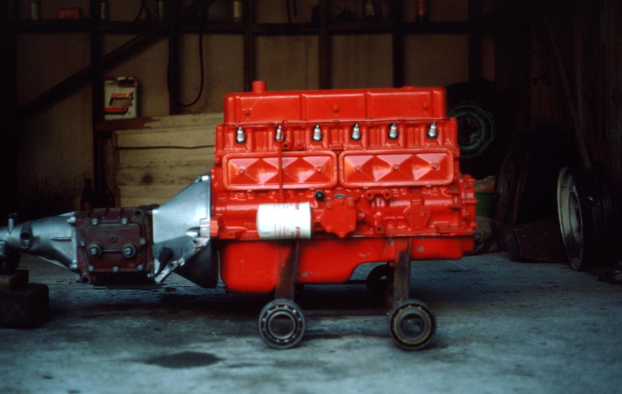

I purchased a change-over 179 HP block motor number M 163520 from GEM, Sydney through "Ram Automotive" in Dandenong, Noel Belford for $410.00 plus $8.00 for the harmonic balancer. With the plugs removed, I could clearly see ".060" on the crowns of the pistons... believing these to be oversize of the 179 ones.... making it a 186 sized engine -
(This was wrong.. and I only found out in 2008 when completely stripped this motor of every piece to find a mysterious rattle (still have it)...
I Measured the size of the pistons - and found out that in fact.. the "060" over size was that in excess of standard 186 pistons.. so, we had a 192 cu. in motor... tell you more about this once we get the car mobile - wow! was it a rocket.)

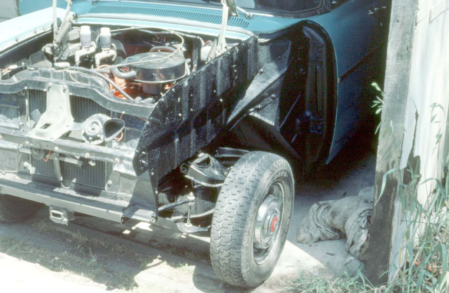

On 23rd October - ignorant of what was to eventuate, I painted the shroud, outer and inner front floor with three coats of "3M Auto Body Deadener and Sealer" - this was the second huge mistake I made apart from the modification... that blasted stuff trapped moisture in under it - it took me over 10 years to finally get rid of it... and repair the resultant damage....
Once it dried the sub frame was attached to the body.

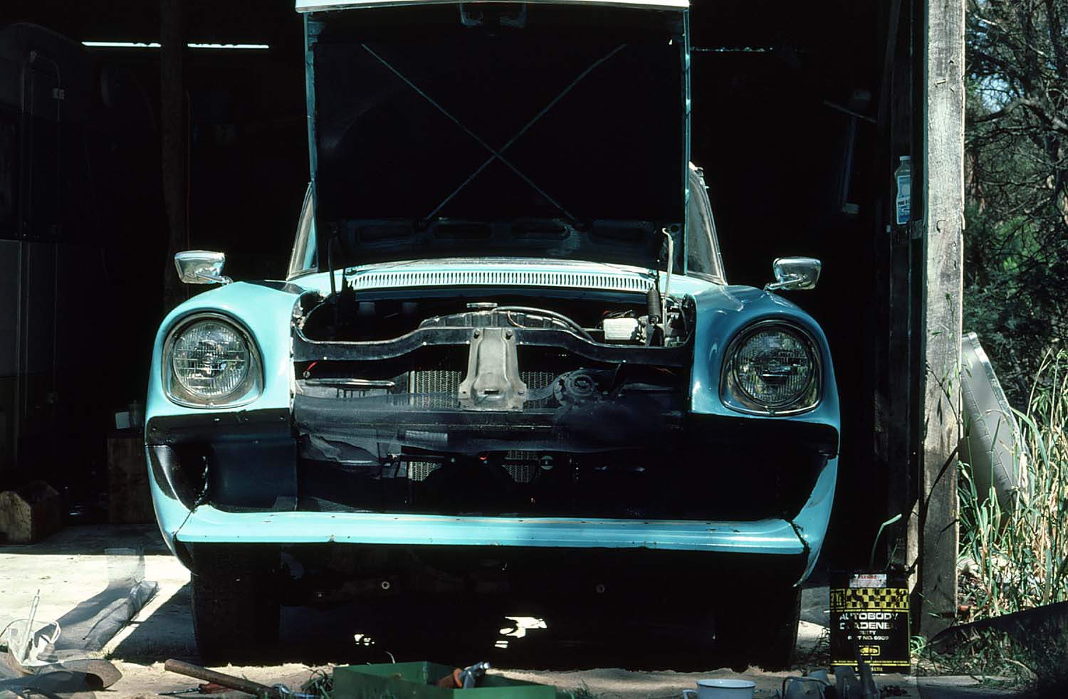

I took this pic - clearly showing the issues I was having with the height of the cross-member/sub-frame heights..
We can see the RS-1 having done its stuff to the front of the radiator baffle... I was happy with the hard coating it provided... yet foolishly later painted that deadly deadener over it...

A pic of the assembly sitting on a rolling frame ready to be picked up using block and tackle...
With the Odo showing 152,250.5. With the assistance of my father on the block and tackle, and my younger brother-in-law apprentice - we attempted to fit the engine and gearbox assembly to the engine compartment.

A couple of pix to break this up... scan quality of these two is shocking - but it clearly shows the "red" in and mounted in its own right.
I'm probably jumping ahead a bit by placing these pix here... this was exactly as the re-build had proceeded when the vehicle was road tested for the first time..... there weren't any front seats in it.... we "piled" up blankets to sit on top of the "mound" of the floor.... it certainly was a weird experience... and the noise!... for anyone who has yet to drive one of these old buses without the transmission floor cover in place - you simply won't believe your ears!
In these pix, we can see that the Davies-Craig thermatic fan has been fitted. We are still running the original type radiator and we are running with a generator and regulator.... all this gets changed later as problem after problem begin to sour the mission.

More and more of the parts started to go back on. I had concerns about the thermo fan driving anything into the radiator - so fitted some aluminium flyscreen behind the grille...
In this last pic, as we bring this chapter to a close - we can see one of the many 5 litre drums of 3M body deadener... it would take me decades to get rid of that stuff from everywhere I had plastered it on...
Before being able to start the motor - the rear axle had to be swapped out and an EH housing fitted, with a 3:55 coarse spline diff centre.

I was still in the process of painting that blasted body deadener onto everything.. and got impatient in the wait.
On 5th November, I grabbed my apprentice and we fitted some blankets onto the floor.... got ourselves comfortable and decided to go out onto the road to the top of the hill and back.
The floor still had its huge hole over the gearbox and it was only the subframe in the above pix which were the front of the car...
