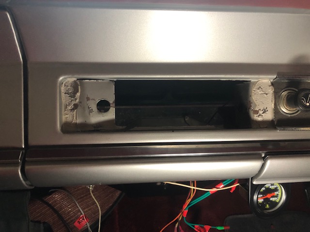

Power supply for the new radio had to be re-run, as the old radio was wired "always on", rather than "only on with the ignition"... old power leads had multiple twist-the-wire joins covered in cellotape. When I pulled the old radio out, this mess was waiting for me:
Radio slot butchered.JPG (65.29 KiB) Viewed 9115 times
The radio slot has been cut top and bottom, and two "ears" folded back. The photo shows one "ear", complete with round radio knob hole, bent back to where it should be. Bent both back into place, and put the new radio in:
